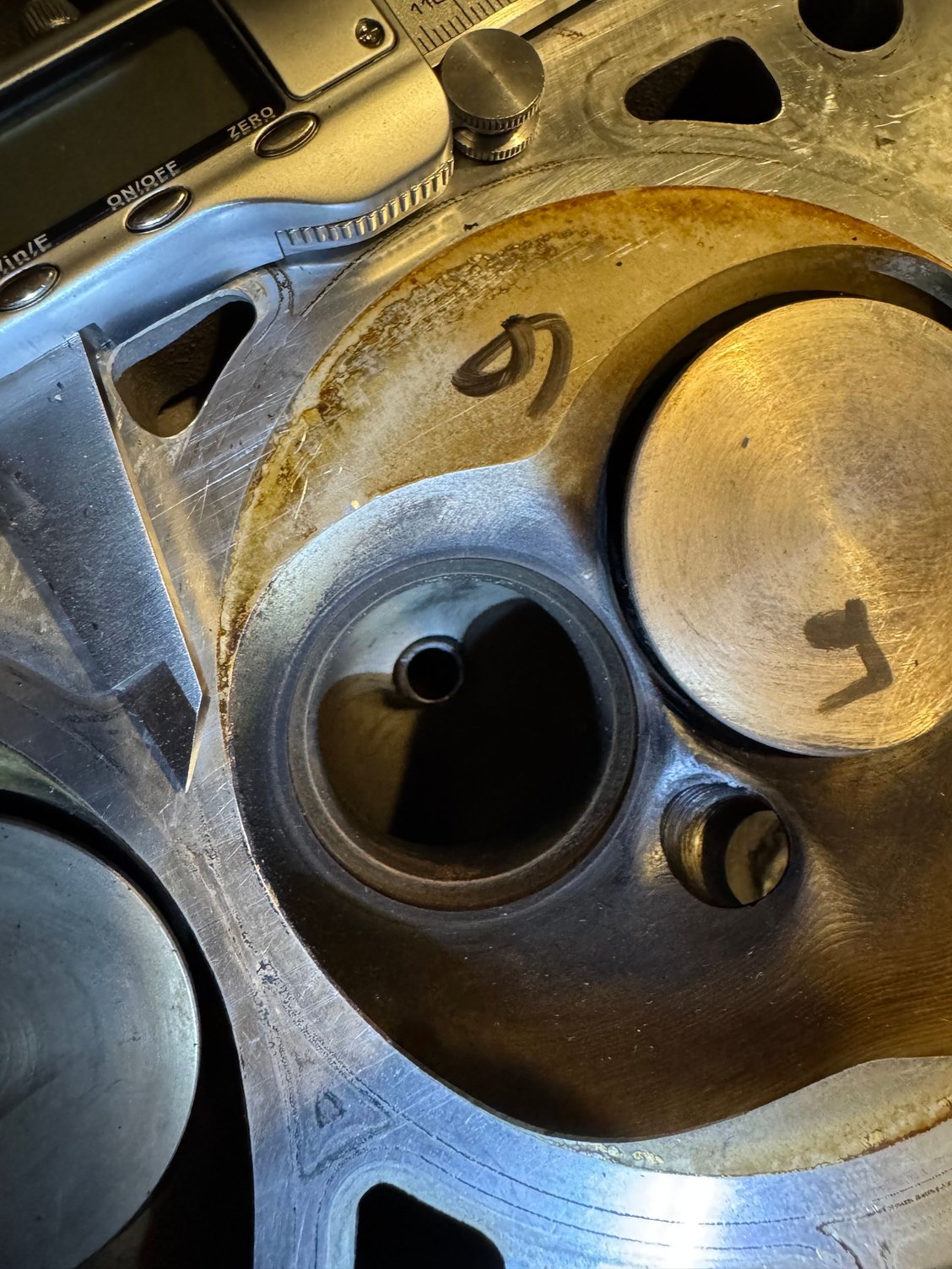

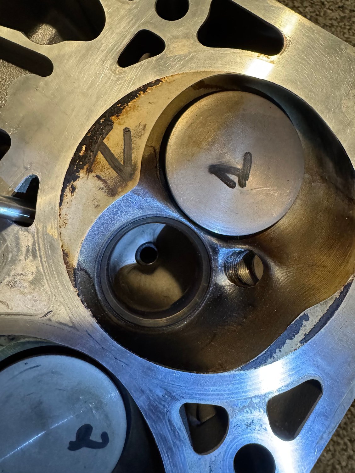

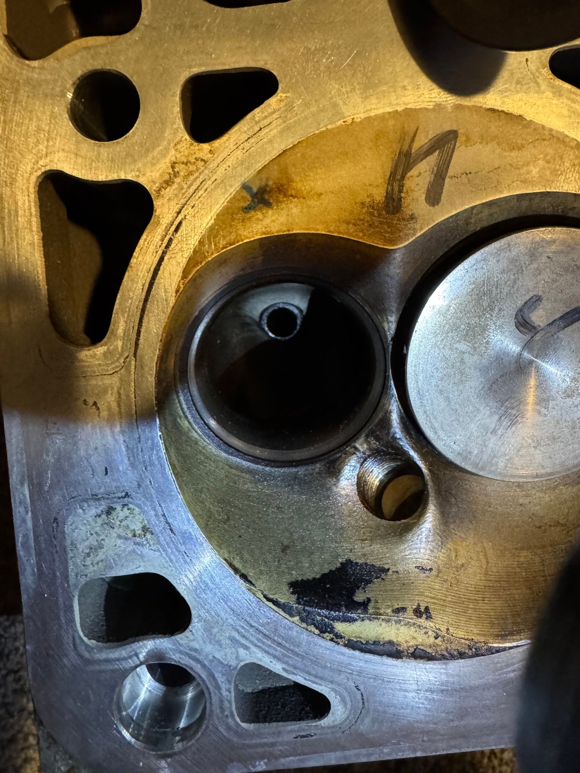

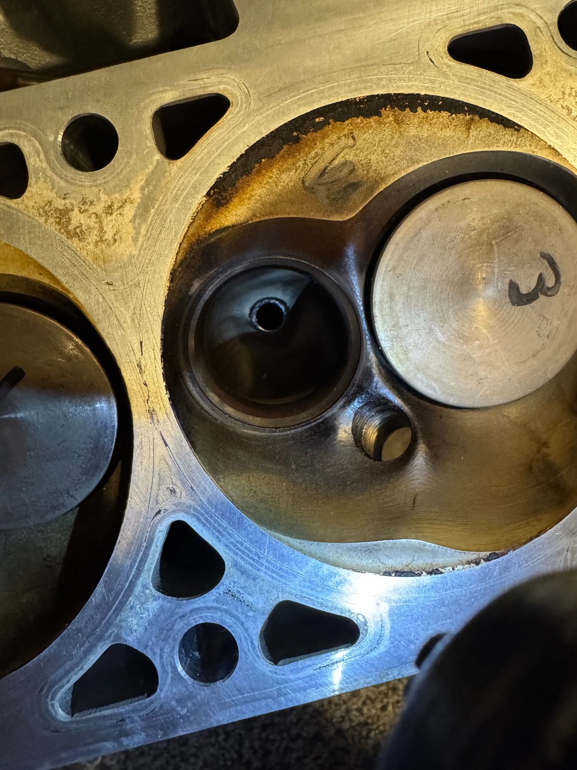

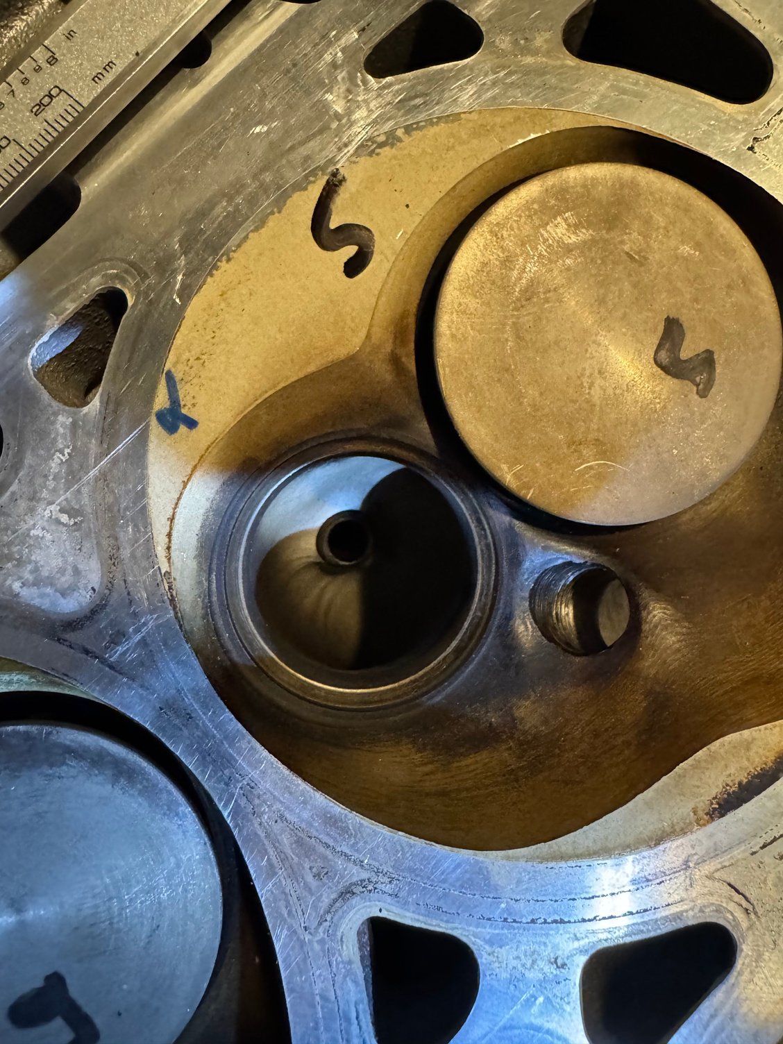

Man that sucks after that whole job you lost the motor. The valves measure out width wise intakes seem ok. When I put them in the drill spin them in the guide or just openly and check? Because it’s hard to tell by looking in the air. Also what is the correct way to measure the seats?

It does look like in your pics like you have valve seats that have settled…which is perfectly normal for aftermarket heads btw. Heat cycling and the thermal dissimilarity between the seat material and the aluminum casting sometimes causes the seats to sink, particularly the exhaust seats because they see much more temp. It’s not a guarantee that this is going to happen, but it does happen. Your heads are very repairable.

I can see what you mean by the seats sinking in. But shouldn’t that be on trickflow man? Like I’m still scratching my head here on what the hell I did wrong lol. Spun them all on a couple there is a tiny variance hard to tell by the eye. To me they should all be lined up from the start yes 10 thou whatever. But now it’s like ok spent 2800$ plus on heads oh we don’t know what happened push the blame my way when you read up on high EGTS could be caused by the exhausts not seating correctly from the start which in return caused them to run hot. Trickflows very redundant in their responses to me. Who knows what happened but at the end of the day I think in good faith they should have fixed the heads. He’ll even if they said we don’t know what caused it could of been us or you but we need around 500$ to cover some costs I would of said whatever I just want good cylinder heads. It’s when they said you burnt them up it’s $1400 the cost of more than one head to get them sent back to you is when I said send them back that’s outrageous.

I still would liked to have seen the valve seats after being cleaned and if you chuck a bent valve up in a drill and give it a spin you going to see it. A few thou isn't going to make up the difference in the valve heights not being equal as those look to be .020-.030 thou difference.

Ok I’ll get them cleaned up more take some pics they all just look sunken in. I’ll try to post a vid of valve in drill

So those are all the seats don’t have much brake clean here I’d have to take them back to garage at this point I’m pretty much done cut my losses. not sure what conclusion to draw besides trickflow heads at the end of the day did let me down.
