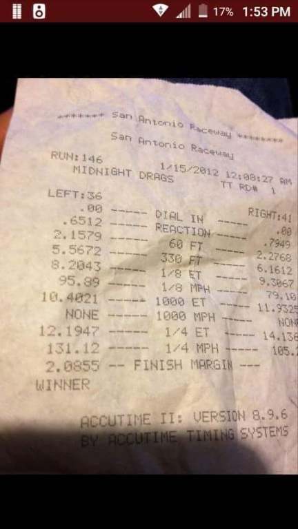

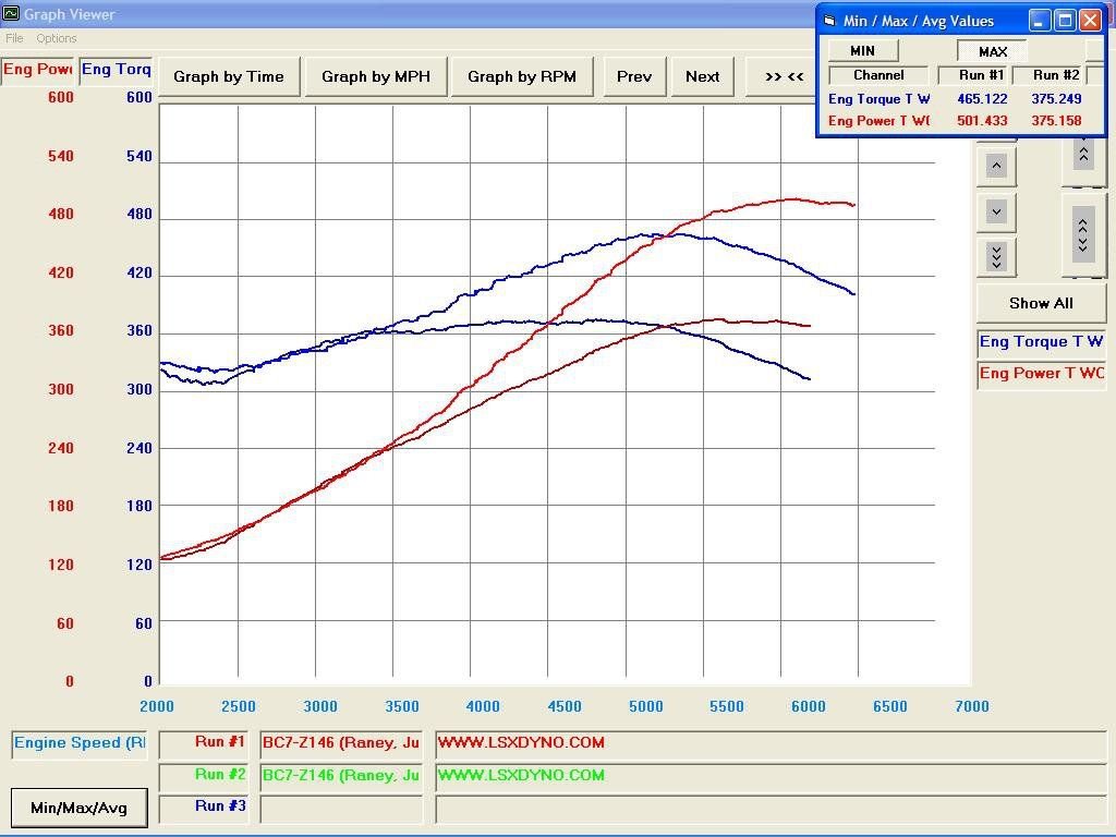

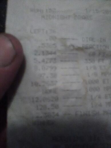

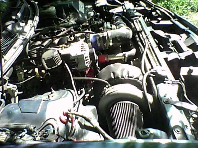

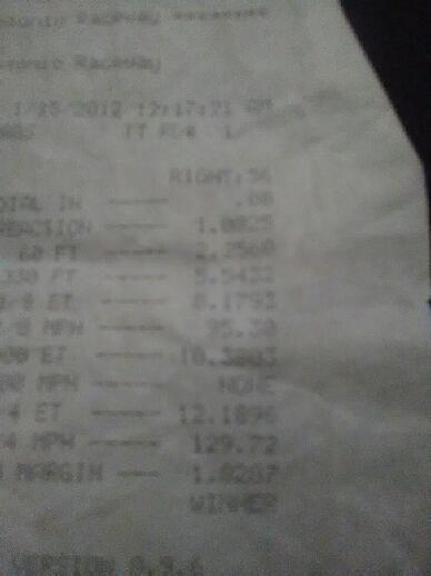

lol what size? I wanted to keep stock heads? Ive already had a stock 98 z28 i put small bullit cam, ud pulley, hooker headers 375whp tq and 114-116mph and a s475 turbo 6lbs made 501whp 465wtq on mustang dyno. With 9lbs in 40 degrees midnite weather ran 128-131mph stock longblock except cam and springs.
Looking for a cam only type of mods. Theres my ets from 2012
