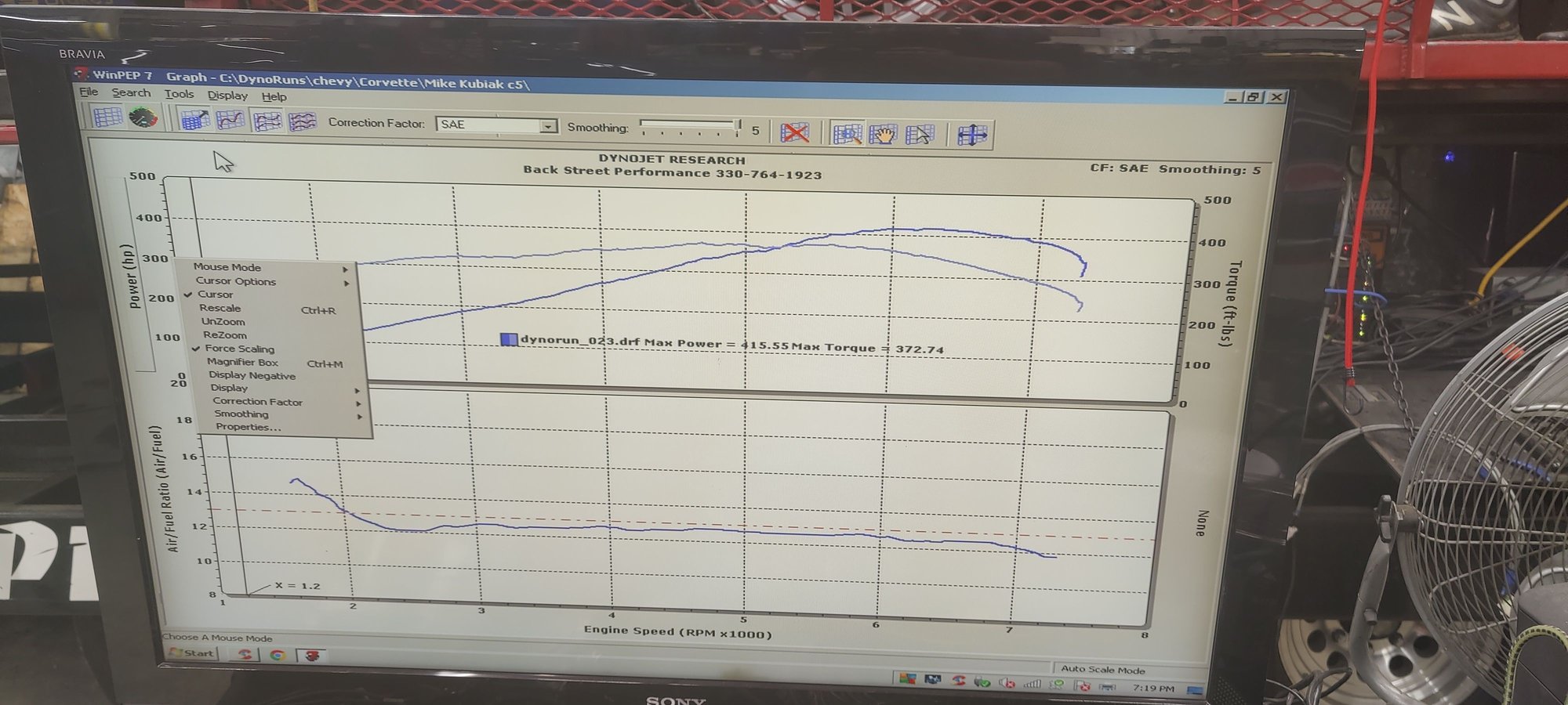

Originally Posted by Kubs
My c5 Z06 LS6 makes 415whp with just headers, LS9 cam, and FAST102/90mmTB. Before the LS9 cam I was 394whp.
With ported heads and a little more compression you should be even higher I would bet. Your cam is similar in @0.050 duration, but more lift and tighter LSA. The LS9 cam killed any bottom end I had with the stock LS6 cam so I think yours will make better power across more RPM as well.
Do you have to have the dyno graphs before and after the ls9 cam?
Old Nov 7, 2025 | 09:44 AM
  #48
Kubs's Avatar
Joined: Sep 2009
Posts: 104
Likes: 51
From: Akron, OH
Not on the same graph unfortunately.
This first photo shows the stock setup with a tune. Then when I added headers and the intake/TB.
This is after the LS9 cam. You can see the power is more "peaky" and I lost like 16ft-lbs.
