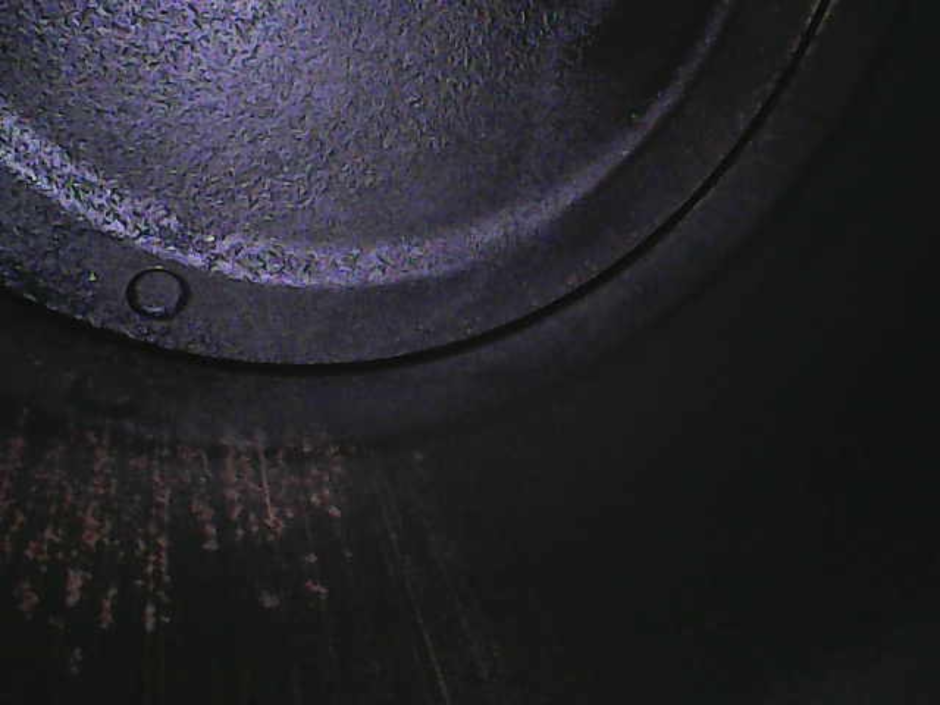

I snagged a super cheap borescope from Amazon that showed up first thing this morning, and it looks like indeed my engine is an LQ4 with dished pistons. Also looks like there is a little surface rust on the piston wall, and it's unclear to me if there may be an issue with the pistons themselves, or if that is just soot buildup.
Either way, looks like my best path is to swap with 307 heads, so since the heads are coming off it will let me get a better look.

Those cylinder walls dont look terrible to me. Less than perfect, but it probably just hasnt been run in a little while. It will clean up.

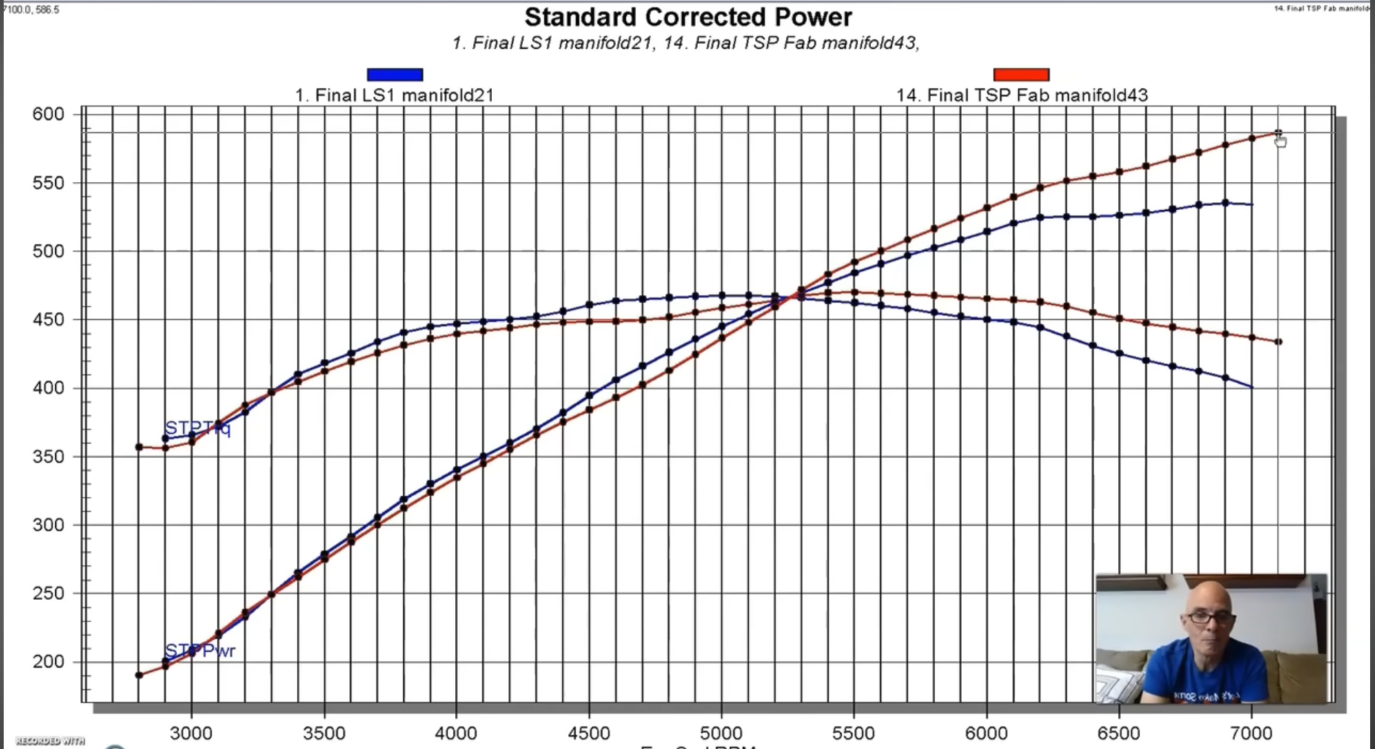

I wish I saw more dyno numbers on short vs long runner intakes. I've seen the videos by RH, and podcasts, etc. and I realize that short runners are not ideal. That said, they are available everywhere and generally for cheap.
I saw the intake test that RH did, and it looks like the fabricated didn't really lose much power vs the LS1 (In get it's the worst of all intakes). It looks like over the lower power band it loses maybe 20hp/ft-lbs. Like if so, easy decision.

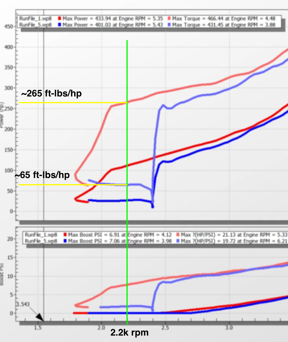

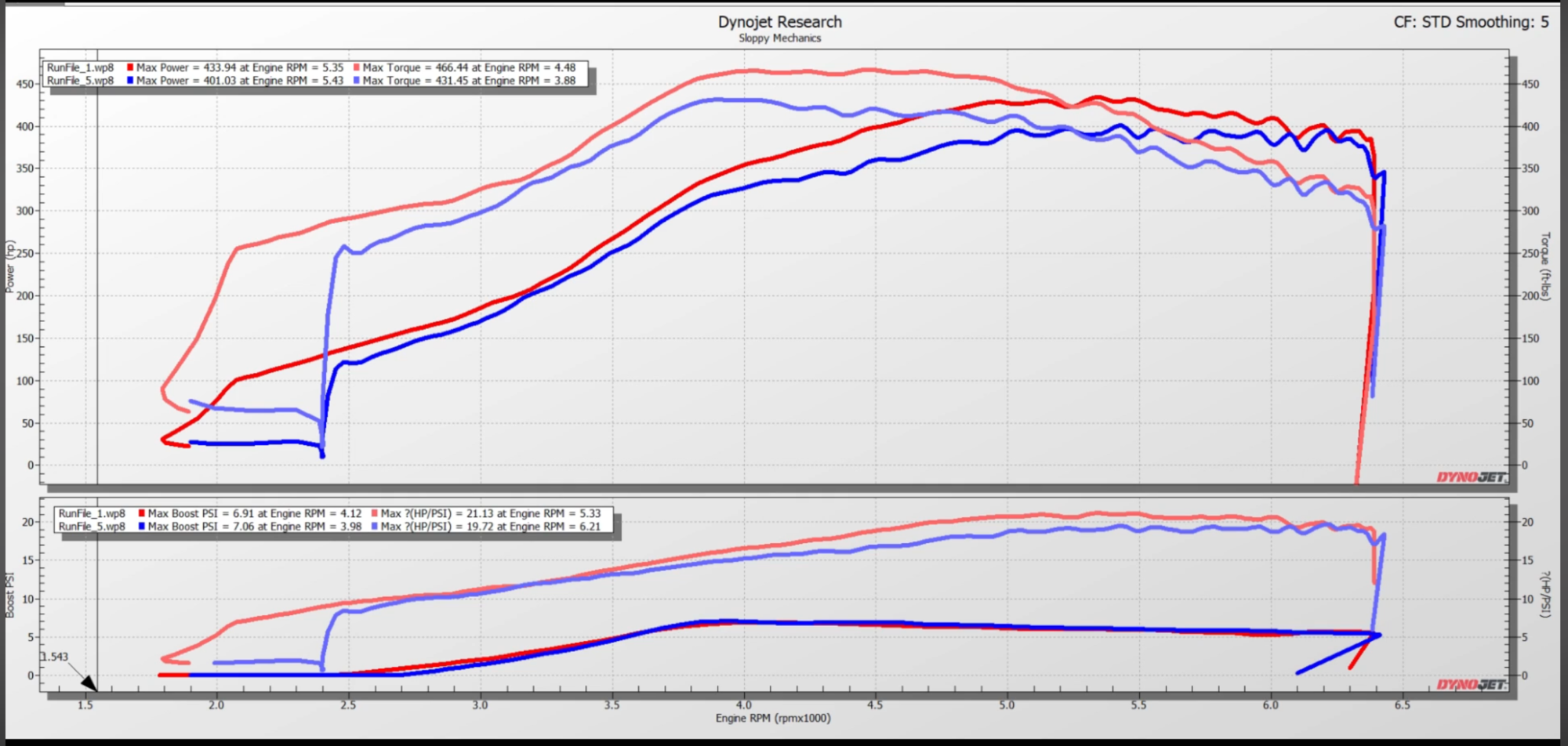

Then I saw another dyno run by Sloppy Mechanics, and the numbers are drastically different. Again, the total loss numbers are similar, but the curve below 3k is scary. It's showing in the 2-2.4k rpm range that the torque numbers are sub 80 ft-lbs?! At 2200 the sheet metal intake has like 70 ft-lbs, where as the early truck has like 260 ft-lbs! I can't tell if that's just how it hit on the dyno, or if that same result would have shown in RH's video had his chart started at 1.5k rpm rather than 3k.

What cam was in the RH video? The LS1 intake is pretty bad also, and gives up a bit to the LS6/2 style.
The sloppy graph is just the difference in when the dyno kicked in, but I would expect a short runner intake to lose 20-40 ft/lbs in the low end. That will definitely be felt in a heavy street cruiser.
I will be putting one of these Summit Max EFI intakes on my LS3 build, but its a big cam higher compression build around higher RPM. Im not too concerned in any tq loss below 4500rpm. It does fit the bill for you in terms of cost effectiveness and hood clearance. The runners go inside the plenum and are longer than your typical sheet metal style intakes, and they have nice trumpet radiused ends, but still "short". Something to think about.
https://www.summitracing.com/parts/sum-226127b-g2
No. You're reading the graph wrong.
Look at the legend. Note that torque is the more pastel lines, HP is the brighter colored ones.
Low-RPM torque does look pretty pathetic in those graphs though. I'd be interested in knowing what cam is in it and what engine it is, without having to sit through a video.
I still think you need a truck torque type of cam. Something in the very low 2-teens of .050" duration on the intake (like 210 to 214), 6 - 8° more on the exhaust than the intake, close to but not above .550" of lift to keep valve train setup simple, LSA 110 - 112°, installed at the normal ICL (not advanced or retarded). Use the intake with the longest runners you can find that will fit. NOT one of those sheet metal deals.
there are no reasonably priced Gen 3 car intake manifolds that are long runner
I may be reading the graph wrong, but I don't think I am. Below is a marked up version of that graph I shared earlier. HP/TQ numbers are on the left and right of the chart but are 1:1 across the range (so 50hp = 50tq, and so on). So the number I care about is TQ (please ignore that I listed it as ft-lbs/hp, I meant to write just ft-lbs).
Looking at the X-axis (engine RPM) you'll see the green line shows 2200 RPM, and the lighter colored line for each maps to roughly 65 ft-lbs and 265 ft-lbs respectively for each intake.
All that said, I 100% agree that I am looking for a truck/torque intake.

I'm not making like wildly incorrect statements here.
I beg to differ.
The more pastel red line is run 2 torque. The bright red is run 2 HP
The more pastel blue line is run 1 torque. The bright blue is run 1 HP.
Looks like the actual "run" began at about 2400 for the blue traces, so at RPMs lower than that, it was idling, part throttle, or some such. Immaterial to the matter at hand in any case. Looks like both runs started recording at 1900 RPM even though they hadn't yet hit the throttle. Looks like the red run they started recording as they were sorta easing into the throttle and it bogged or hesitated or whatever you want to call it between about 1900 and 2100, so the engine slowed down some as the power came up, then kicked in and began acting normally. Looks like on the blue run the engine they stomped it like a cockroach at 2400 RPM and it stumbled BAD when they did that.
Sorry, I got the torque/HP/colors wrong initially. I couldn't read the legend very clearly before butt now that it's blown up better it's more visible.
Ultimately, the lowest RPM's measured torque was about 265 ft-lbs on the red run at 2100 RPM, when the throttle reached wide open in its more gradual motion, and around 250 ft-lbs at 2500 RPM on the blue run shortly after they stomped on it suddenly, which was when the run actually started. All that stuff down real low on the blue run before they stomped on the gas isn't part of the "run"; the engine wasn't at WOT until 2400.
Yes LS1 /2 /6 are somewhat "long" runner intakes. Longer certainly than the typical sheet metal intakes which they're pretty much as short as possible. NOWHERE NEAR as long as the 4.8 / 5.3 / 6.0 truck intakes however. They don't occupy enough volume to have runners that long. That's why they're not as tall.
I think a lot of what you just added is what I had said in my comment above, so I'll say thank you for confirming everything.
I couldn't really understand why the runs were so drastically different on the dyno sheet, but your explanation of easing on vs stopping and the different in start RPM makes sense now that I rewatch the video. Plus the start of the run, I had just sort of assumed after watching RH that everyone runs dyno comparisons the same way, but I suppose I should have realized the title of their channel is "Sloppy Mechanics" so ya know haha.
I get what you're saying on the "long" runner of the car vs the actual long runner of the truck intake. I'm speaking here of more comparison between the two, car short to car long. And before you say anything, I'm using the term "car" as meaning something short, say sub 9" tall.
Again though, I do appreciate some of your context on the dyno graph, I would not have thought of what you pointed out. While I think I was reading the graph correctly, there was some data on the surface I couldn't make sense of, which is why I post and ask. To learn. Still though, I was reading the graph right
