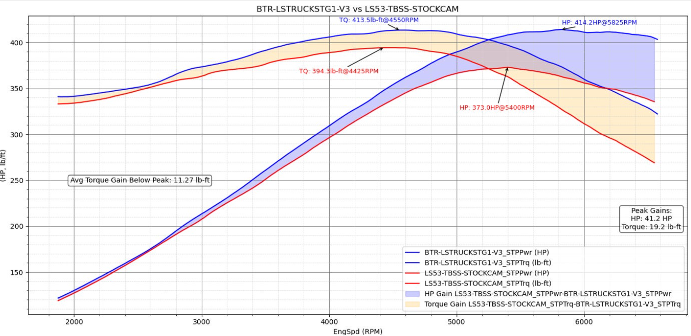

BTR stage 1 or something similar. 201/21x, 111lsa and can use ls6 springs. Will be better than the stock cam down low and better than that late ls1/lq4 cam up top.
BTR GEN III & IV LS TRUCK CAM - STAGE 1 - V3 - BTR-LSTRUCKSTG1-V3

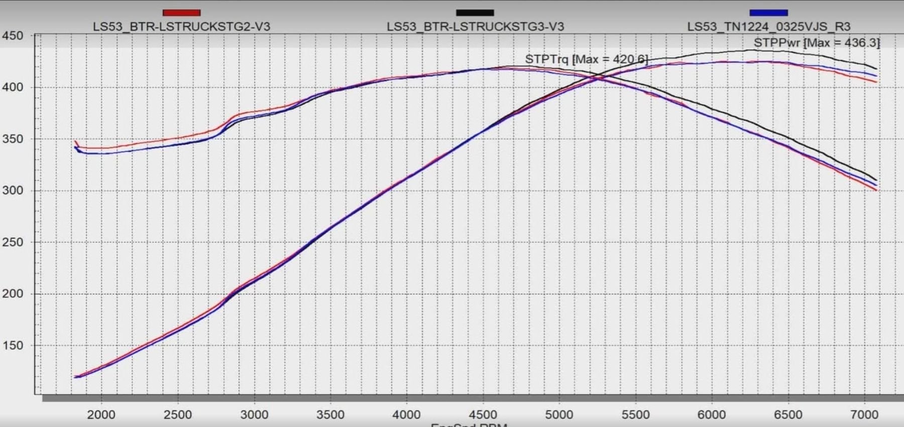

yeah. The new v3 cams are better than the TN in some respects. Stage 2 has a lot less overlap while making more power down low and just slightly less up top. Stage 3 has slightly less overlap and matches the TN down low and has more power up top but you need stronger than ls6 springs. Pac1218 equivalent.
And Stage 1 would be better than l33 cam everywhere whereas the others mentioned might lose a bit at the very bottom in exchange for big gains in the midrange and top.
