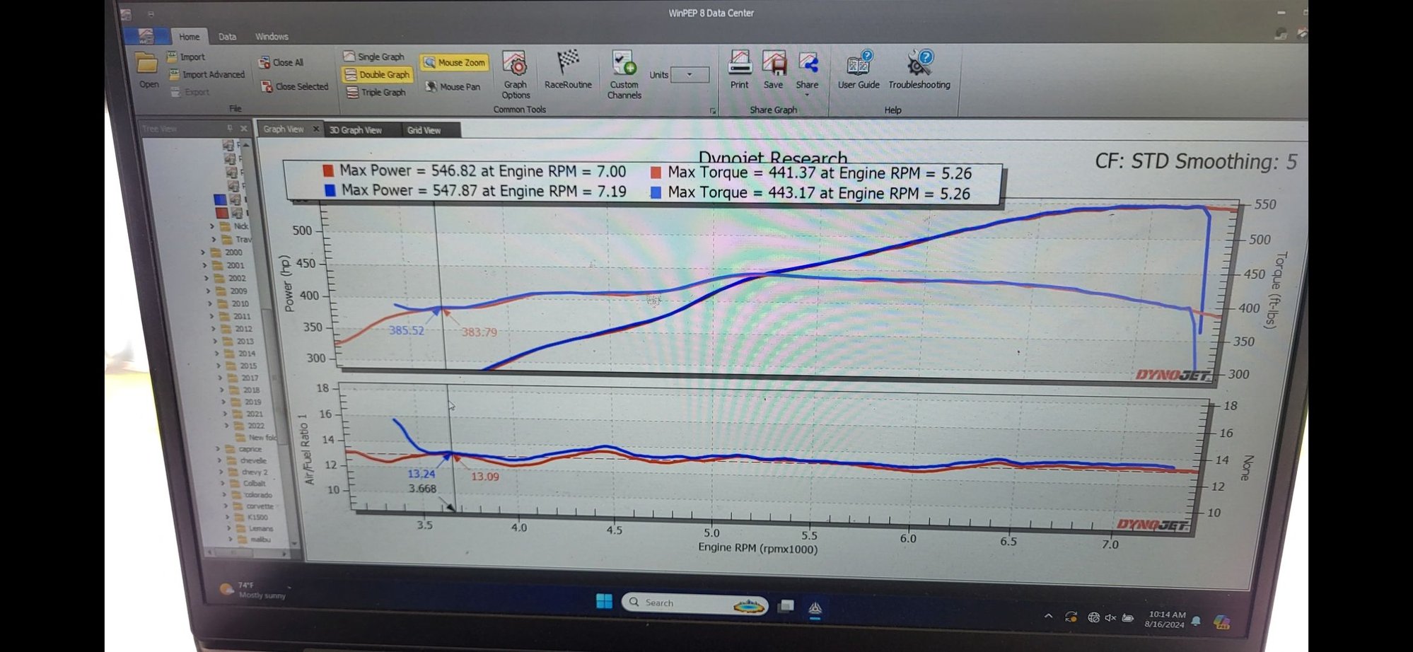

Originally Posted by 02EBC5Z06
Mine is hydraulic. Of course you wouldn't spin an engine to 8500 if it's equipped with a fast 90/92/102, as the design doesn't allow the power to peak higher than 7k. Most of them peak around 6200-6600 depending. The power curve is only going to hold on for so long after that. When I had to the 102 on my car, I only shifted it around 7500, switched to the hi ram and shifted it at 7800 because the peak rose with the hi ram to 6900.
You shift the car based on where the rpms fall in the next gear. You need to pay attention to where peak torque is and that area is where you want the next gear to land in. For me, peak torque is around 5700. So when I shift the car at 8600, I drop back to around 5500. If I were to shift at peak hp (anywhere in that 7200-7900 range) then I would fall back well below peak torque and then I would be causing the motor to struggle back up to peak torque which isn't good for the bottom end.
Sounds like a nasty combo. My 5.7 makes peak at 7100-7200 and holds pretty flat till about 7800 when we stopped the pull. It would probably want a different intake to turn it much more rpm.
It feels like it just never stops pulling. I wouldn't mind getting it back on the dyno at some point to test some stuff.
Most don't ever figure out actual shift points......they just shift at peak hp. And here's a secret that you kinda touched on lightly there......not every gear has the same rpm drop. Which means you likely shouldn't shift at the same rpm in every gear.
