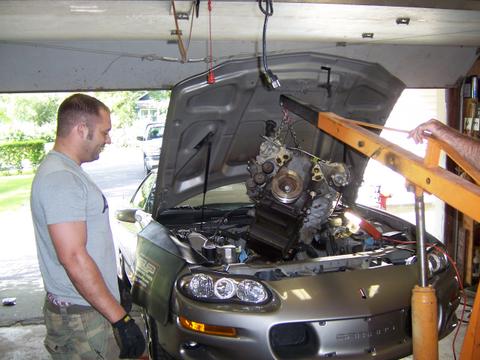

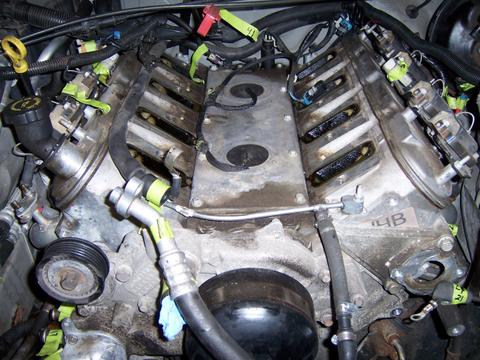

I went from the top but I believe reinstall will require the tranny comin up a little to get the bell housing bolted up to the motor for ease of replacement.
Once you get the intake, coil packs, and all of the A/C and accessories off, the motor will slide out easier if you take off the motor mount on the pass. side from both the motor and k-member and disconnect the mount from the motor on the driverside. Good luck with the bell housing bolts also. My Ypipe was the worse out of anything but then again NY is great on exhaust systems.
