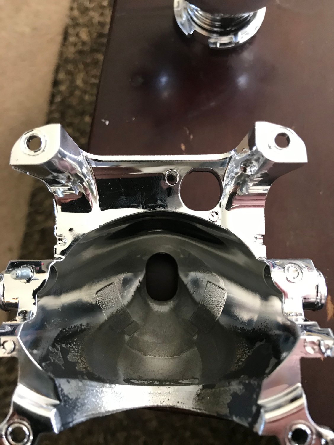

easy way to tell if you need new bowls is remove the bulb and use the mirror and see if there is burnt spot on the backside where the bulb installs into.
Burnt bowls is dangerous driving at night.

Damn those bowls are gone. What did you retrofit in place? I think it’s happening on mine but nighttime output is still very visible

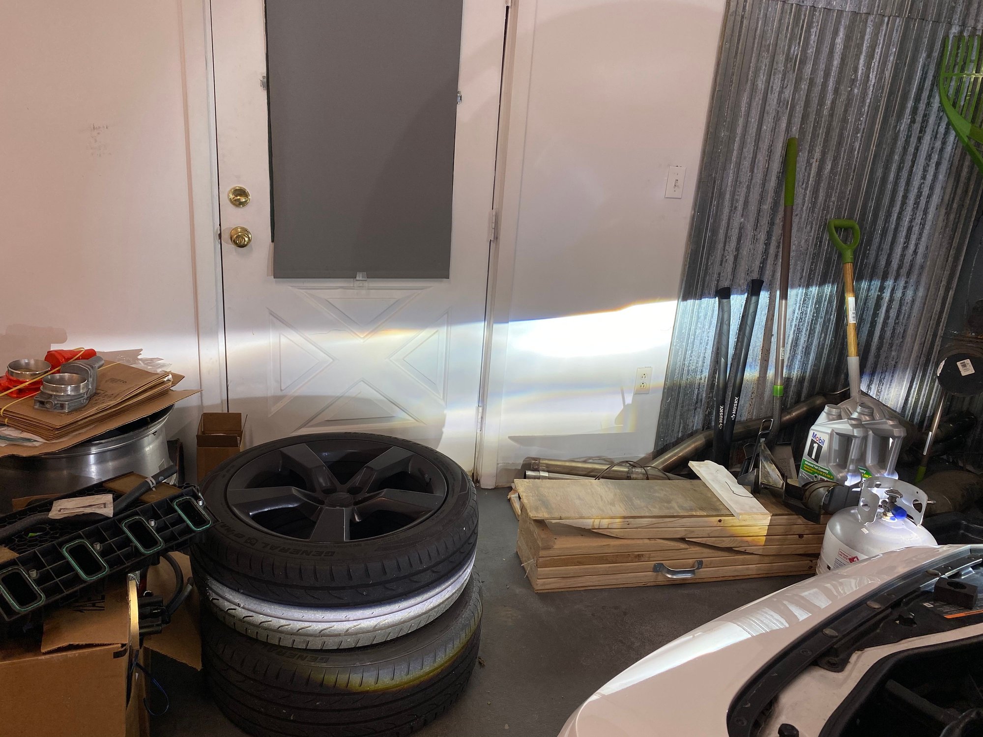

I was looking at my lights output on a wall next to a newer Lexus and I could tell right away that my bowls are burnt lol I can’t wait to have legit lighting out of my headlights

It’s a design flaw every model 10 to 13 the bowls melt. You will not regret it. It’s alittle work but well worth it.

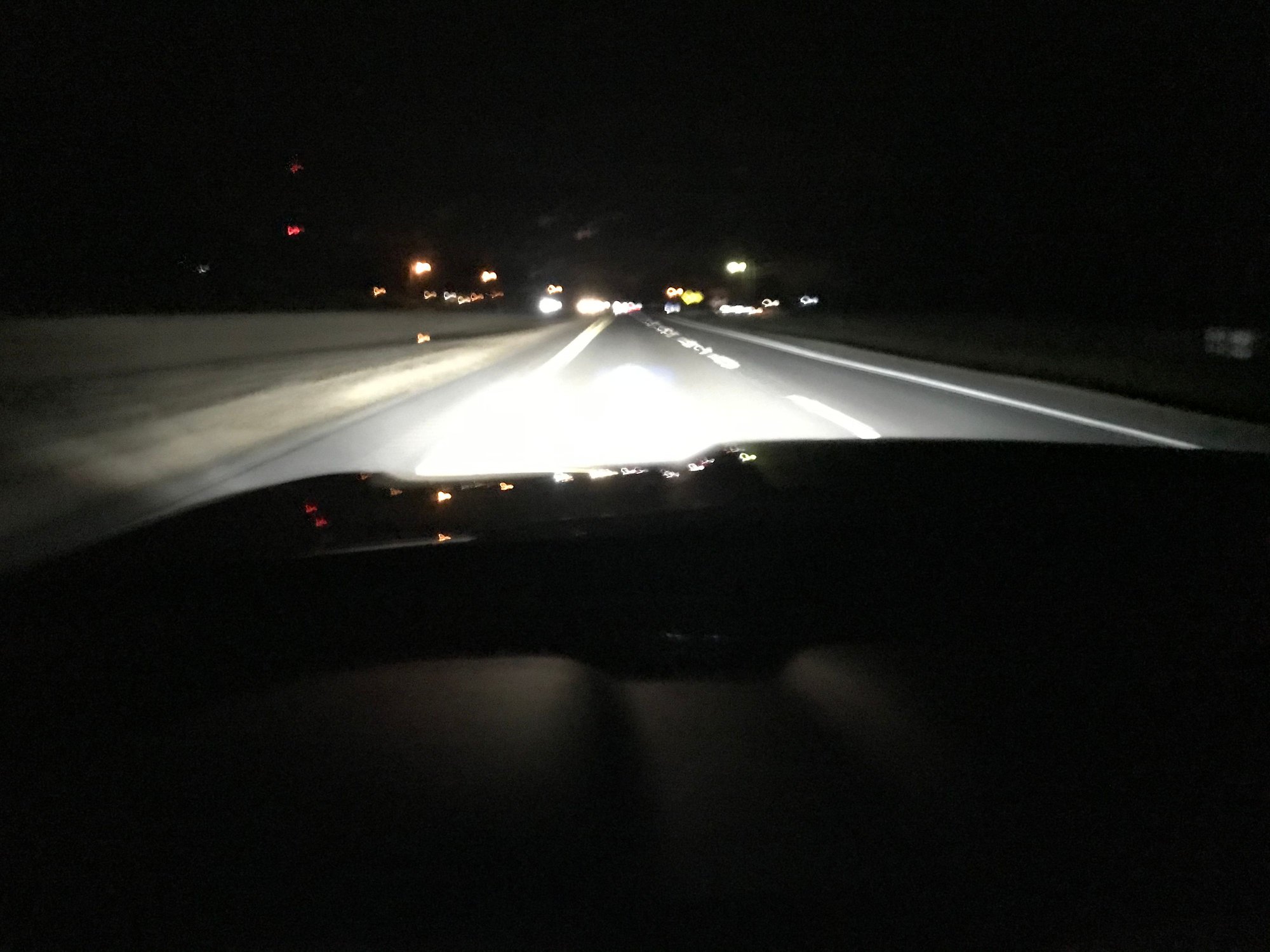

Much higher quality of lighting compared to the crappy garbage GM HID headlights. Just takes alittle upgrade to make them great.

looks good! Did you get the foreground limiter?

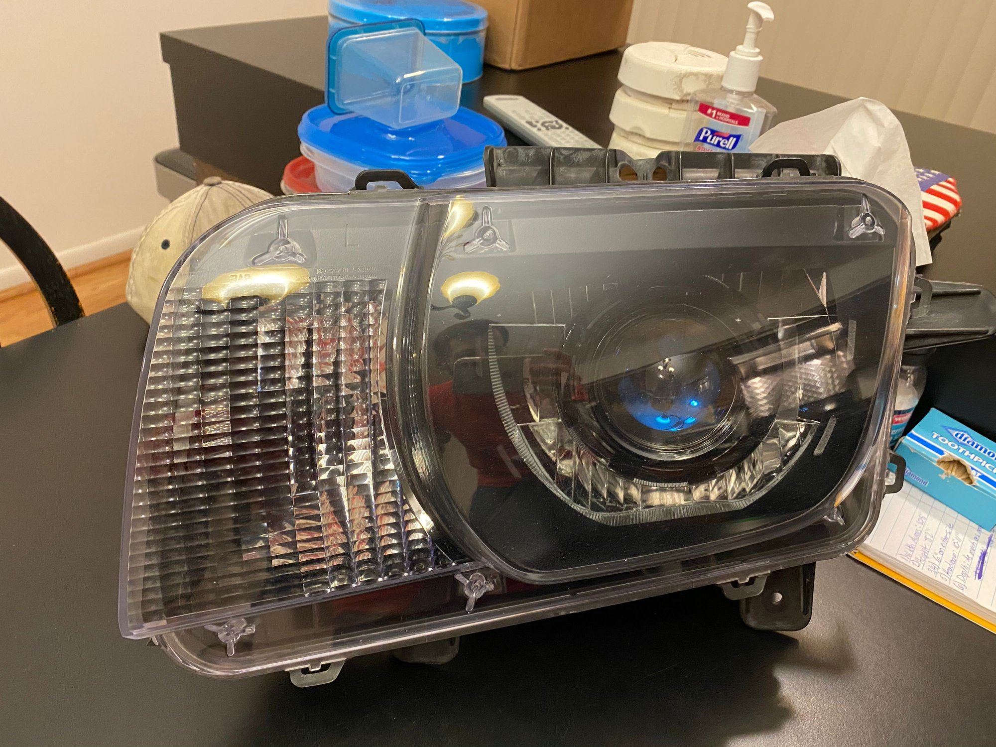

well when I get my first one done and i can do start to finish on my second one ill try to get some pictures of what i do to install some 5.0s in there. I am surprised by now there isn't a good oem option or someone making some reflectors out of metal for these yet. The aftermarket halo assemblies I've found aren't bright according to reviews. I love my factory ones so I'm excited to upgrade them. Thanks for your help so far. Worst part so far I think is separating the lenses. Everyone I've talked to has never had good luck re sealing without moisture leaks. Hopefully I can figure something out.

Please take some pics if you can. It seems that whenever someone does retrofit the oem hid housings they never take any pictures of how they did it. I think filling the gaps on the backside of the plastic “mount” and then drilling holes to line the projector up may work best but wont know till i’m in there

well I'm glad you didn't have a fight. I baked mine 3 times at 275. First tIme for 20. Then 10 and 10 and I fought the entire time. Now I'm hoping I can get it sealed properly haha. I think last time I looked at the headlights and projectors the metal bracket that holds the high beam cut off and the black bracket that holds the glass eye as I call it has 2 holes that go over the plastic bracket in my housing. So I may get longer screws and use the hole to mount all 3 of them together if that makes sense. I will definitely use pictures and horrible drawings on the pictures to try and explain what I did haha. BTW this will all be done via phone camera nothing professional.
