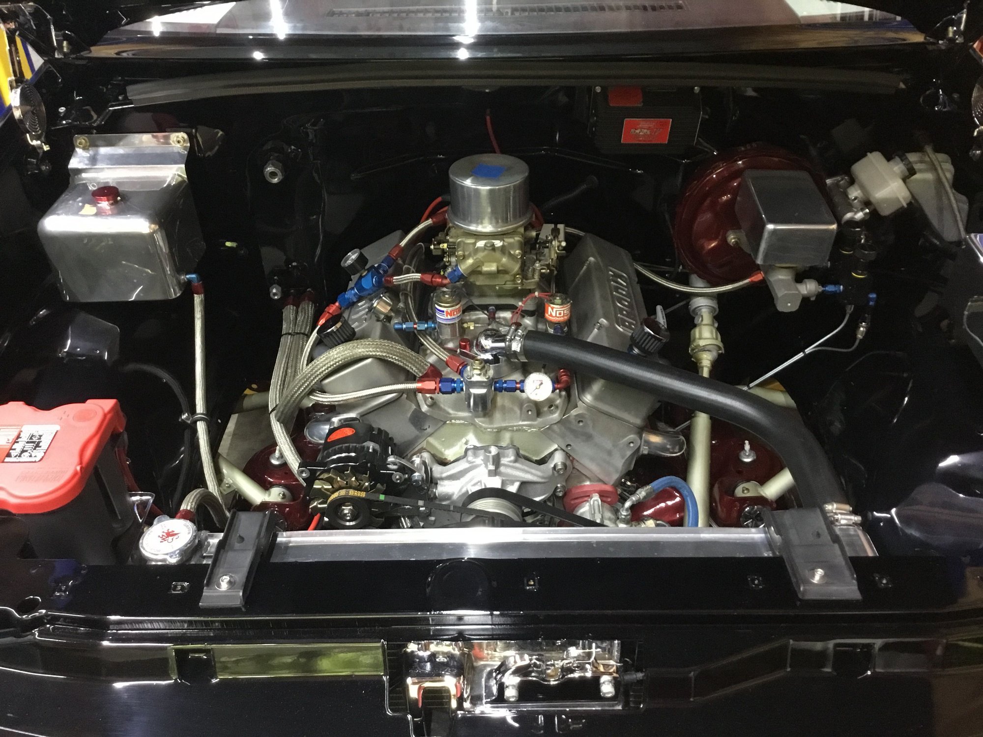

I have a radical sbc in a show-only truck I built in 96’. In a 22 year span I pushed the truck outside and started it twice, 11 years apart. Of course I had to go through fluids and all that crap, but it starts up and runs fine. Only has been 4 miles since 96’. By radical I’m saying it’s high compression, has a set of prototype Brodix heads that were ran on a Cup car in the 80’s with big valve springs, etc. Truck stays in a climate controlled basement garage, so there’s no chance of humidity or weather getting to it, but as far as a timeline goes, no worries. Shoot...I absolutely love to watch the YouTube videos of vehicles that have set for decades out in the woods that folks do a first start in years on. Cool stuff, especially the big diesel starts.

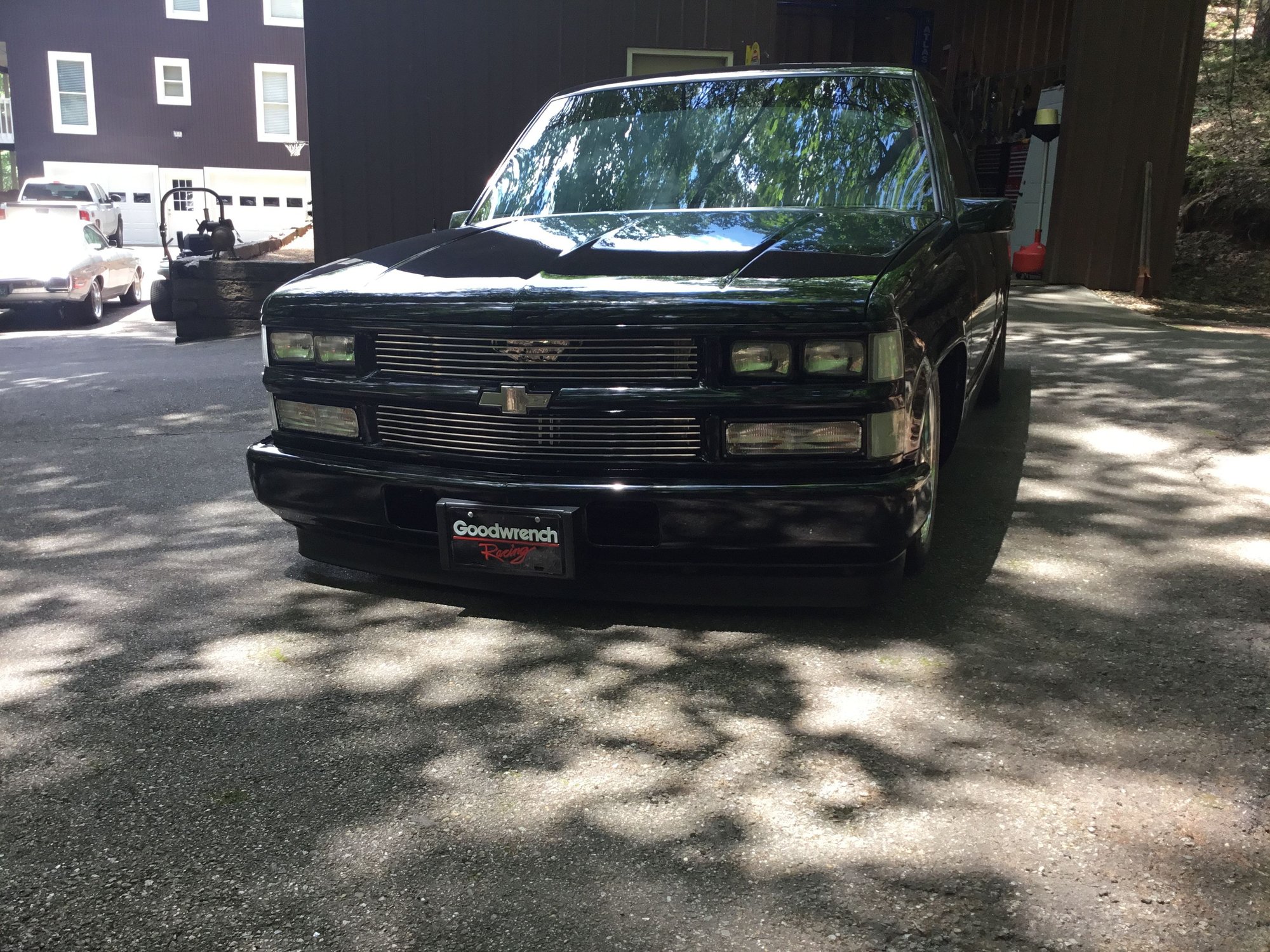

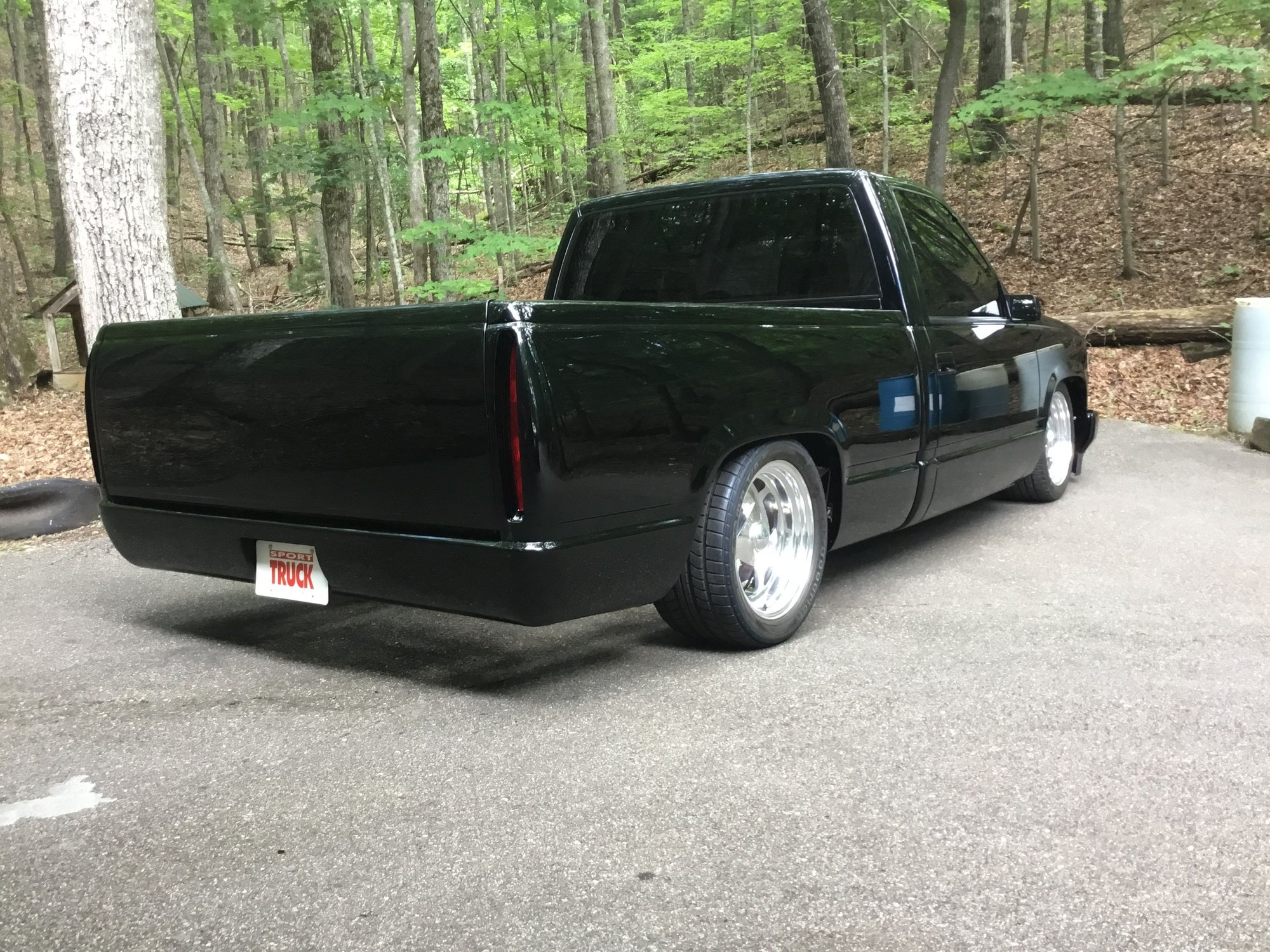

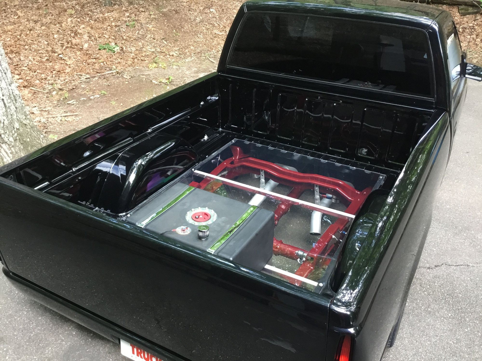

I will throw up a video, but I can’t get you an 11 year cold start unless you want to wait a while. She’s pretty rowdy. Has a 250 shot on it also just for grins. Actually going to put it on the market here as soon as I put the new wheels I just bought for it on. Went with a set of BilletSpecialties SLG55 Sweeps, 18” fronts and 20” rear.
Here’s the biggest rabbit trail, off subject post in Tech history...sorry OP!

not to quote and make the topic go further away from the ops question but damn Chevelle that truck is sick!!! Can’t wait to hear it running

I'll take all the blame for thread derailment on this one. But it was wourth it, that truck is killer... Looks like a well put together pro street/show truck. And op I'd be Leary ove how it was stored and treated as well. I think for another couple thousand you could prolly buy a very nice long block from a reputable shop and have a fresh piece. Ok I'm done fubar ing your thread , I hope it all works out in your favor....
