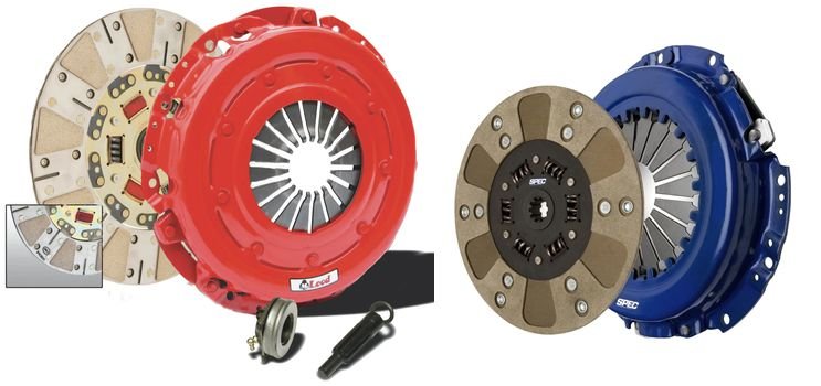

Hi all, please help me decide between a McLeod 75357 Street Extreme or Spec SC663H? Is there any reason to pay ~$100 more for the Spec?
This will be fitting on to a Spec SC57A LS1/6 style flywheel which I’ve already purchased for my soon to be modded L92 and mated to an Fbody T56.
Or is there another brand of clutch that I should be considering?
