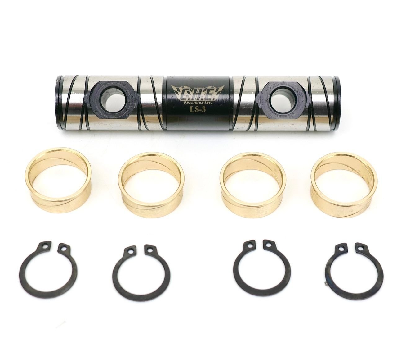

The rockers look like the same ones you can get from BTR. The good part is that they shaft is in 4 pieces per head. Pairing the valves and uses bronze bushings.

It does look good ,but look at it more closely. It is not a one piece shaft Each intake and exhaust are on there own shaft. Similar to this CHE kit but way cheaper and includes the rockers.

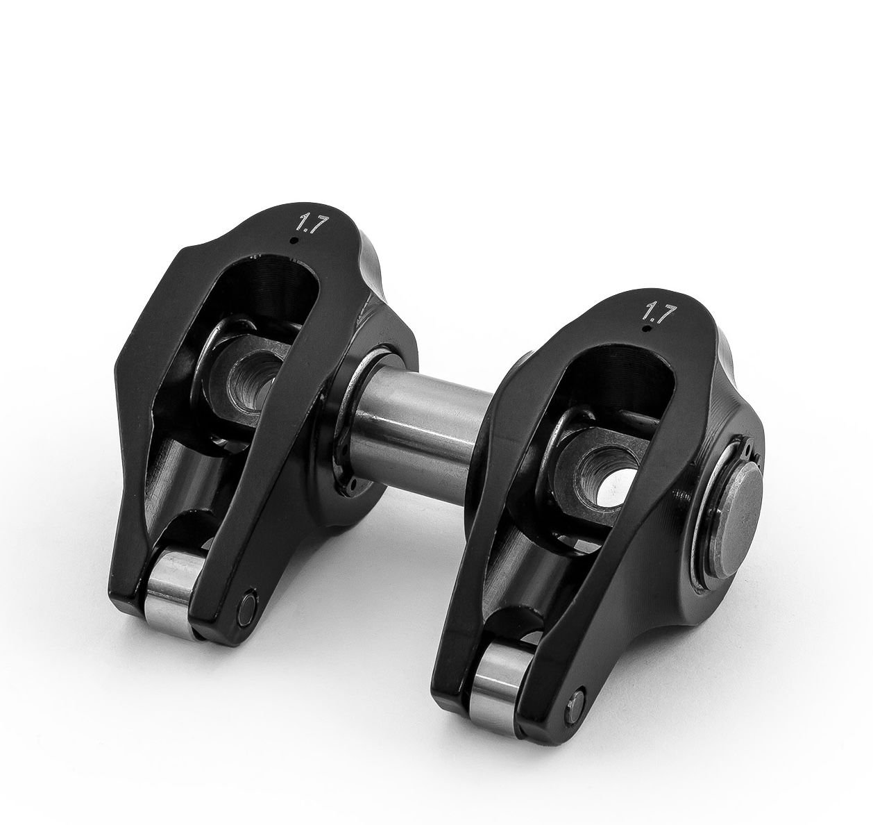

If a cheaper valve train upgrade is what you are looking for. Going full roller is way better.
These speed master copies would perform better. And cost less. Cathedral or rectangle. 1.7 or 1.8

I'll say this and I'm not the biggest BTR fan, but I will say he def tries to make all his products here. If it's like $20-50 more for American vs China unknown, what is that worth? I'm certainly cheap when building a project, but I spend when it's worth it and American as much as absolutely possible. FYI, I have plenty of stories of PBM and Speedmaster roller rockers coming apart, it's a total waste if $$$. Like it's been said a million times, just slap some trunnions in the stock rockers and go. Roller becomes worth it when you are running bronze guides or going for lots of lift. Short of that, it's CHE, Manton or BTR shafts if you want to do it once.
