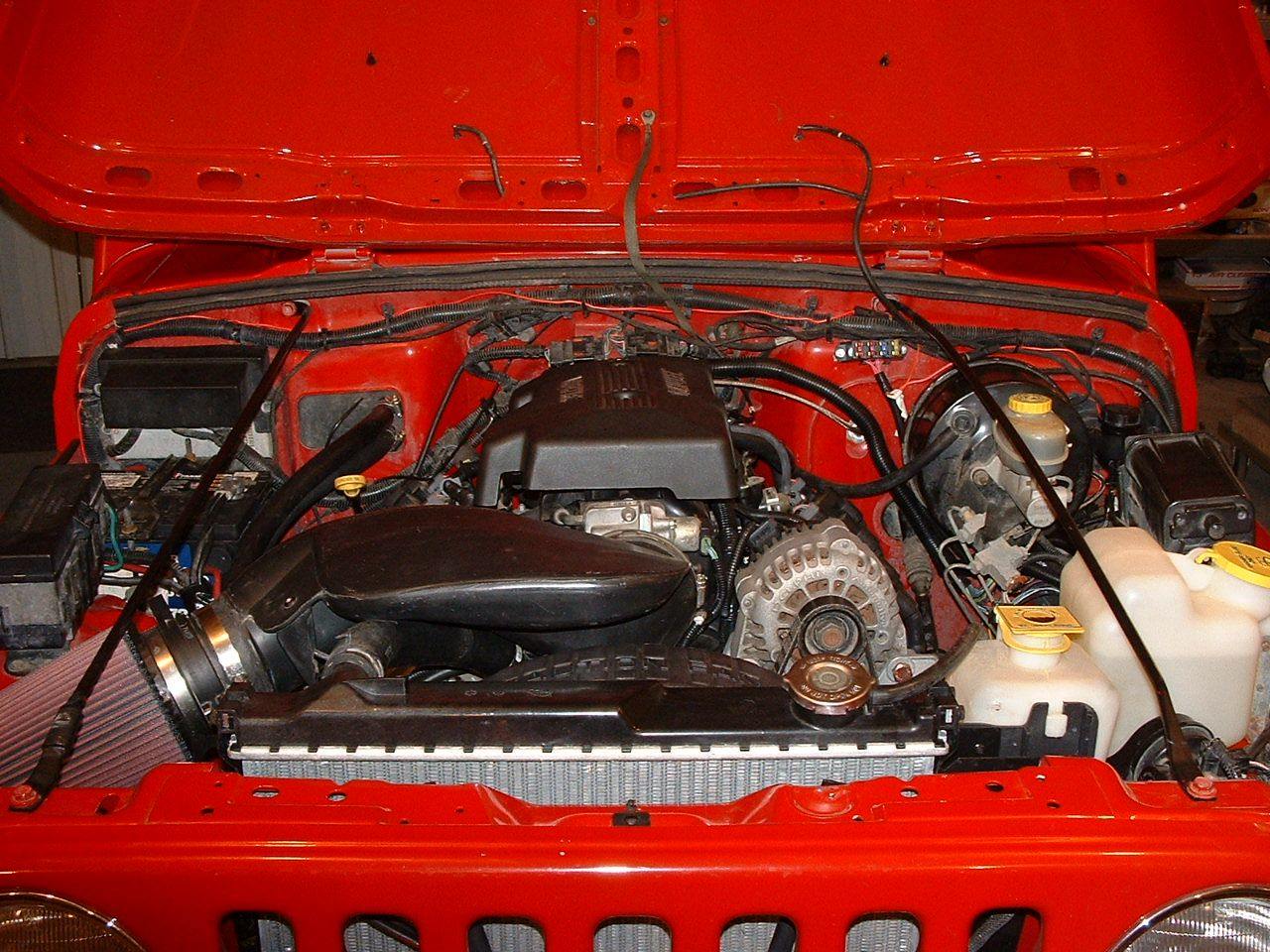

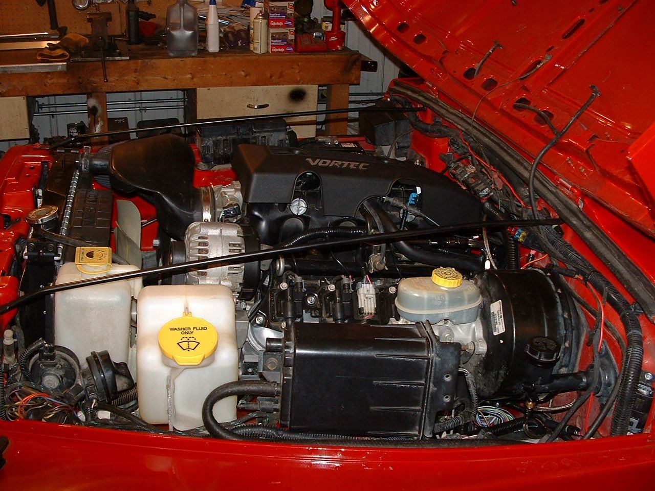

So on my first 98 Wrangler LS swap I used a totally stock 4.8 LS. I used a the stock 2002? water pump and used the stock mechanical fan and 4.0 radiator and shroud. I thought I would have to extend the shroud a bit but no it worked fine.
On all my other LS swaps I've run an electric fan controlled by the ECM. Single Spal 16' fan no shroud.. On at 205 and off at 195. I run the biggest alum radiator I can fit.
Pic.

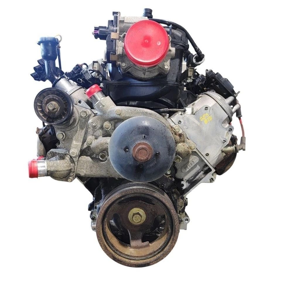

no mods require wire brush the threads screw on the clutch theres nothing else to change nothing special about water pump in non fan clutched trucks

Thanks for the replies. After looking closer at 6.2 Escalade pullout engines (L92, L9H), you guys are indeed correct. The mechanical fan isn’t there, but the water pumps still have the threaded stud present. Easy peasey.
