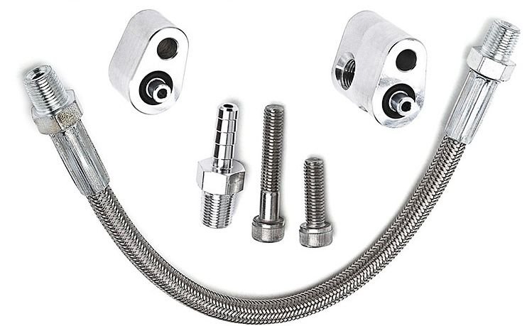

I kept the stock one up front. Added this one to the rear. Added a 90 deg fitting to route the hose forward and tee’d it to the front hose. They are around $30.

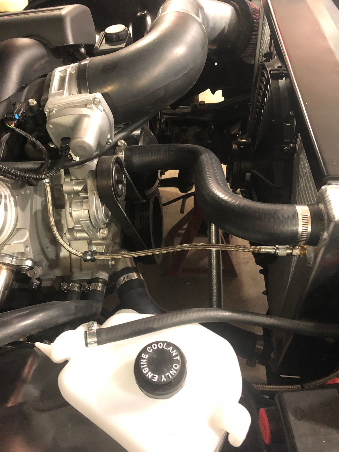

So because I'm cheap I used a truck? steam cross over that has the nipple on the right side of the intake. I cut the nipple off and drilled and tapped to 1/8" NPT. Then using a -3 90 degree fitting along with -3 SS brake line route it up to a NPT fitting I had welded into the radiator.
Pic.
