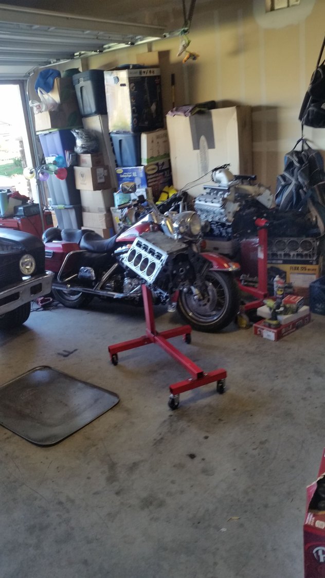

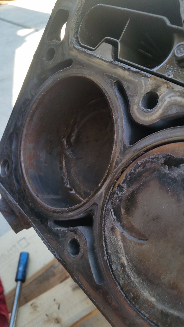

Started to tear down my l96 today.....definitely gonna get ls2 pistons to get me into the 11:1's compression zone
Now time to get the stand and picker and bring this mess inside and see what these bearings look like.......how did your pistons look? 225k mile $800 ebay l96 complete with intake to run lpg.....i can sell this top end and get my money back....lol!

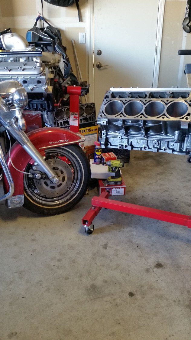

Well they were cheap dnr flat tops if that makes a difference. ...like $140 for the set....lol. on another note .....got the l96 prepped up and painted ready for assembly. ....

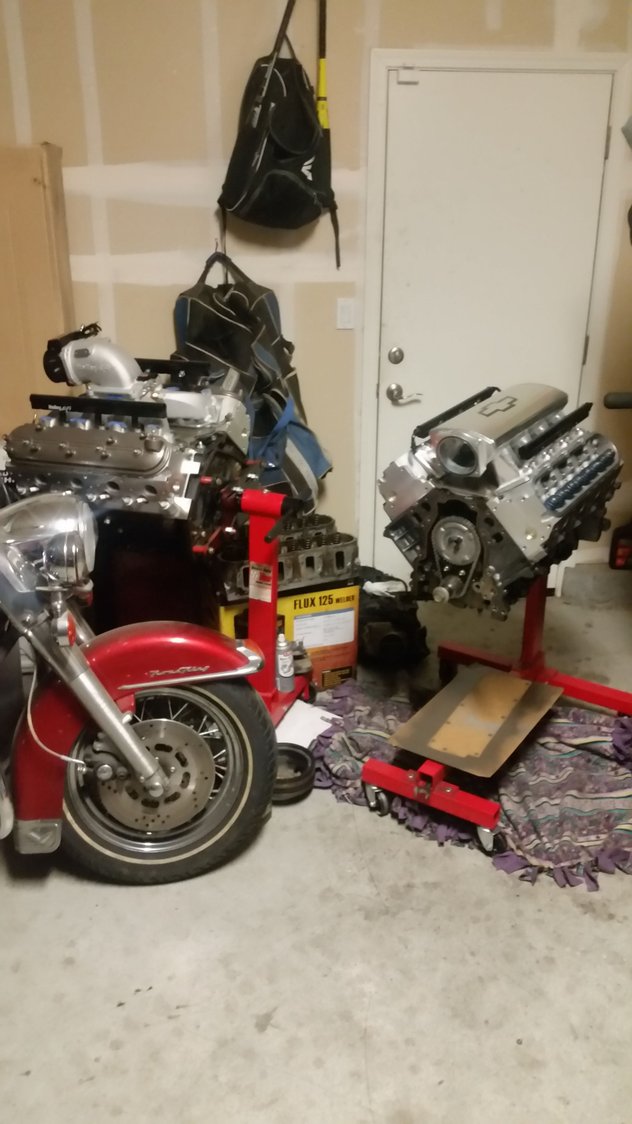

Installed cam and heads today....just about done with this one!!!!
ls2 pistons went right in!!!!
