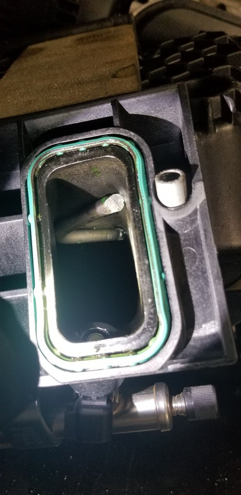

Some more pictures, somehow the intake valve broke are dropped into the cylinder. It is wedged into the head by the piston. Still haven't took the head off to inspect the cylinder.

Head of the intake valve broke off. The stem looks like it sprung up into the intake runner after the rocker broke. Head of the valve is most likely what caused the coolant leak into the cylinder. LLLosingIt nailed it
Yeah he did!

I’ve never seen a valve stem go up the intake. That’s a first for me personally.
Its impossible to put into words how fast everything moves around during an event like this. There will be witness marks on stuff that shouldn’t have them. Having said that, is there a mark on the bottom of the valve cover, directly above the suicidal intake valve by chance?
