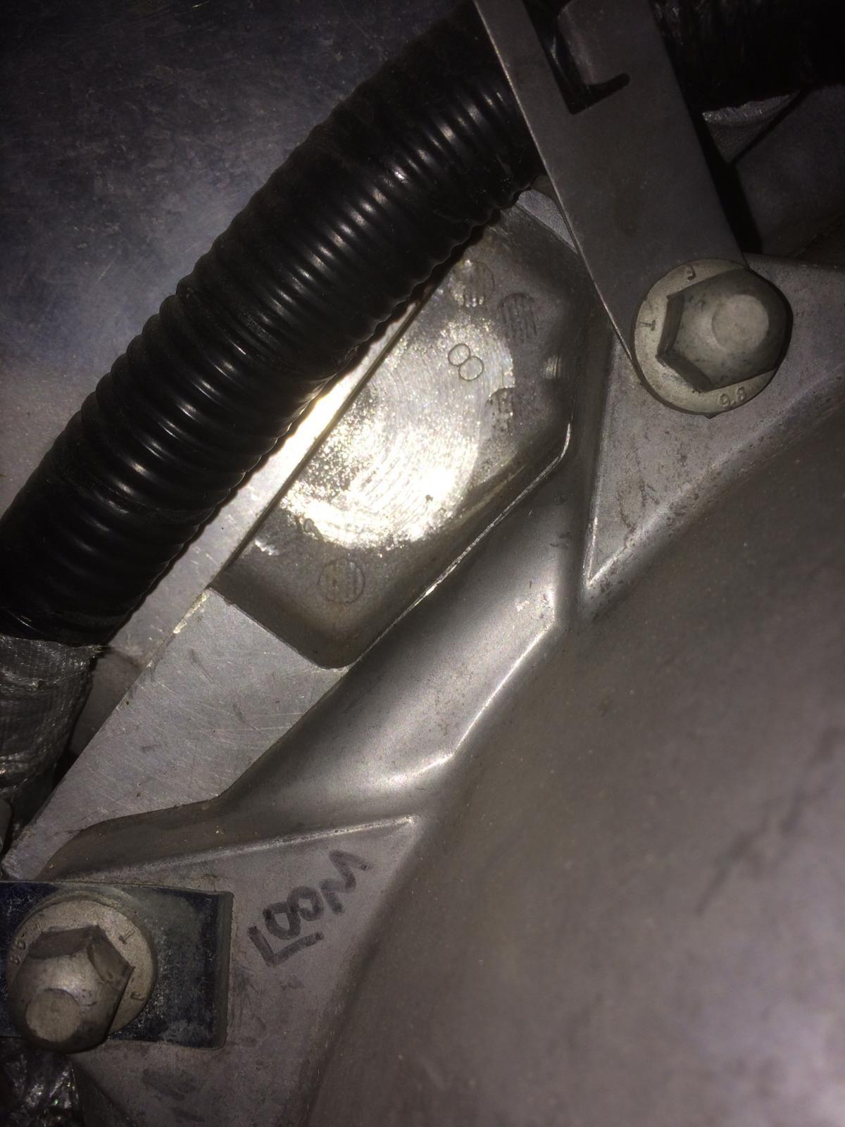

hi guys i want to buy a engine because the seller have no ducumentation of this engine. it looks good have many good parts what i can see .
iam looking for the part number and i found its grinded. and stanced only 1 number .
my question:
anything knows which tuner / manufactor makes this ? i think its a sleeved block because iam not sure

those look like Lingenfelter long tube headers, what #'s are on the heads?

that # doesn't look like it was GROUND off, your not looking in the right spot.

Looks like an LS7, all aluminum LS blocks have sleeves, so yes it has sleeves, to confirm it’s an LS7 verify the casting number on the heads, it should be 8452...those aren’t factory valve covers, and GM never made a 430ci motor, looks like it has a lot of aftermarket parts, prob has at least aftermarket pistons and I also I see a NOVI/Paxton Blower

yes it has ls7 heads , its also a wet sump engine, i mean aftermarket sleeves likes dartons,

I think it says on the front of the block by water pump how many liters (size) it is. So if it is an LS7 it will have a 7.0 on the front of the block - BTW these are big numbers not easy to miss.

i have the engine here its a ls7 block ,
the heads are ls7 have EE marks and have a light headport , which firm used EE marks ?

you showed us a pic of a complete motor, how would we know what kind of sleeves are in it, stock or otherwise?
