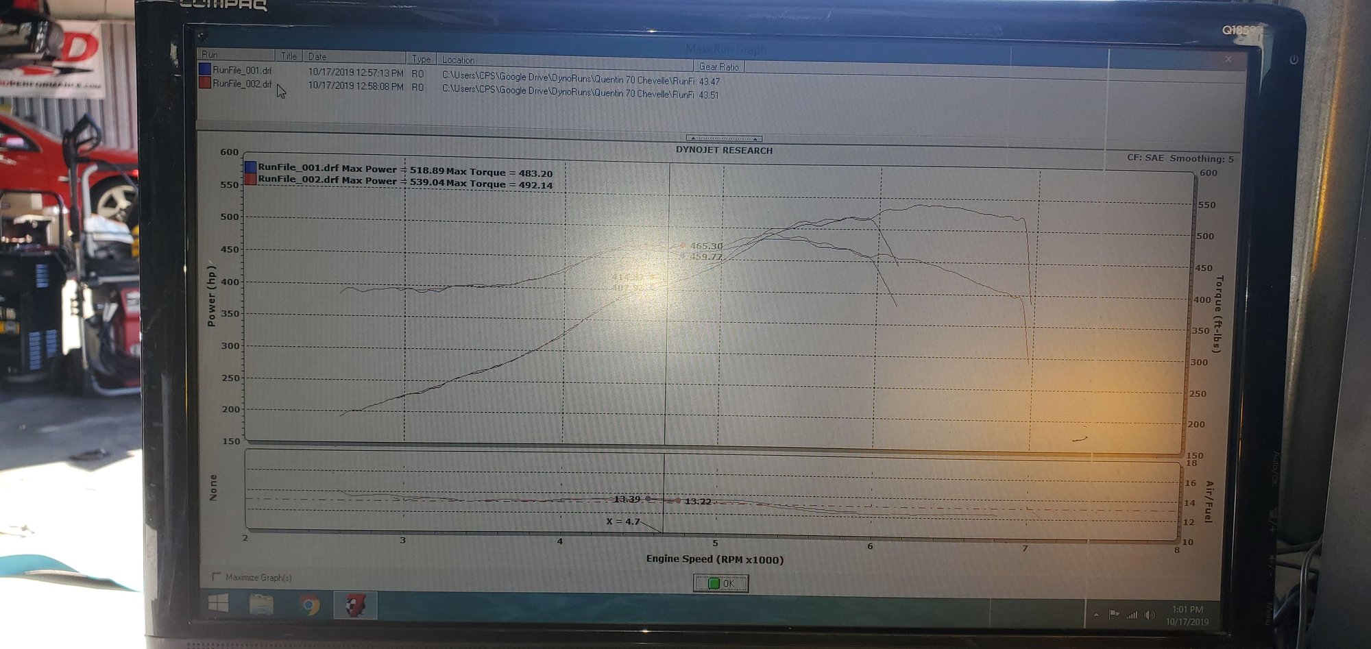

I've put about 150 miles on the car with the new fast intake so far and I'm loving it. The car seems to drive alot better at lower rpms and I haven't retuned the car yet. Today I went and put the car on the dyno to see where I'm at.
The best run was 539/492, more than I was expecting. The car still has a stock ls3 throttle body and 1 3/4 headers with a ford 9 inch with heavy 20 inch wheels. Here's a picture of the graph.

Originally Posted by lawrenq
I've put about $150 miles on the car with the new fast intake so far and I'm loving it. The car seems to drive alot better at lower rpms and I haven't retuned the car yet. Today I went and put the car on the dyno to see where I'm at.
Looks ok but I'm curious to see once it's had a full proper tune and see how it runs.
I would expect another 40-50rwhp -15% for the Australian conversion and you will be at 510rwhp which is about right.
Camshaft is a little conservative for the engine size but will drive well on the street.

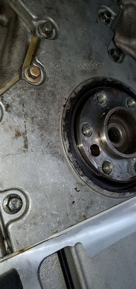

My car felt pretty powerful the first couple hundred miles, but now that I'm used to it the car didn't seem as it was. That's the reason I put it on the dyno just to make sure that it was running properly.
On the oil leak, I found that the fitting on the side of my catch can was screwed so far in that it was right against the filter element and was blocking off the dirty side of the pcv. After fixing this the car leaks less oil, but it still leaks. Im pulling the transmission to find out exactly where the leak is coming from.

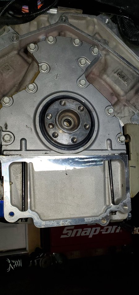

Found my oil leak, it was the main seal. Replaced the whole cover with a new one with the seal already installed. While I was at it I replaced my barbell with a billet one.
