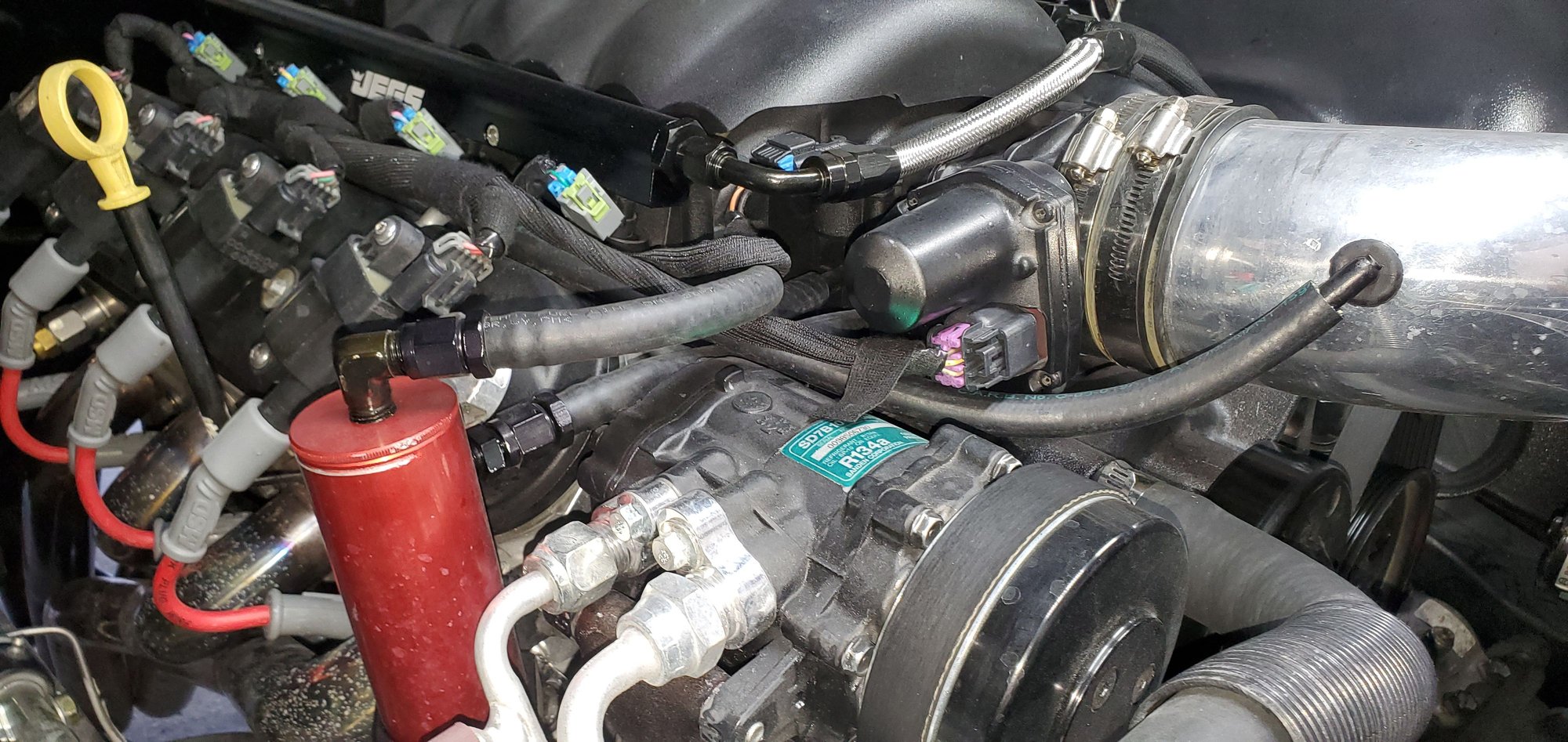

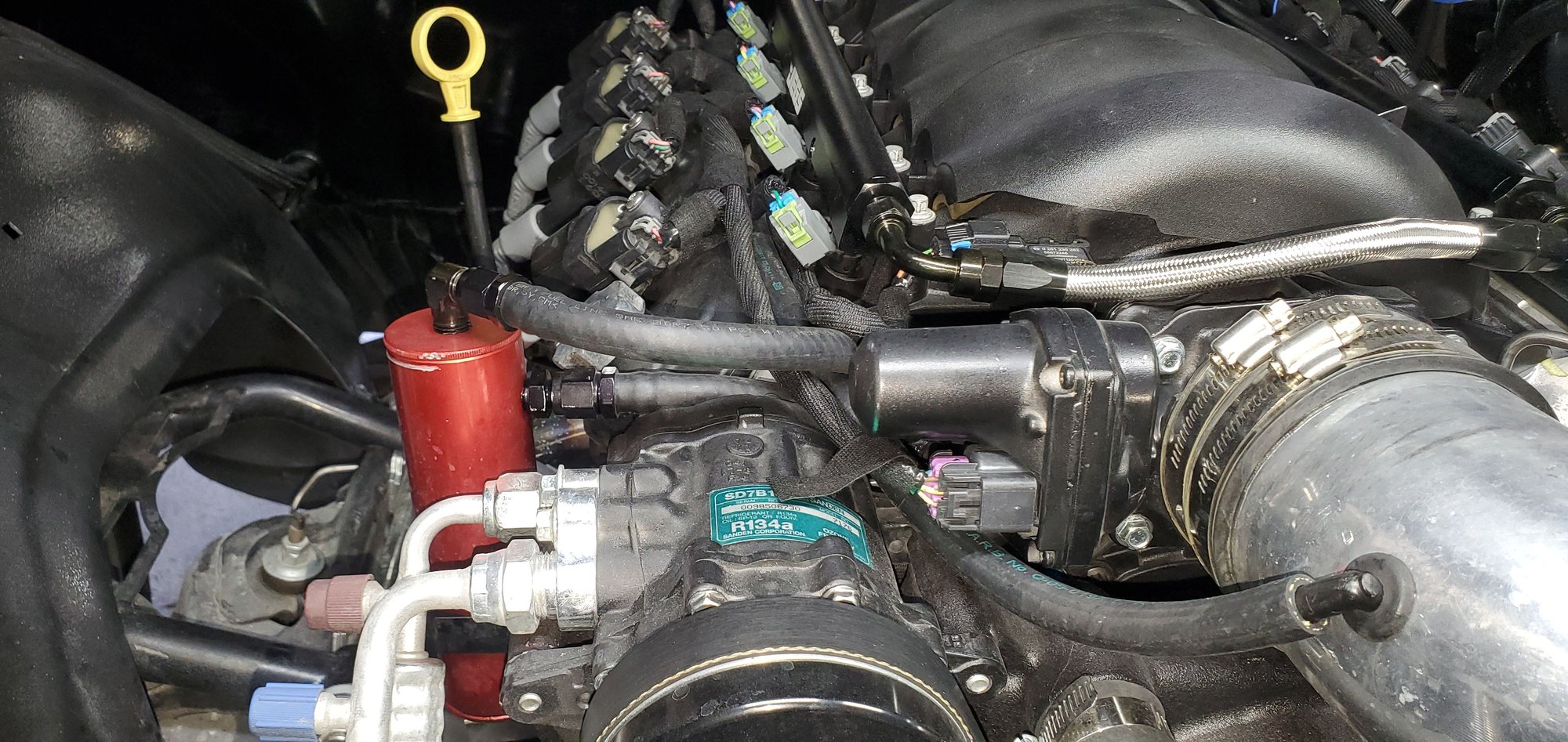

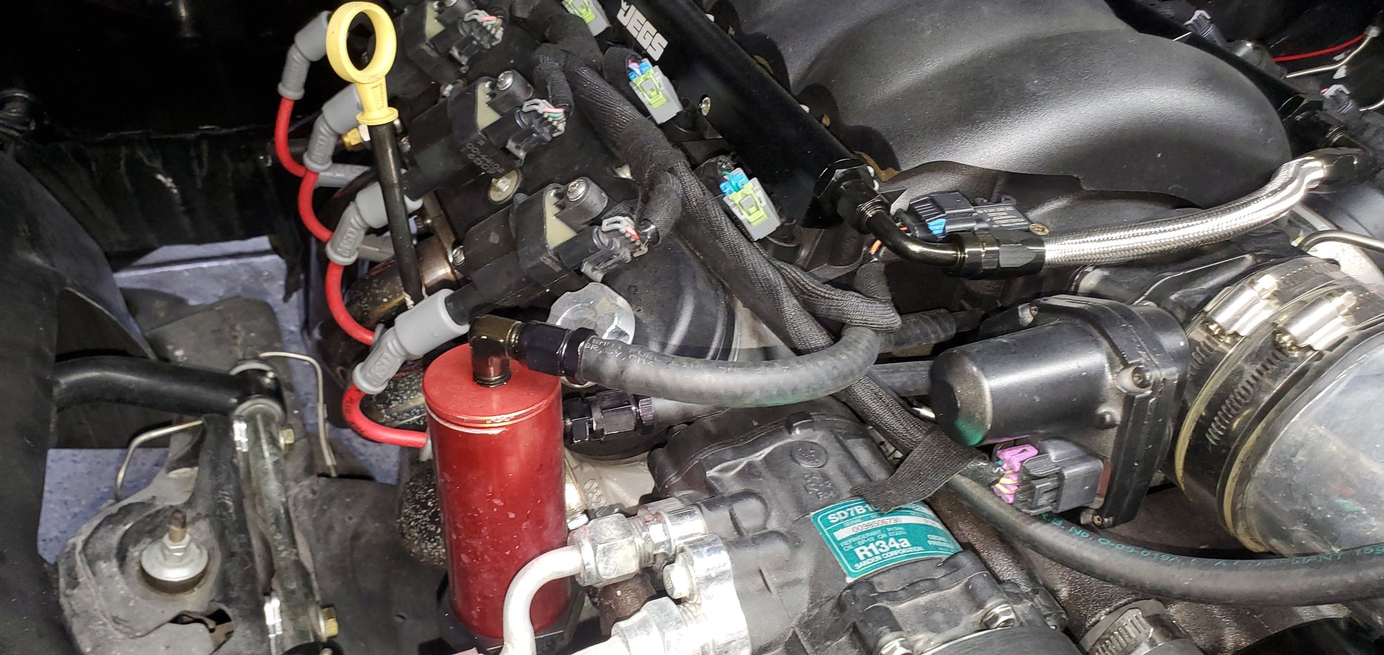

I've ran into my first issue, it seems that I have an oil leak. The leak is coming from the back of the engine, from the rear main or cover. But before I pull the engine to replace the seals I want to make sure that this problem isn't pcv related.
I'm using a mike norris catch can, Holley valve covers, and an ls2 valley cover with the pcv valve vent built in.
I have fresh air from the cold air intake going to the nipple on the passenger side valve cover. The valley cover is connected to the top of the catch can and the side of the catch can is connected to the nipple behind the throttle body. The driver side valve cover is capped.
Originally I had the catch can connected backwards, would that cause the rear main to leak? What else should I try before checking the rear seal?

Doesn't appear to be coming from there, around the sending unit and the back of the valley cover still looks clean. I'm going to try a better catch can with a one way breather to see if that fixes the problem.

Is there a noticeable amount of crank case pressure with oil cap off? Or lets say comn from existing catch can set up? Just curious how well the machine work on the motor is or how well it was put together.

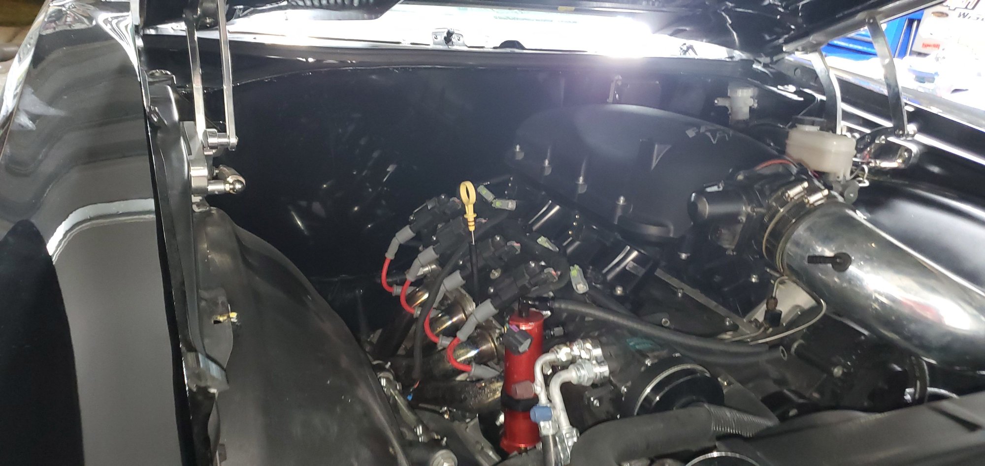

I also test fitted the new fast hi ram intake. It actually fits well with the stock Chevelle non flapper cowl hood. It's pretty tight where the throttle body sits and I might trim the bracing for the hood for a little more clearance.
I'm still undecided on running a ported throttle body or upgrading to a nw102 throttle body.
