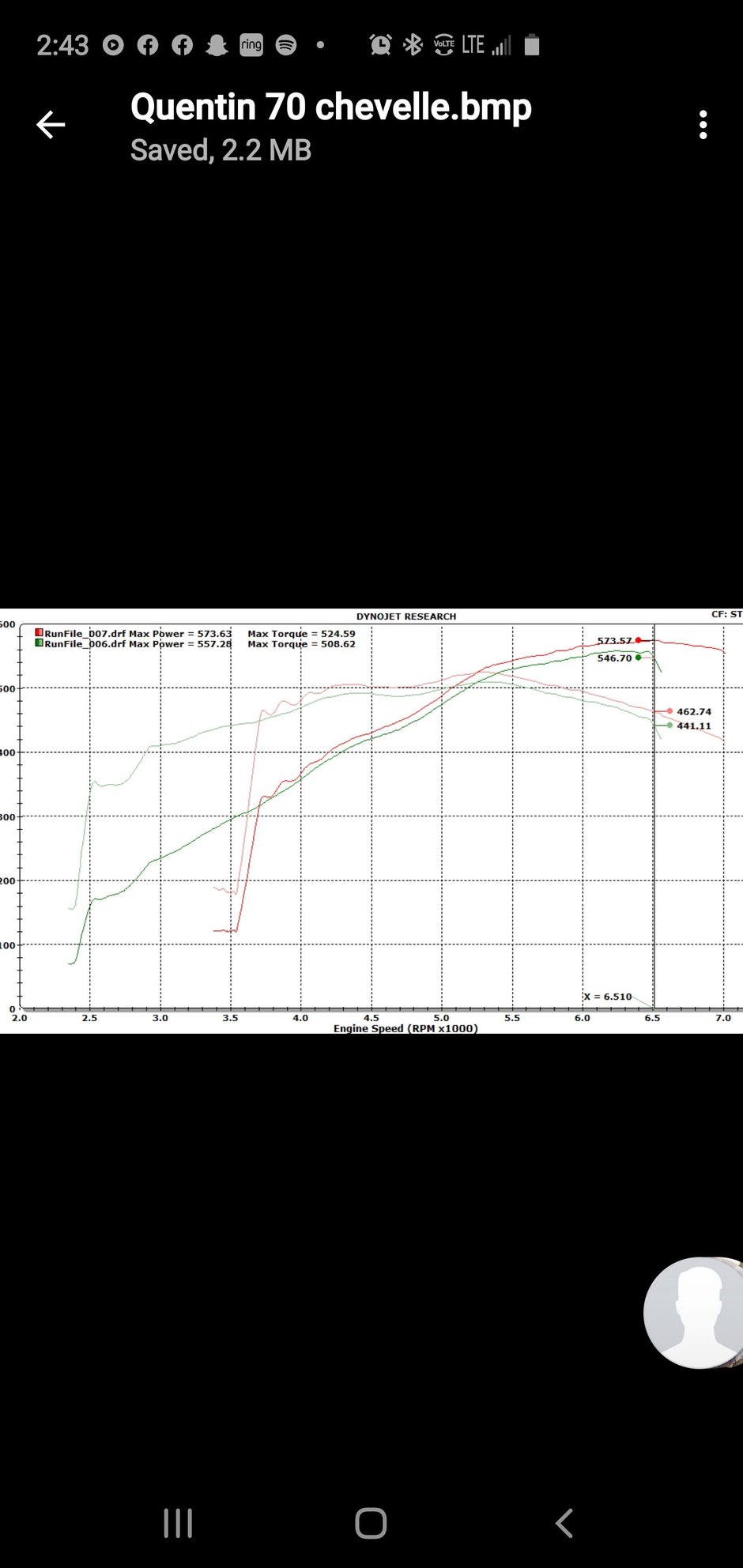

I put the car back on the dyno yesterday. My best pull was 573 hp and 524 lbs of torque, a gain of 34hp and 32 lbs of torque.
I have the graph in the dyno section of this forum. The car peaked around 6500 rpm, which is also where idc is around 100%.
I'm still using the stock ls3 injectors and I'm going to upgrade to bigger injectors soon and try again. So far I have around 1500 miles on this build with no issues.

The cam specs are 241/250 .629”/.615” 114 LSA +3.
I had a stock ls3 intake on the car before, however I never dynoed the car with that intake. Here is the dyno sheet
Impressive. Power and torque are almost matched.
Being a 434 I think the cam timing is a bit conservative too.
But i think you mentioned you want it to drive well.
I'm curious if you were to fit a 248/256 113lsa+4 camshaft how that would go in the mid range and top end.
That fast hi ram flows a lot of air.
