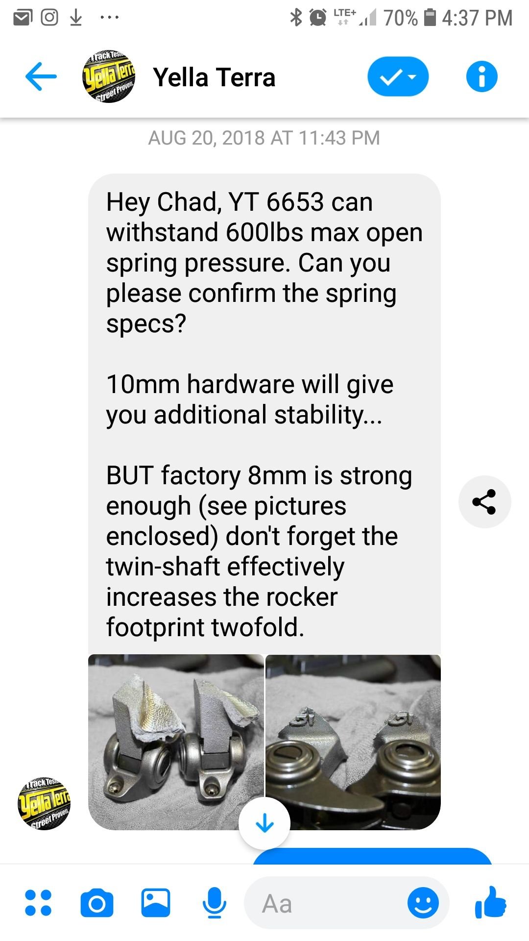

When I bought my rocker arms, this is what yella terra told me

The website says differently. I bet it would hold it. But will they warranty it?
The rocker you enquired about are the same ones as mine except I have the 6654 version which have the 10mm bolts.
These are the pro street version.
They also have the ultra lite which can withstand up to 425lb of open pressure
Then you have the ultra lite pro which can withstand up to 480lb of open pressure.
I was thinking of going back to the ultra lite pro but I don't feel comfortable pushing these over their limit running a 1209x spring.
