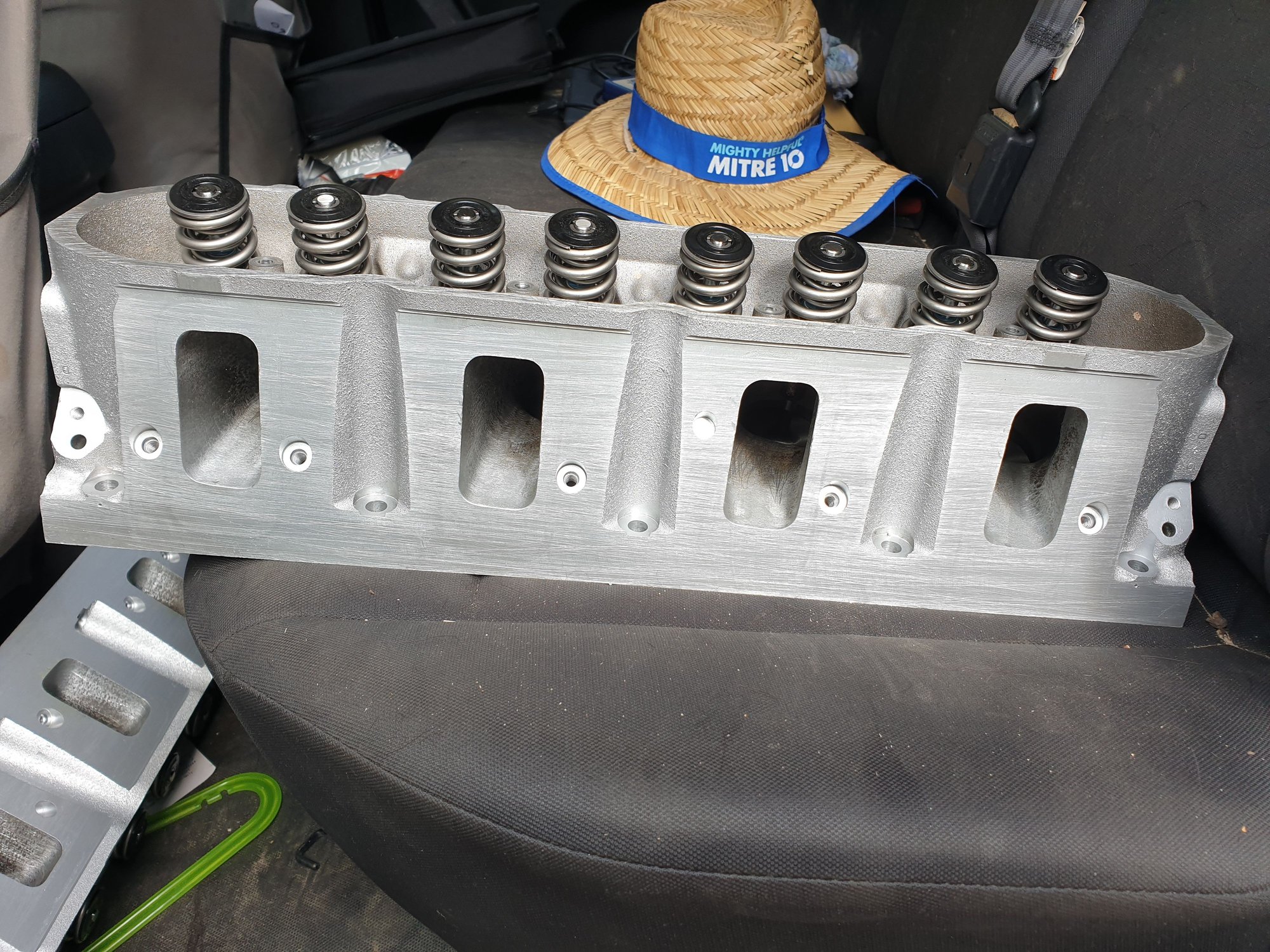

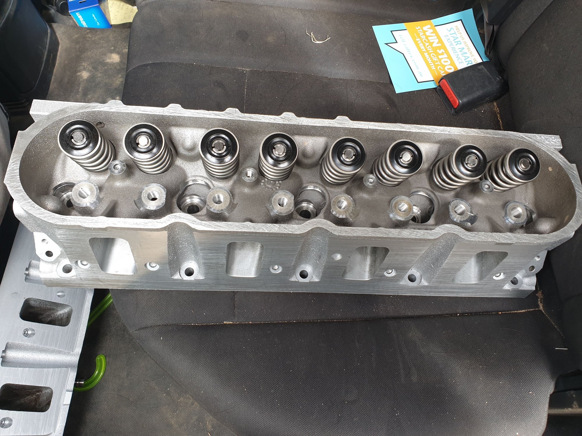

Gentleman, I thought to update you all on my progress with my engine build,
I heard back today from my engine builder and it's finally being put back together.
That 242/257 .660 .655 113 LSA +3 was installed and degreed, The specs were spot on and was installed two degrees advanced ( plus one degree of ground in advance)
The heads, rockers, valve springs, head valves etc have all been done.
I had to get slightly longer pushrods and unfortunately the 3/8 size pushrods could not fit without fouling the head so I had to go for 5/16 with a thicker 80 thou wall thickness.
These will be more than strong enough for my combination and high rpm power I am told.
The Isky high rpm lifters fitted without any clearance issues.
Engine is a LS2 408 stroker with the following combination:
CNC LS3 heads with 12:8.1 compression (runs on e85)
FAST 102mm intake manifold
3200rpm stall converter
3:91 rear gears
PAC 1209X valve spring kit
Yella Terra 1:8.1 ratio with 10mm bolt upgrade
Isky HPX high rpm hydraulic roller lifters
Cometic MLS head gaskets
Mezeire Electric water pump
Check out the pics below:

Good looking build. Who did the CNC on your heads?
The CNC work on the heads was done by a hand porter years ago using his own designs. They flow really well which is why I made good power (505rwhp) with only a mild camshaft.
The machine shop chemically cleaned the heads this round when they went in to get the threads enlarged for the 10mm rocker bolts plus the new stainless valves and the seats etc.
Do they heads look CNC'ed in the picture?
I have never been able to compare a stock LS3 head VS a set of ported ones.

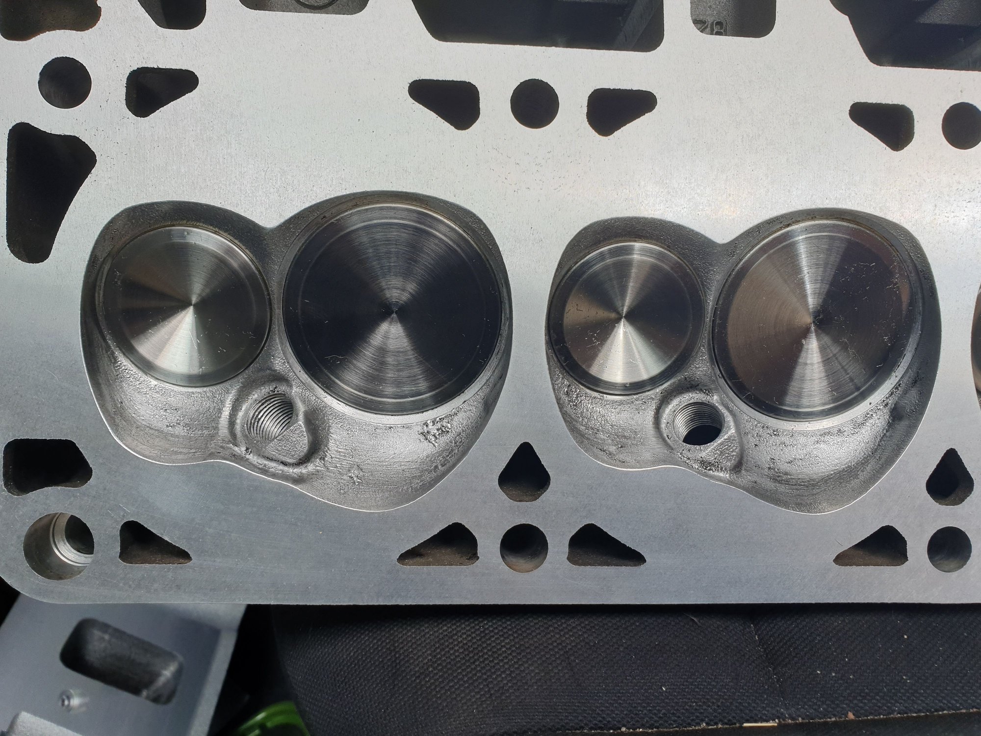

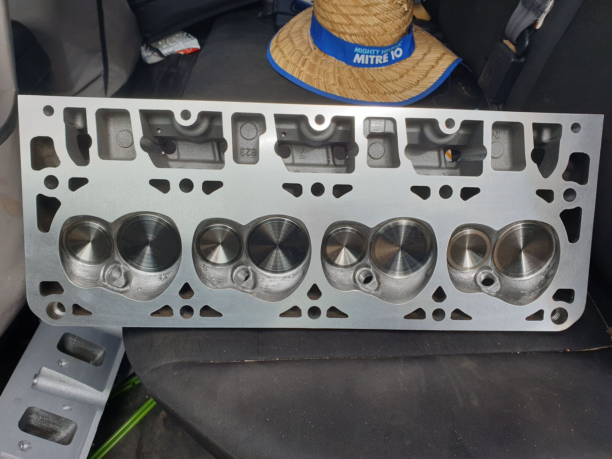

What do you guys think of the ports?
Note larger threads
Nice valve job?
Nice valve job? Close up
Here are some more close up pics of the heads after the machine shop:

Can’t really see much of the ports or valvejob, but it doesn’t look all that great. They didn’t blend in the top cut or do any work to the chamber at all.
