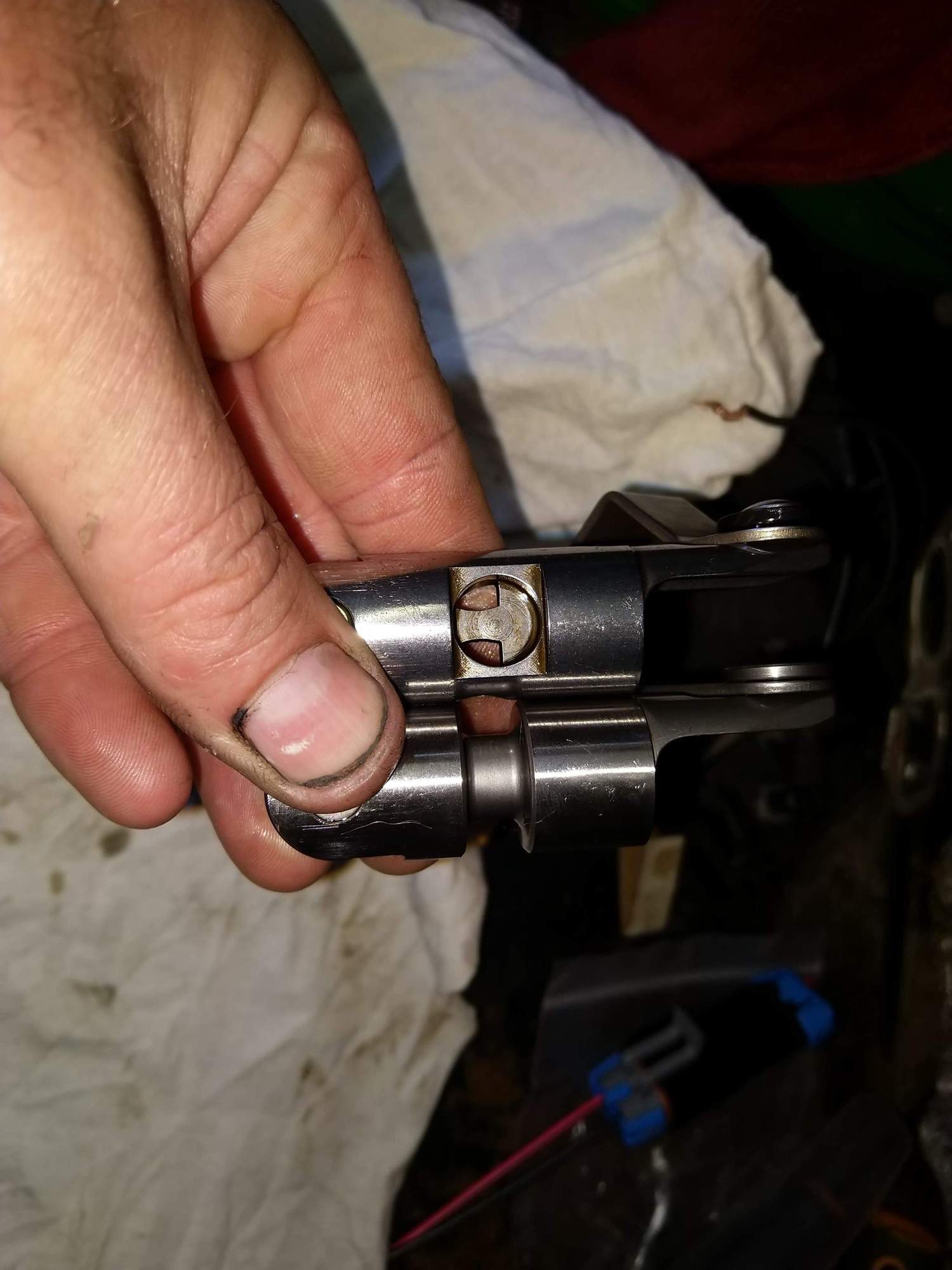

Lifter comparison of Morel 5425 and the Cam motion premium solid lifter.
The top end is almost complete.
Should be done in a day or so.
Then back on the dyno.
Is that the Morel on top?
Old Feb 5, 2020 | 07:45 AM
  #1018
bortous's Avatar
Joined: Sep 2010
Posts: 2,898
Likes: 467
Correct
