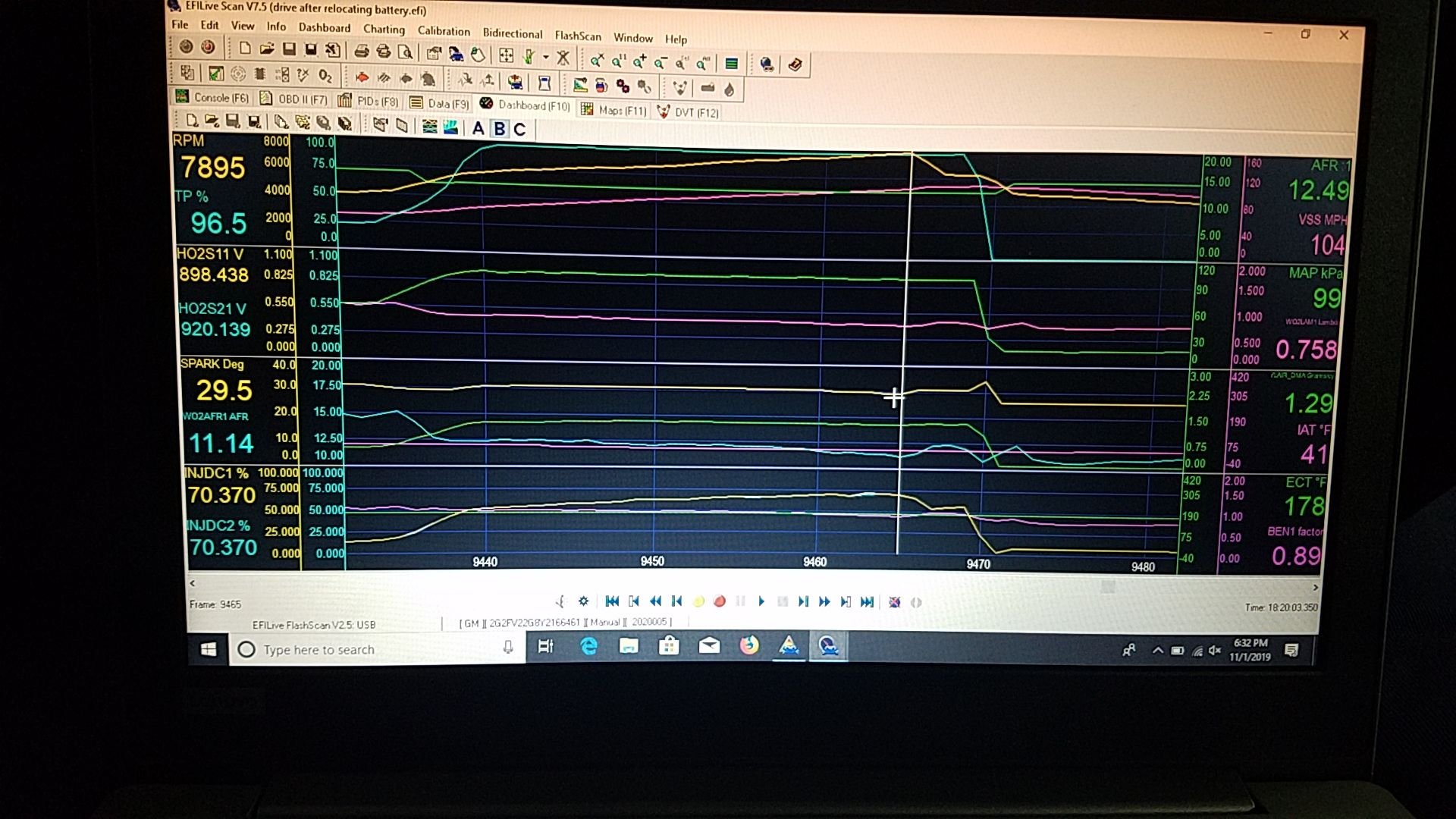

Pac1209x shimmed to within .05 of coil bind and fererea stainless valves. No sign of valve float at 7895rpm with yella terra rockers

all the rpm
