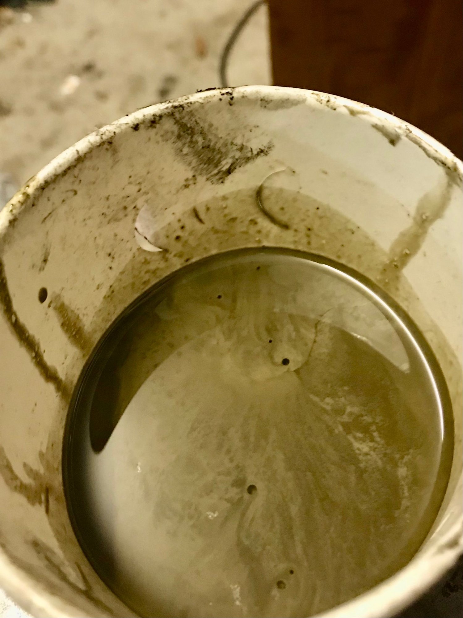

here’s a pick of the gunk you get in a good catch can setup. , after 2 months I got half cup, 80% is water, 20% oil… why would you want tht going thru your intake n thru your engine
