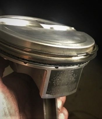

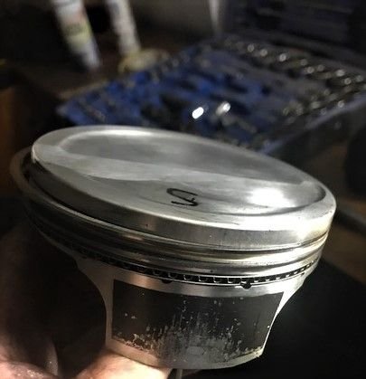

Im stripping the engine down so i can drop it to machine shop tomorrow and have keyway lifter bushing installed.
was very happy with how the pistons look after 40,000miles.
Very minimal wear on skirts

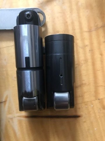

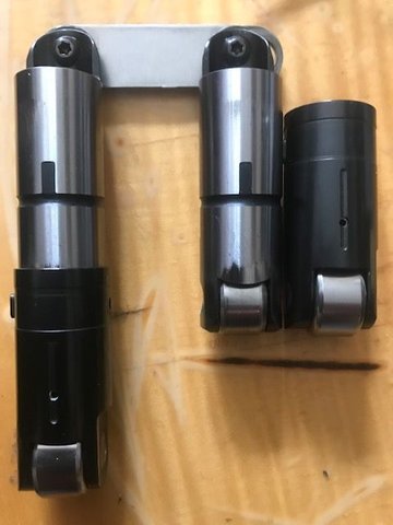

Few pics of the new lifters Jesel sayds with priority mains i may need oil restrictors. Why didnt my last lifters.crower, not ask the same , and wht will oil restrictors achieve?????

Yep, .937 and .850 wheel and before was oem . In the pic above the oem fits inside the .937
