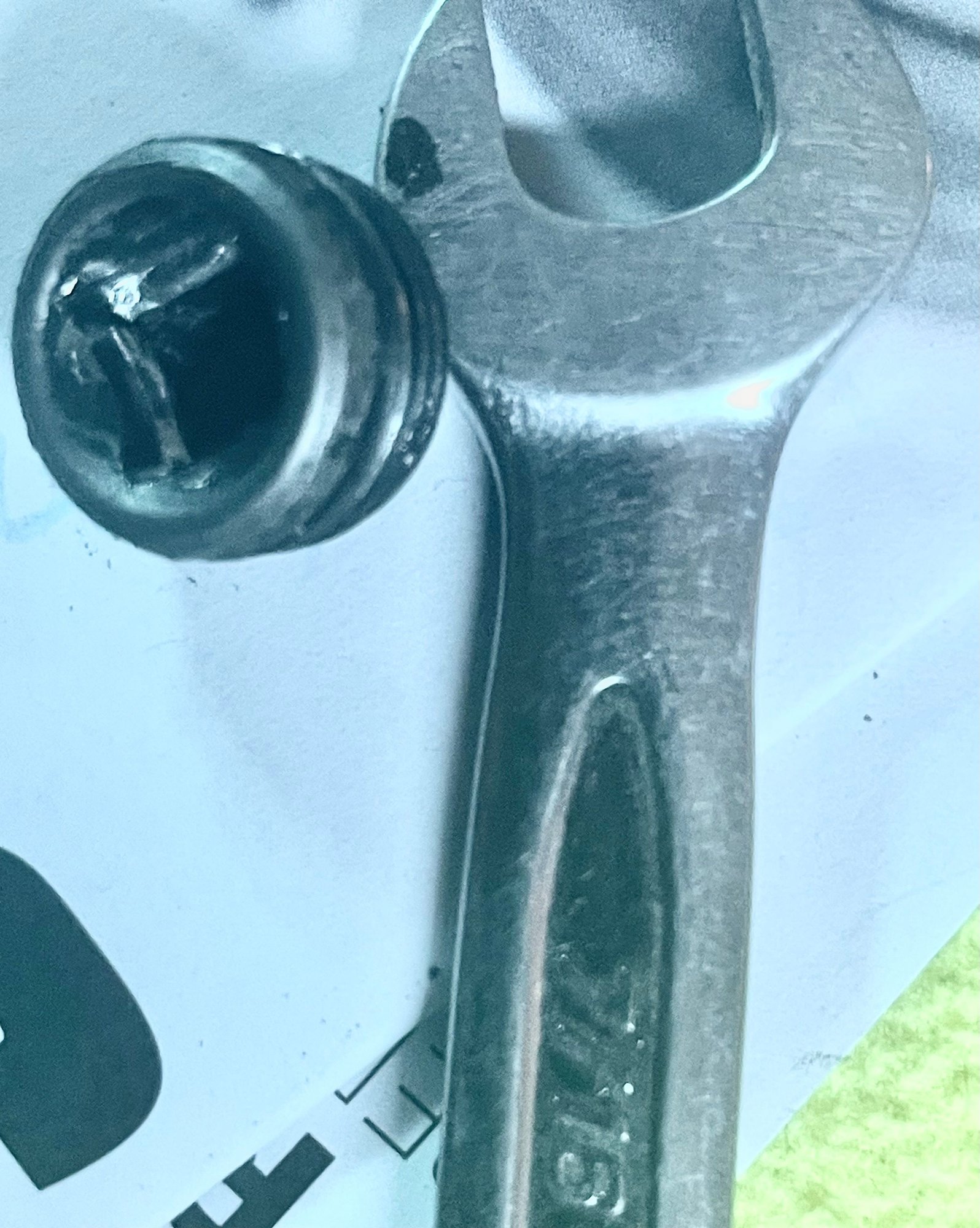

I have this little threaded plug leftover after putting engine back together
Any ideas where it goes.
in the picture it’s up against a 7/16 spanner to give an i idea of scale

Posts: 1,604
Likes: 1,085
Maybe pass head for the coolant temp sensor?
I thought that but it’s a little to big
Almost looks like an oil pump bypass plug that holds the spring and plunger in but I don't remember any coming with a square insert

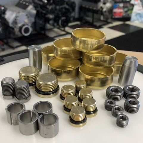

I found this on here
https://ls1tech.com/forums/generatio...ock-plugs.html
Its not a square insert, looks like insert was stripped and a 1/4 inch drive was hammered in, I can’t remember doing that though

Looks like it’s the same as the single plug on the right,
Mayb I should put my glasses on when I look again

There are no threaded plugs inside the covers as an OEM package…which I know full well Mickey yours isn’t exactly OEM. There are 3 threaded plugs on the outside of the block, but they have a lip on them for sealing…2 for oil passages and 1 for coolant. There is also another 17mm large plug on the outside of the block for a coolant passage plug.
Perhaps Mick your valley towers are threaded and plugged with 1/4” pipe plugs? I do this a lot for better oil control…
My guess is that it’s something already on the bench and got mixed into the parts lot accidentally.
The pic I posted above is what u get when you buy the lsx block , It differs from the ls?

It totally differs from an LS. I can’t help you there Mick. I’d pull covers and make sure your good before I went any further…

It's not the one on the front l/h lower side of the block? Side of block, not front like shown above. Main oil feed, typically blocked

I don't see a spot where it would use that style plug. As mentioned most have lip on them and a hex bit to remove them.

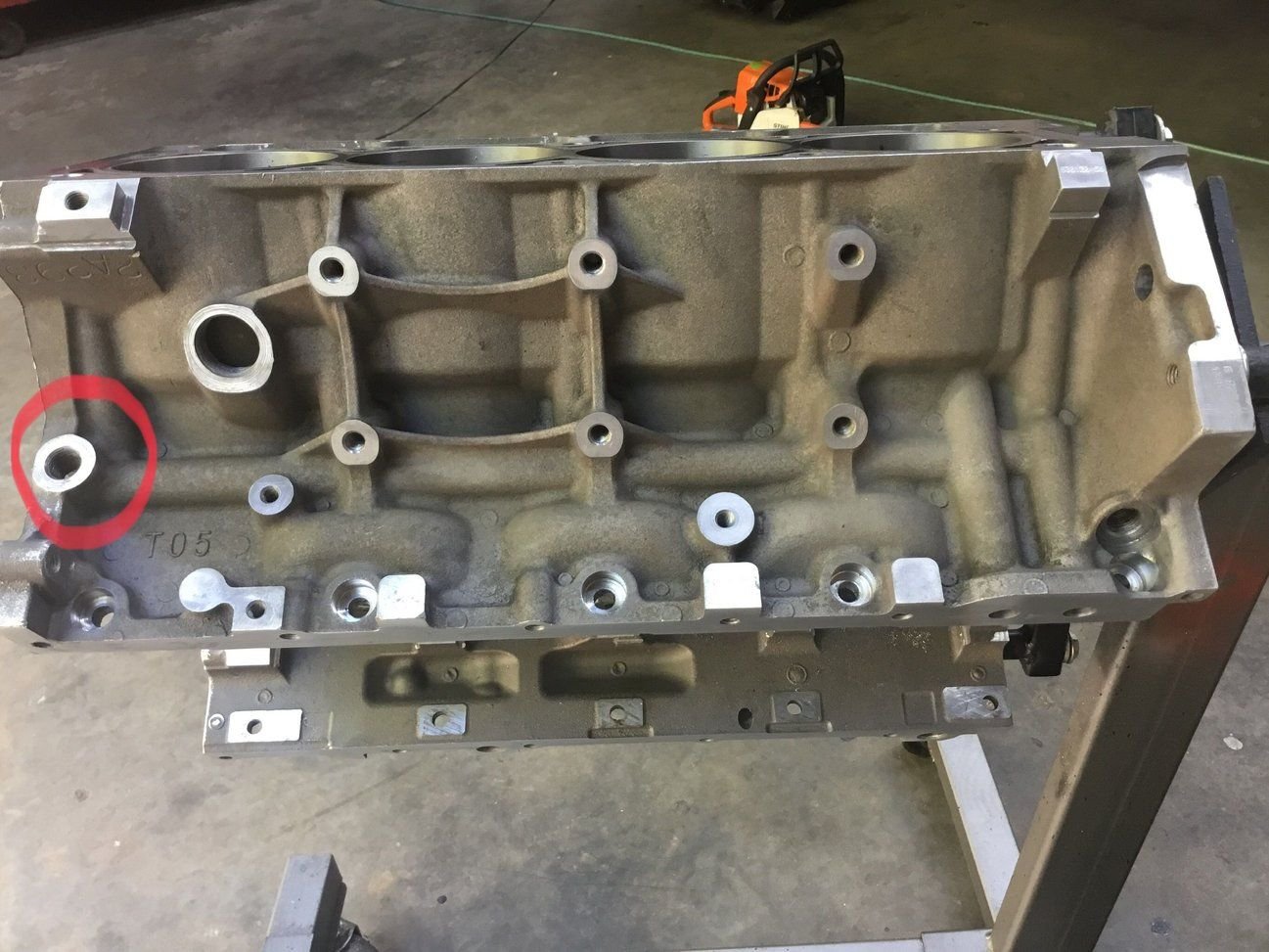

Is your front galley plug threaded?
What size do you think the hole circled is? 5/8?

It’s a 5/8 hole, and seeing tho I have a 5/8 threaded plug left over I’d say that’s where it goes.
The machine shop must hv removed it
