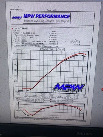

bit of an update..... Ive found the limit of the yella terra rockers... After the bolt snapped , got it up and running , then a few weeks later chewed out the bearings in one of the rockers...
I couldnt get an eta on the crower rockers so gave Mr Mamo a call and he shipped a fresh set of yella terra's for me...
i thought about the YT's, thinking whether i should get them , but really, after 30,000+miles, driving it hard, towing big loads, bouncing it off the limiter every time i get in the car, you cant fault the YT's. Yes i chewed up a bearing but after that many miles it would be on the cards for any brand of rocker to chew a bearing. The rest of the rockers were still good to go, no significant wear that i could see.
In november this year Tony will send me out titanium intake valves thatll swap straight in, ill put the crower rockers on at the same time, Tony also wants to change to a different valve spring which will have a bit less pressure on the seat. Even when i put the crower rockers in , ill stick to valve spring change once a yr, and rebuild the rockers every 20,000miles....

I’m curious about gain from Yella Terra to Crower rockers.
I wish you would change one thing at a time to find net gain from titanium valves, but even more so from Yella Terra vs Crower rockers.
There are quite a few threads blaming Yella Terra rockers for top end power loss. Unfortunately no net proof as people were doing other upgrades along with rockers before going back to dyno.
I’m still curious if your Crower rockers will be 8mm or 10mm bolt style.
If Crower doesn’t offer 10mm bolts, I will not upgrade MMS TFS heads to 10mm style when time comes, because I plan to use Crower rockers instead of Yella Terra.

Ive read most of the threads blaming the YT rockers or Mamo heads for any engine woes. The funny thing is none have made any significant gains changing heads or rockers, most lost hp.
My limiter is set at 7200rpm and I’ll bounce off it everyday. It’s always revved smoothly to that
when I broke a spring, which damaged the cam that wasn’t the heads or YT”s fault, was my own, to busy building holiday shack and not keeping up on the maintenance. The bearing going is just one of those things. I’m pretty happy really, after getting so many miles out of the setup .
Also I discovered I don’t hv the 10mm upgrade, so no problems using crowers.
what I’ll do is when I put the new springs n titanium valves in I’ll dyno test with the yt rockers, then change them out and run it up with the crowers.

Following this thread it is clear you pushed all parts to the limit.
I spoke with Tony regarding Yella Terra rockers. I don’t believe they are responsible for power loss at the upper end. 10mm bolt upgrade add some stability.
That said I’d like to see how Yella Terra will do against Crower rockers.
