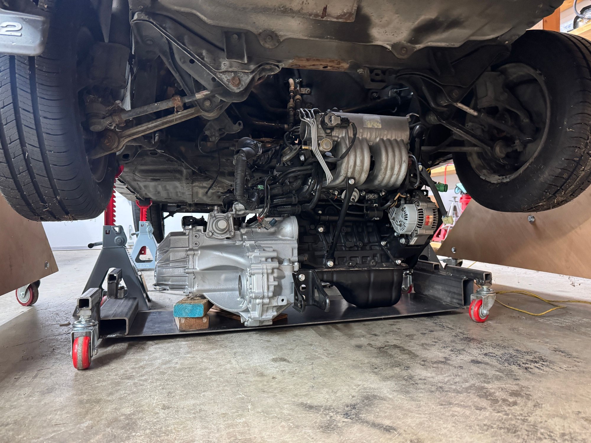

It may be a while before it's running again, I am currently working on an '89 Toyota MR2 that belongs to a friend. As it turns out, I shouldn't have signed up for this. It's taking waaayyyy too long. So I made myself a rule that I can't work on the Miata until the MR2 is out of here. I expect to be working on the Miata in early Spring.
Getting ready to stick the built (forged pistons, rods, crank, mild cam) engine and 6 speed transaxle (5 speed is stock) back into the MR2.

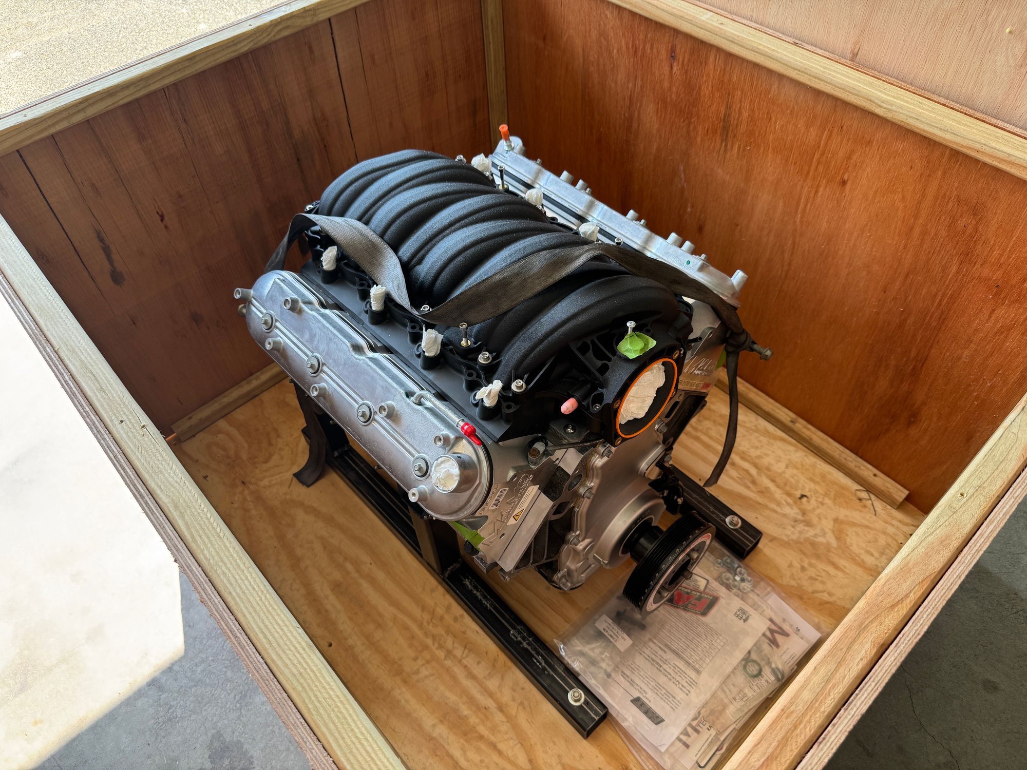

The new engine got here today … it will be a while before I get to it.
Old Aug 26, 2025 | 08:25 PM
  #275
Posts: 7,828
Likes: 5,174
I’ve seen that somewhere before…glad it made it Mike. Gonna be a freaking rocket!
What are the specs of that motor? Sorry if I missed it earlier in the thread
