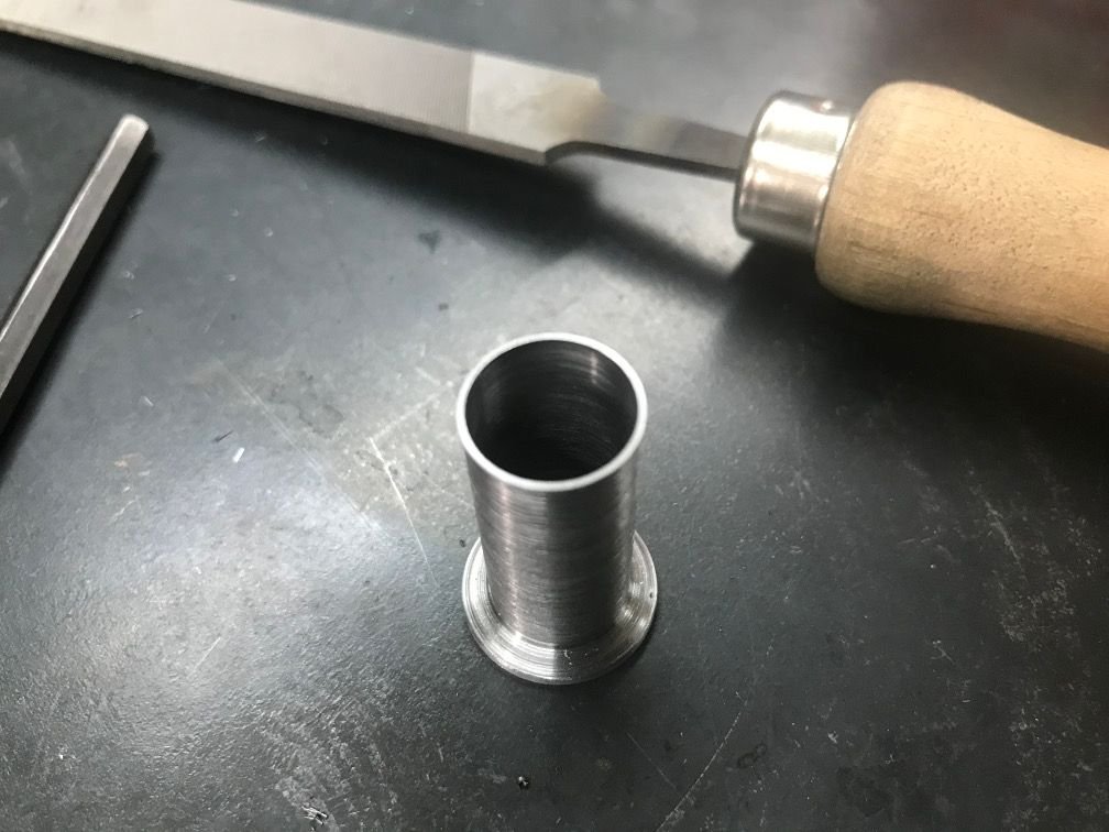

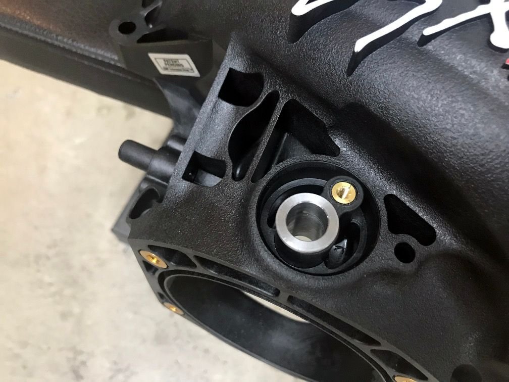

Here is my mea culpa. The FAST intake manifolds require drilling for the MAP sensor. I was worried about drilling at a bad angle, so I put it on the mill table, and used the mill as a drill press. I should have been more worried about other issues. The drill grabbed (I started with 15/32" ... first mistake) and the manifold climbed the drill and ovalled the hole (holding down with one hand, second mistake).
I made lemonade by fabbing up a bushing on the lathe. Those of you without a lathe might do the following ...
Drill using a hand drill ... if it grabs, you'll feel it instantly, and be able to get your finger off the trigger faster than I was able to shut off the mill. Second, start with a relatively small drill, and gradually increase the size. I started at 15/32", the finished size. That is most likely to grab. By making small jumps in size, it won't be as likely to grab. I really think the instructions should say something more instructive than just "drill out to 15/32" ... but maybe I'm an idiot. :-)

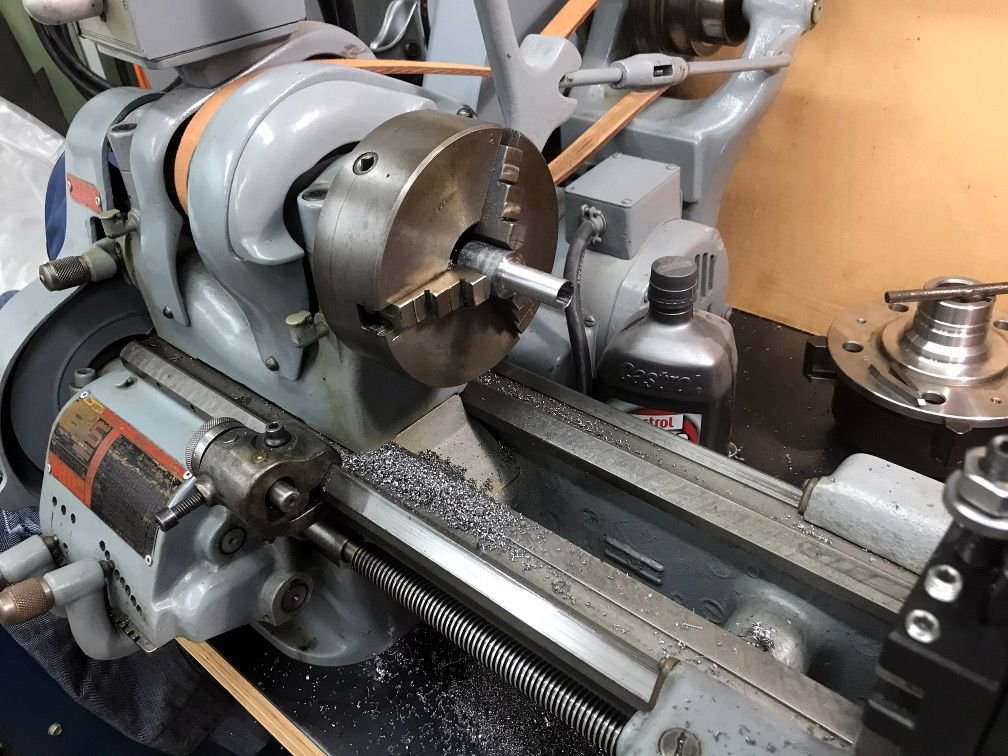

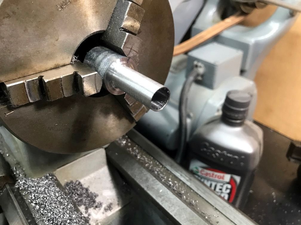

Here's the lemonade I made on the lathe. I drilled my manifold oversize (33/64") and then put this .507" OD bushing in with epoxy. It will be easier for you to do it the way I suggest.
A lathe is a handy thing...
I turned this down quite a bit ... supported with the tailstock (not shown here).
This is the top of the new bushing...
And this is the bottom.
Installed with epoxy.
