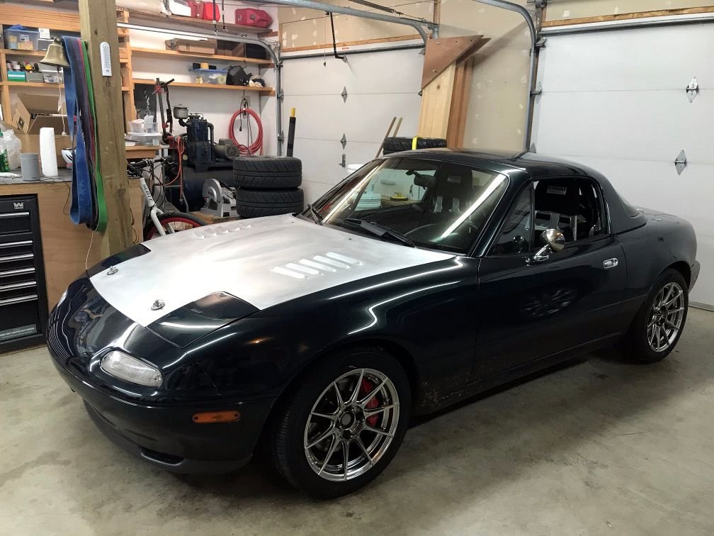

Still on a bit of a SWAG tune with regard to idle stuff and injector data, but it runs. Now I need to start tidying up the tune and various loose ends.
It drives much smoother on the milder cam, and the clutch/flywheel (RPS BC2 Carbon clutch with aluminum flywheel, 25# total) is plenty heavy enough to get the Miata rolling. Haven't driven a stick in 10 months, so I'm a bit jerky, but in two days that will be all gone. :-)

Update on tuning progress. I'm just working on driveability now, getting the MAF and VVE table right, etc. The streets are too slippery here in the PNW to use any of the new power.
Ever since this engine was in the car (both with the original GM Hotcam, the subsequent GM ASA cam, and the MAMO spec cam), it's had issues with the low speed driveability between say 1200-1800 rpm in 1st and 2nd. Parking lot creeping ... it would buck and surge like crazy. I've been reading lots of posts on various forums, and it's much better. I keep pulling ignition timing out of that area, and it keeps smoothing out. I've also messed with the O2 sensor modes and injection timing, but ignition timing has by far the biggest effect on this engine. I'm very optimistic that I'll be able to get it to "drive like stock (TM)" with some more attention to this. Since it's my daily when it's running and the weather isn't awful, that's the goal.
Today it got the winter tires, 195/50R15 on 15x7 wheels. I'll use these for road trips in the summer, too.
