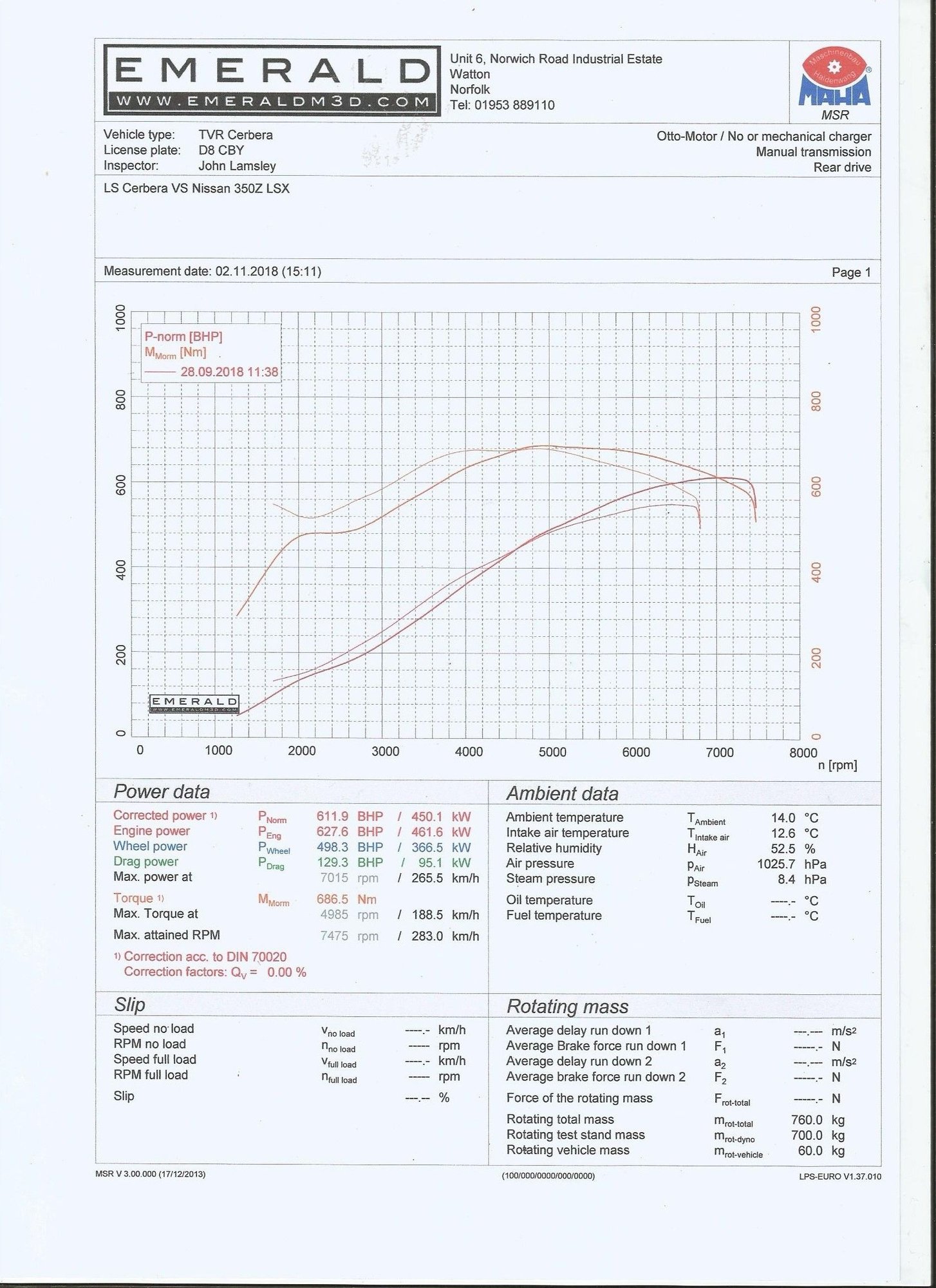

I am running AFR 245 Cathedral heads, I have Kinsler ITB's so Im not going to junk those! My engine has a peak of 627bhp (crank) @ 7015rpm, and was still making 610@7500rpm, so holds on well, I only have inch and three quarter headers but its tight with those, and that i think is the bottle neck if anything. I am in the UK so our dyno figures are very different to you guys, but a 454LSX with a FAST makes 550 at the crank on the same dyno. Mine is a 419CI. You can see the extra cubes on the bigger motor down below then my engine keeps going.
