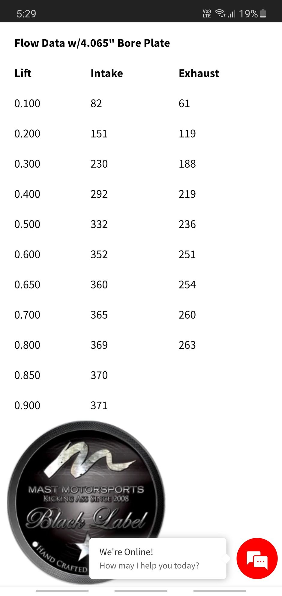

Do you guys think a mast black label 265cc LS7 head would do really well on a 427?
designed for a 4 inch bore so I'm thinking it should be a stump puller and make strong torque everywhere with a 4.125 bore.

I would like to see some flow numbers on them. Mamo 265 will flow 410 at 700 lift. There are heads bigger than those that do not reach that number or reach it over 800 lift.
If they get into that territory at 700 lift, I say give them a go.

Mast 265 is small 2.8 to 2.9 CSA and you'd get just what your thinking, my Rowdy heads flow around the same 370+ on a 4.00 to 4.60 bore. Now if we use a test bore of 4.185 bore I could expect to see 390cfm - 10 to 15 more cfm. I was told with 379 cfm I get at the most 390 ish on a perfect day, using the bore listed. Bigger the engine the more area or CSA is needed. The Mast 285 head is more like 3.1 - 3.2 CSA head. .....
Darth: That's what gets me .. with CSA vs CC, Mamo heads say 265 cc which tells us Nothing and Every Head seen or known of that's a Ls7 has a runner cc larger than 270+ to get the same 400+ cfm some need 2.250 inch valves. There isn't a head out that does these numbers with that amount of CC look it up.... WCCH, MAST, Brodix, TSP, FED, BES, CID Greg Good heads.. etc.

Yeah porters castings. Which means the holes start really small and the porter can do pretty much what he wants.
I hear you man. And that is exactly why I like them. The heads I bought from him hit 408 at 700 on a super flow 1020. 2.230 valve.
And last time I counted tony heads have NA records on 19 dynos. Twenty if Mickey has a record on his with that 454. Do they are not paper tigers.
their 255cc ls3 heads flow better

Port CSA is larger I'm willing to bet.

Ls3 heads usually are so should be better in 427
