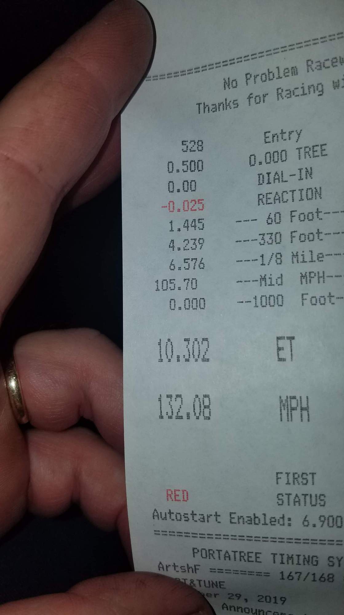

Looking over that list of cars im not mad at all about this at 3900lbs race weight and ported 823 castings

Aint Skeered~ what tranmission?
Old Jan 20, 2020 | 07:45 PM
  #129
AINT SKEERED's Avatar
Joined: Apr 2002
Posts: 3,990
Likes: 361
From: Albany La
4l80 with rmvb and transbrake. 8" fti converter

Your car just needs Jenny Craig for nines
I'm trying on both the car and my self.

Similar combo to mine.
Pretty impressive time.
And that's just factory heads with a port job.
Damn.

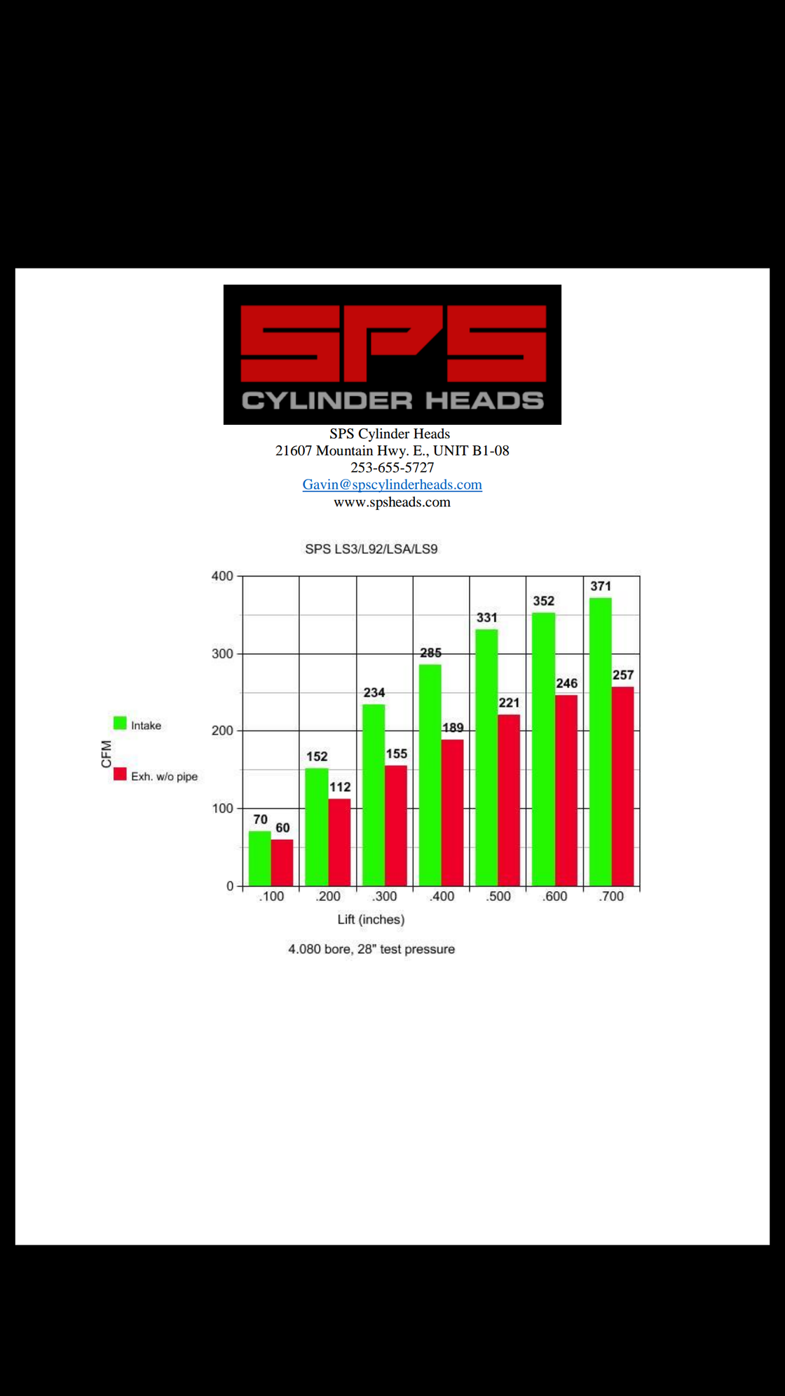

and they are not hogged out heads either

Good flow numbers.
What cc are your intake runners?
That test is on a 4.080 bore too.
Smaller bore will have less flow.
