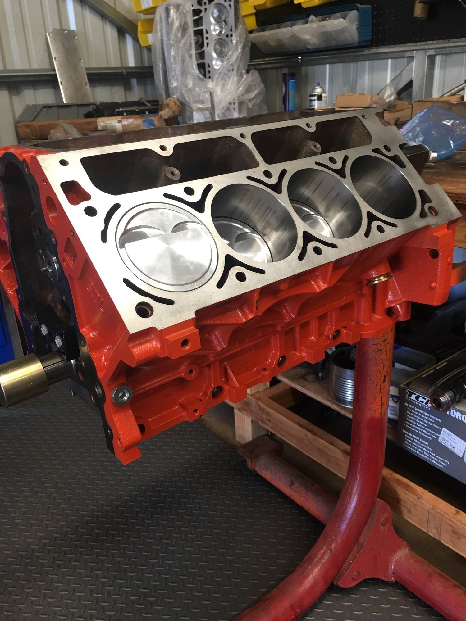

Can someone tell me whitch iron block can be bored to 4.065 (stock LS3) or if there is a aluminium block that can.
I have a rotating assy with pistons@ 4.065 and tried them in a brand new block but clearance was a little to sloppy, and I don’t want to sleeve it.

I built a 426 last year to resell that was 4.065 X 4.100 using an LQ4 block. As far as I know it worked for the guy that bought it, I never heard anything from him or his friends. I did sonic check an LQ4 block years back and was a bit surprised to see how thin the cylinder walls were on non thrust surfaces ( front to rear) but they are ok to bore .060 so what’s another.005”? Iron LS3s are done More often than you might think. The 4.100” stroke crank had the Manley piston skirts hanging out the bottoms of those bores quite a bit.

Thanks a lot. I guess the LQ9 is pretty much te same block. Am I right?

Sonic test .... leaves no question.

LQ4 and LQ9 are the same block.

You have a stock LS3 block and the pistons are too lose? Any reputable machine shop would advise you to have the block sonic tested before boring to that size.

I bought a new LS3 block for a rotating assembly I already have, but the piston to wall clearance was a little to loose so I ended up using the block for a 416 build. Now I’m looking for a block that can be bored to 4.065 so I’ll get the clearance right.

A new LS3 block is 4.065 bore and if the pistons you have require a 4.065 bore then why is PTW too loose?

When you mic the pistons what are you coming up with for measurements?
