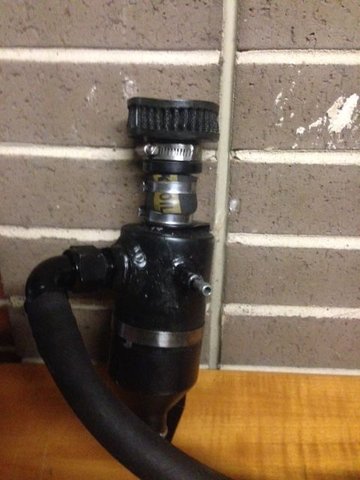

The best kit by far is mighty mouse, i had the same problem with communication so built my own . If you dont want to build your own kit keep trying to get onto mighty mouse, if you can build your own kit refer back to my previous post on how to run it, ill say again one way breather is the key ,also pcv valve.

I think the guys on the other forum are experimenting and havnt got all data points lined up.
the mm can has a pcv valve and also one way breather. If your road racing your at wot 50% of the time so lots of crank case pressure and if there sucking huge amounts of air in it has to go out.
I have no maf,and my set up is--------- 3/8 pipe after filter to (U.S) drivers side head(clean air in)------block off passenger side valve cover ---------dash30 oil fill to catch can------3/8 pcv valve(tapped to can) to valley cover---one way breather to top of can-----
When cruising This way you have clean air gets drawn into engine ,mixing with blowby, then drawn into can, oil mist/water condenses, leaving clean air to go out thru pcv to valley
At wot blow by increases to the point where the 3/8 pipe sizes cant evacuate and the one way breather opens venting to atmosphere. Even with dash 30 pipe going out to can i still get a drop or 2 of oil due to reversion back up clean air pipe--------In a month i may have 3/4inch oil/water in my can and intake manifold is absolutely clean
