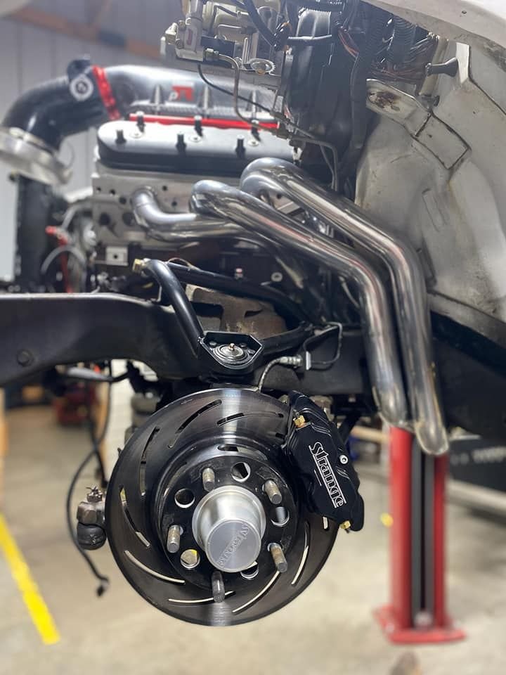

Default HPR 468 almost ready to drop in:)

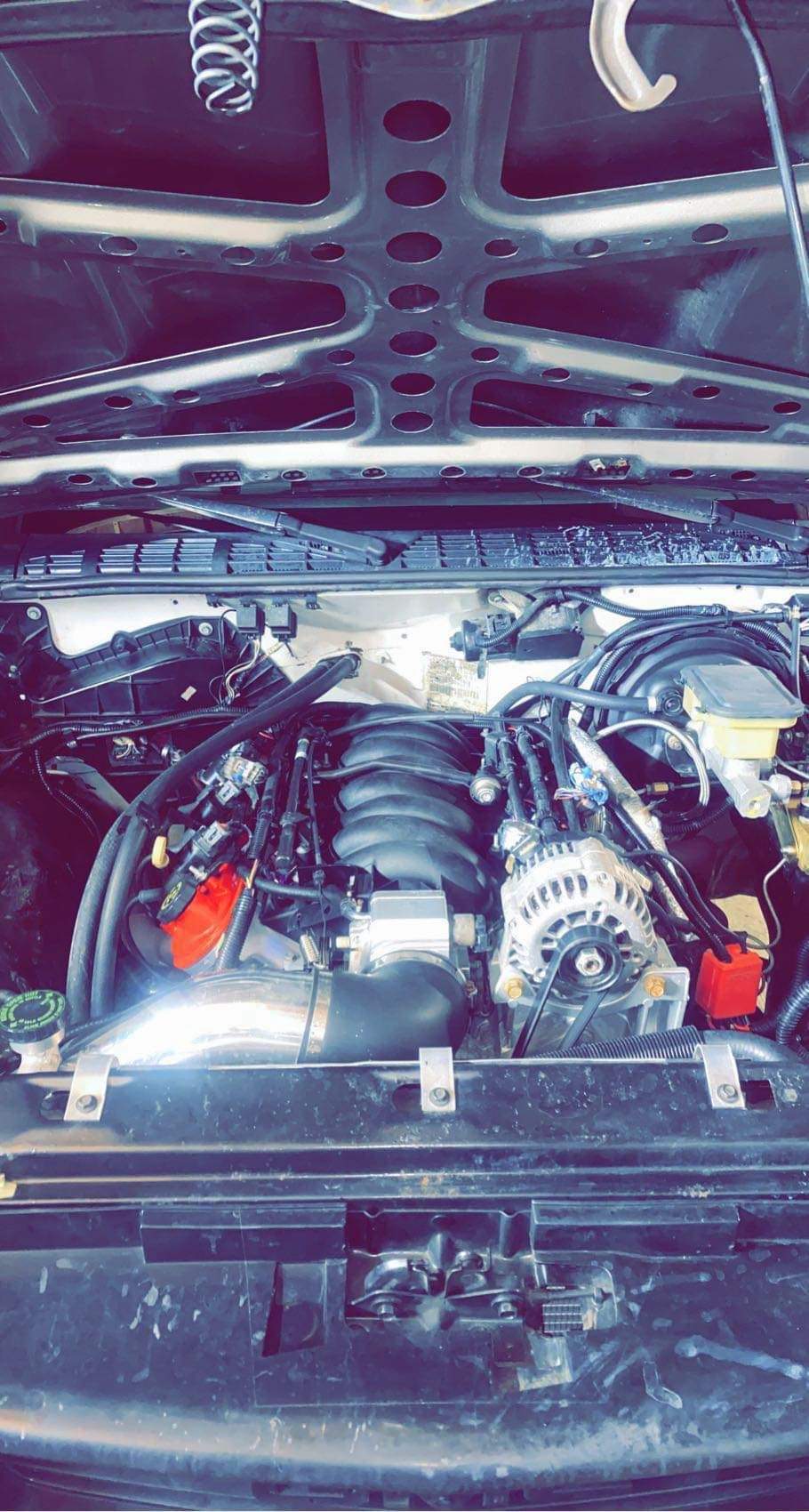

Looks great! you will love that intake, I run the fast version on my 455"

Mamo heads ... that's never a mistake.
More info on the motor? What's it going into?
468 from hpr, 13.5 compression, hydraulic roller cam .675/.675.=262/276 duration =114 +4 lobe seperation, Performance design intake, 105 holley throttlebody, Tony Mamo LS7 heads, 1.8 yella terra rockers with 10mm upgrade, Johnson lifters. It will be going in the Happy Hooker

Great cam specs.

That is a lot of displacement from a standard deck block... wow. Should be violence in action with that light, little truck.

I assume NA combo? Looks like a solid set up and enjoying seeing some cubes! Push that truck in the 5s

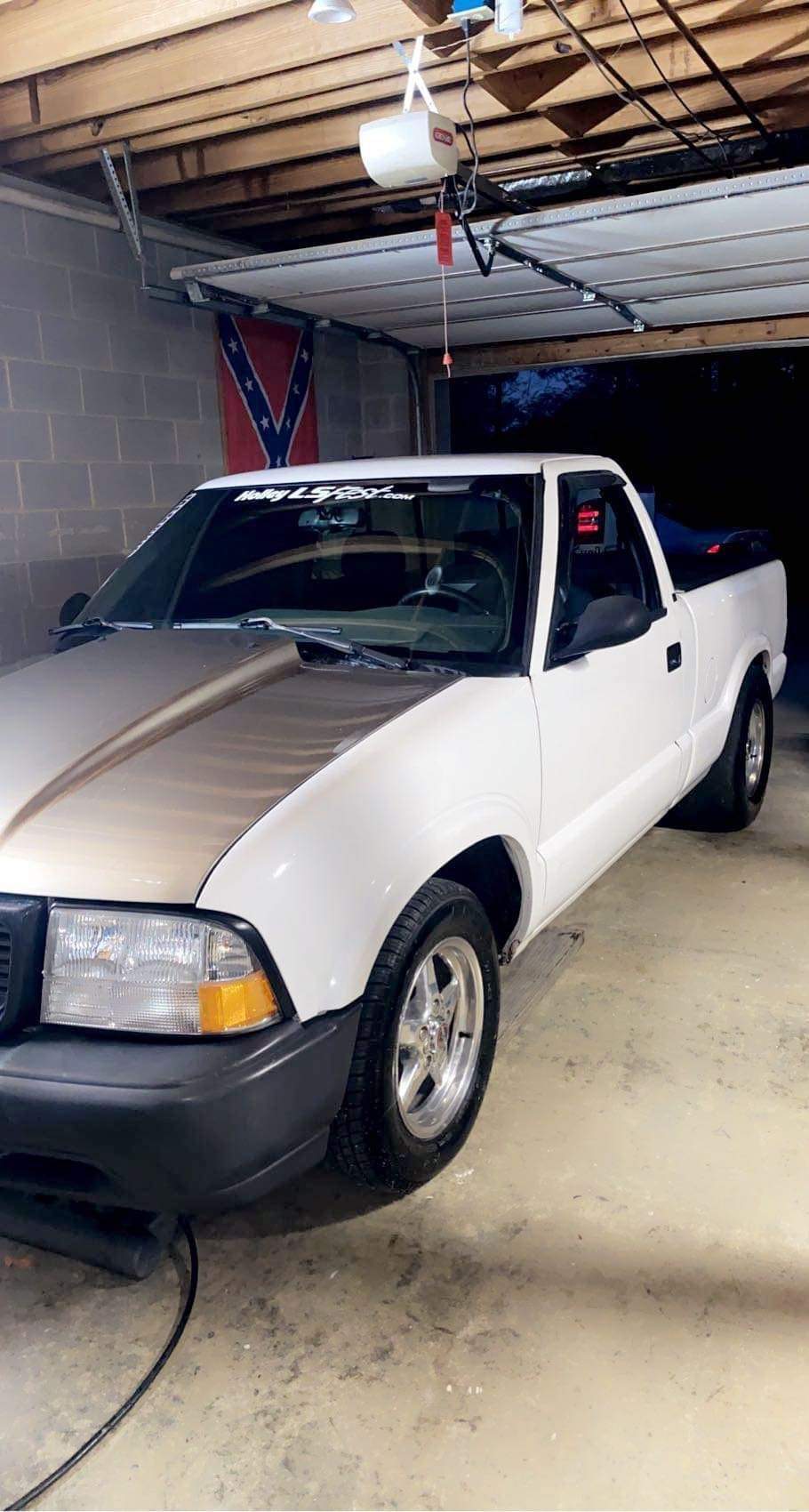

I haven't seen wheelie bars in any of your pics!!!

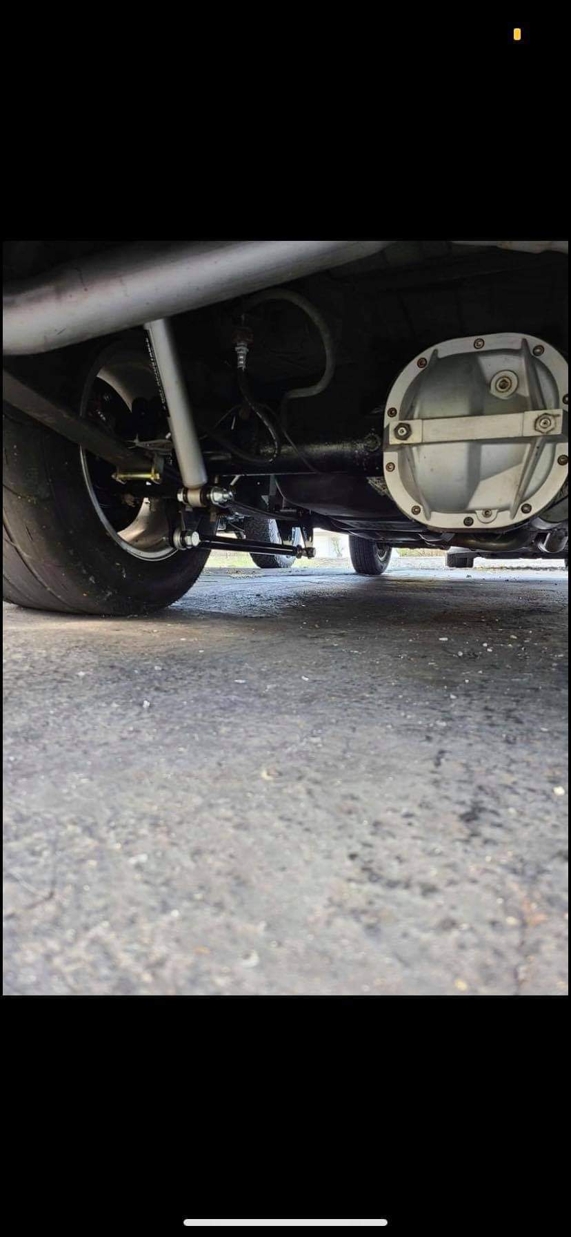

Lol....no sir, lowered starting line ratio a bunch, installed travel limiters.
