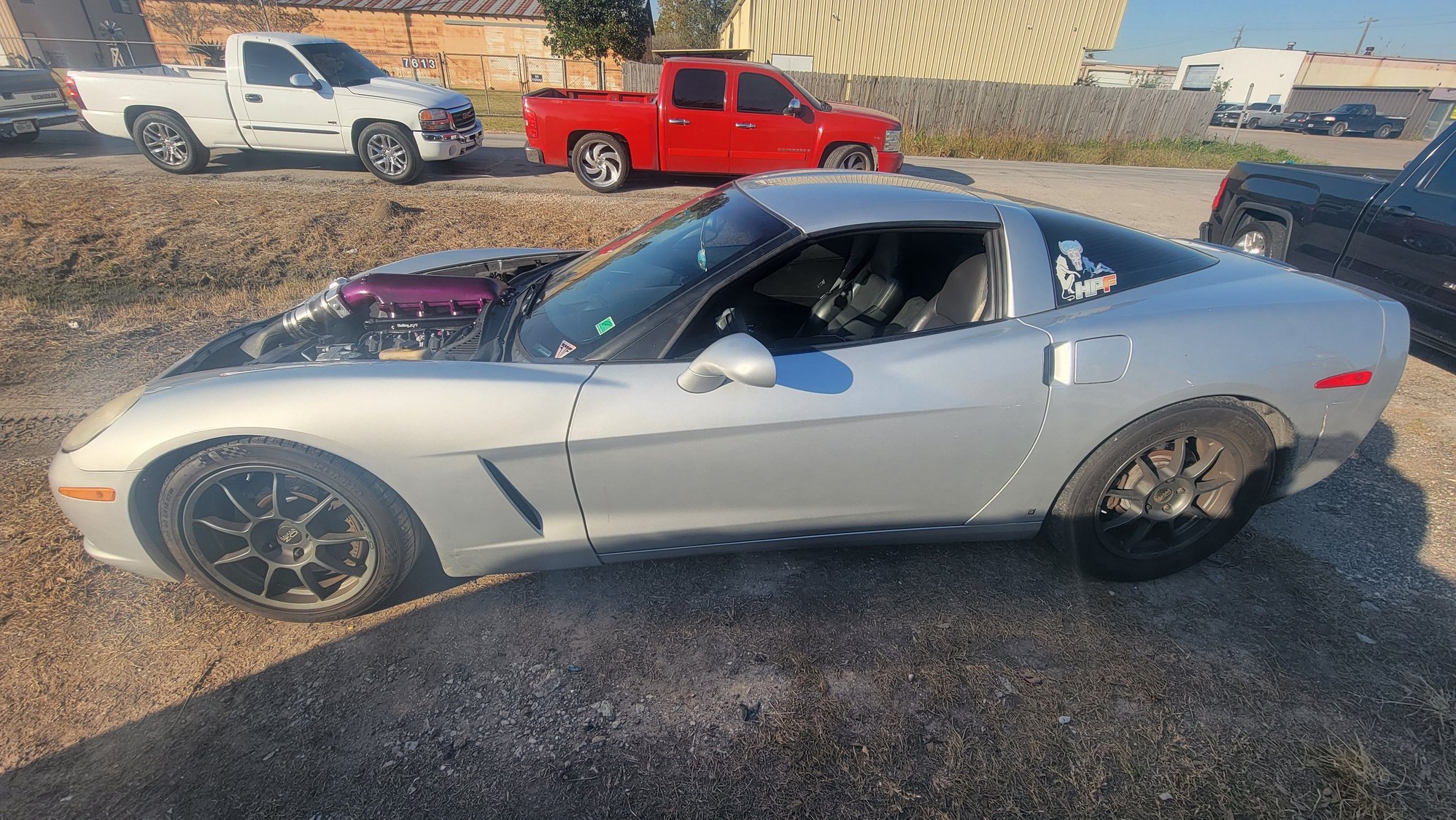

Nothing a Sunoco hood wouldn't fix.

I'm cutting the hood to have the highram stick out of it . That's why I painted it purple

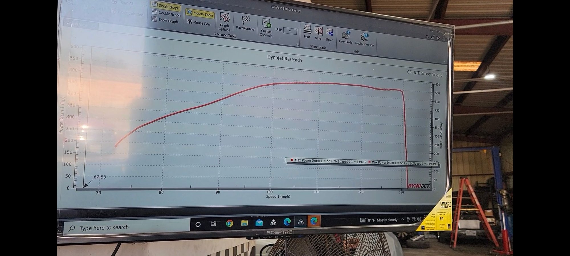

Well .. We only got to make one hit totally ran out of fuel pressure lol But 140% duty cycle only 16* of timing and 13.9 afr made this 😳 Only pulled it to 5800 rpm aswell Cesar is 100% confident after we do a pump and 80 lb injectors this week it's going to make 600-620

650rwhp with meth.

Originally Posted by jayyyw
650rwhp with meth.
Yep I think so too

Cesars dyno reads pretty low compared to othes actually lol my camaro always was like 8% higher on other dynoss vs cesars
