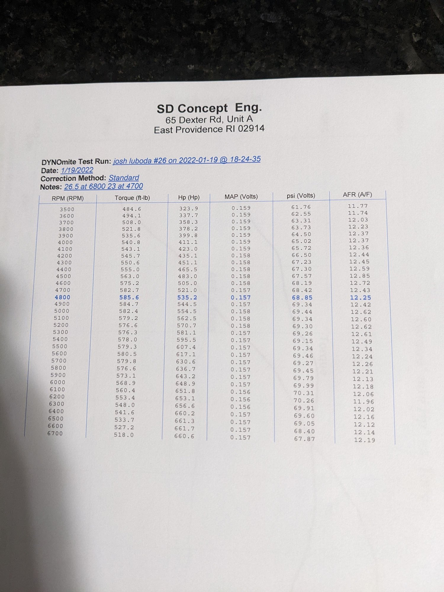

Figured I would add the spread sheet, over 500ft lbs of torque across almost the entire run! As you can see she was pretty happy with everything during the run. I believe we commanded 12.5 or 12.8:1 for A/F and it was at 26.5* of timing. We tried 27.5* and it lost 8hp up top.

I dont know why people would question that, pretty typical for a solid @410" street NA setup. Equivalent to 540-560rwhp in a manual car, 485lb ft of torque

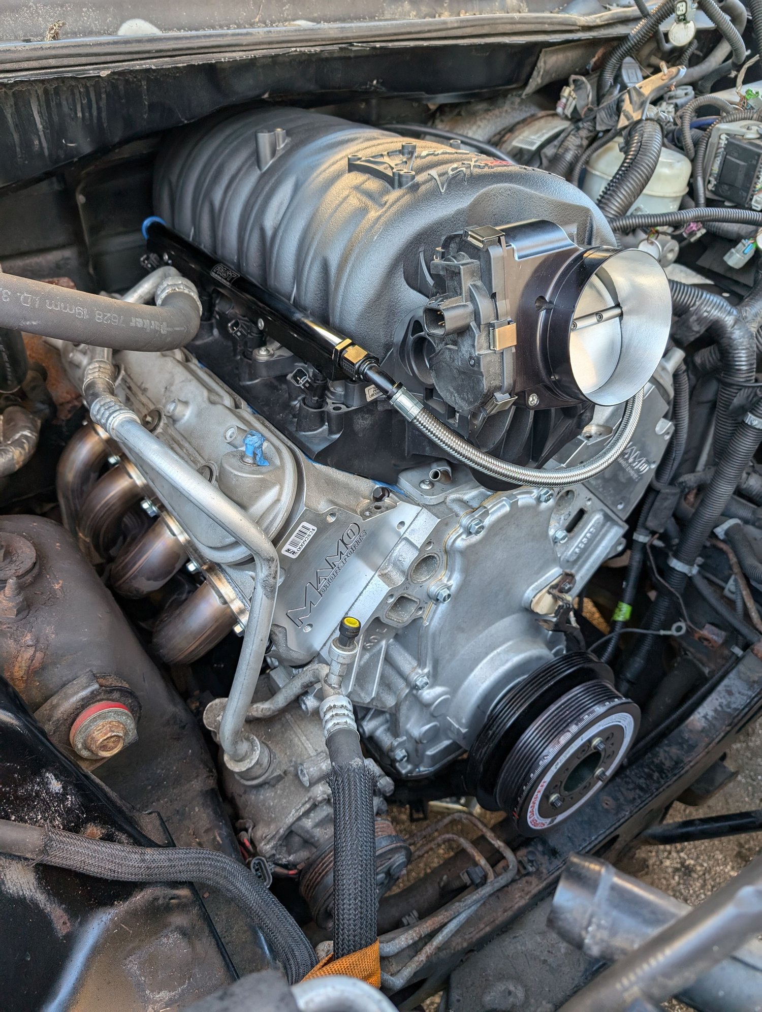

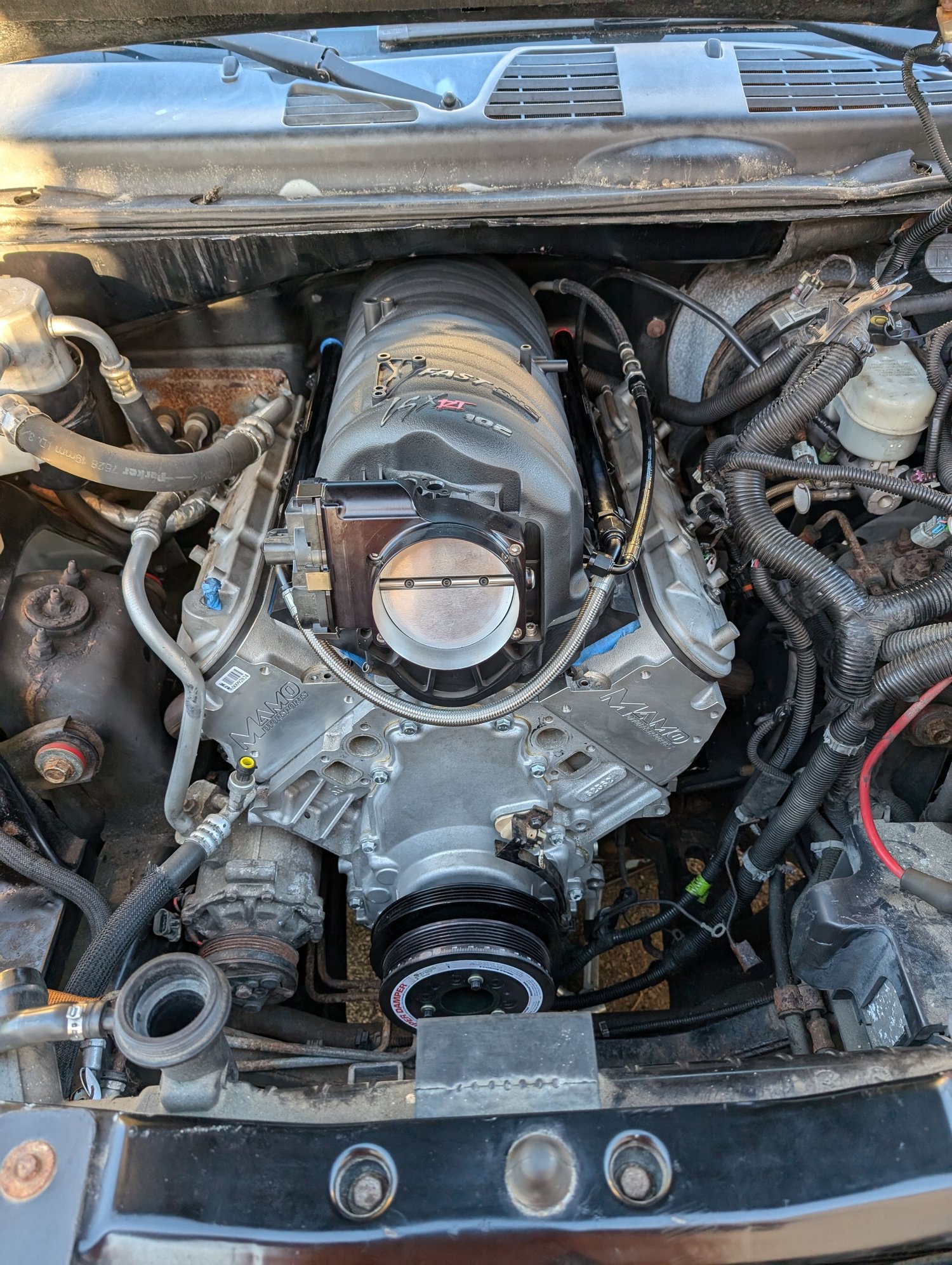

Well it's been a long journey through life. Between personal and health reasons everything has been on the back burner but I am finally in a place where I am able to work on things. Been a tedious process the past few weekends but I am just about ready to fire the engine up in the chassis for the first time. Hopefully this weekend if I can squeeze some time in around my son's hockey games. No changes have been made since the last Dyno session aside from redoing the rocker geometry and putting in some much bigger and stiffer pushrods from Manton. The 662hp number was made with my chassis headers and accessory drive so I won't be losing anything from those. I have a Circle D 3600 265mm converter behind everything for now.
Old Sep 29, 2024 | 04:53 PM
  #100
84ta406's Avatar
Joined: Feb 2009
Posts: 283
Likes: 191
From: Worcester, MA
Well I got it fired up, tried to idle for a second and then the RPMs took off like a freight train so I killed it when it hit 3500 rpm. I'm thinking it has a big vacuum leak, just not sure where right now.. going to pull the intake and put some RTV on there since I had to split them last week to drill out the rear MAP port. That's about the only thing I can think of. Of course my laptop died after trouble shooting my MPVI2 all afternoon, so I didn't get a chance to log it. But she did sound mean! Lol
