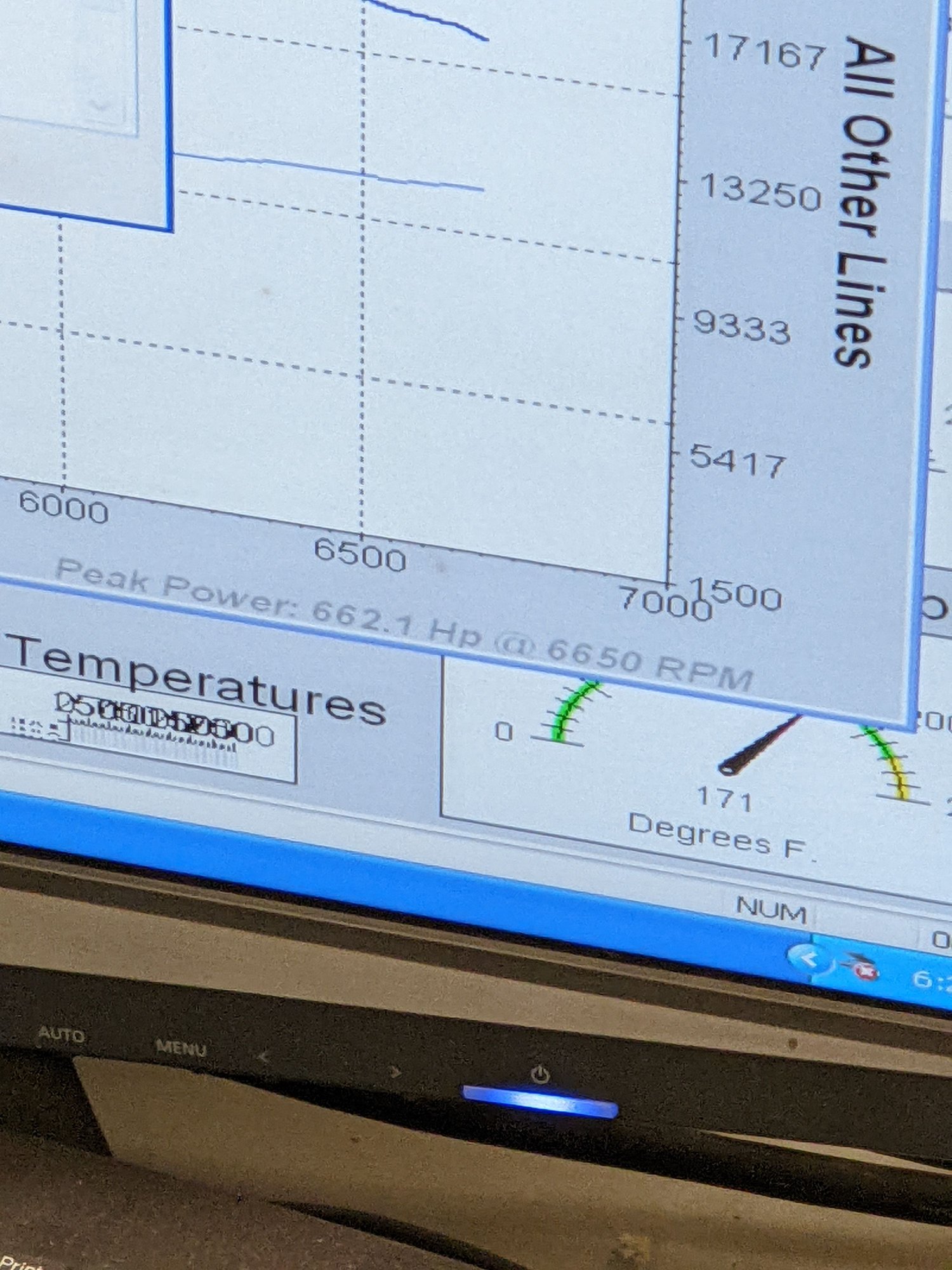

Old Jan 19, 2022 | 08:00 PM
  #80
84ta406's Avatar
Joined: Feb 2009
Posts: 283
Likes: 191
From: Worcester, MA
Well I had another shop take a look at her like mentioned before, found a couple small things but then we hit the dyno today and boy was I surprised. The big changes were this time we were using ARH 1 7/8" TBSS chassis headers and had some accessories on the front of the engine. There was hours spent dialing everything in, working up the timing and A/F ratio as well. It was mentioned a couple times that the first dyno "might" have been a little happy but I think that's been debunked now. Anyways here are the results: 662.1hp@6650 and 585.6tq @ 4800
