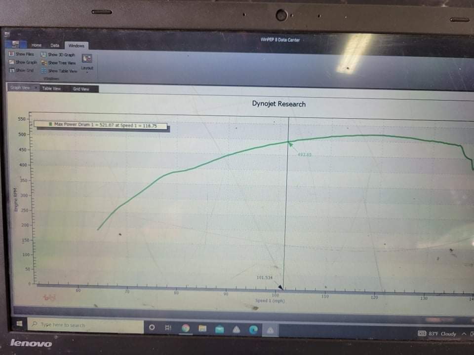

Old Jun 14, 2021 | 04:04 PM
  #137
Mavn's Avatar
"I MAID THEESE"
Joined: Jul 2011
Posts: 2,757
Likes: 701
From: Houston
The curve . Flat as fuhhhk
  #138
01CamaroSSTx's Avatar
Joined: Feb 2015
Posts: 6,014
Likes: 2,294
From: Conroe, Texas
What's your torque at 4,000 Mavn? I'm thinking 490 plus!
Old Jun 14, 2021 | 04:09 PM
  #139
Mavn's Avatar
"I MAID THEESE"
Joined: Jul 2011
Posts: 2,757
Likes: 701
From: Houston
Dyno doesnt read tq, so not sure.
