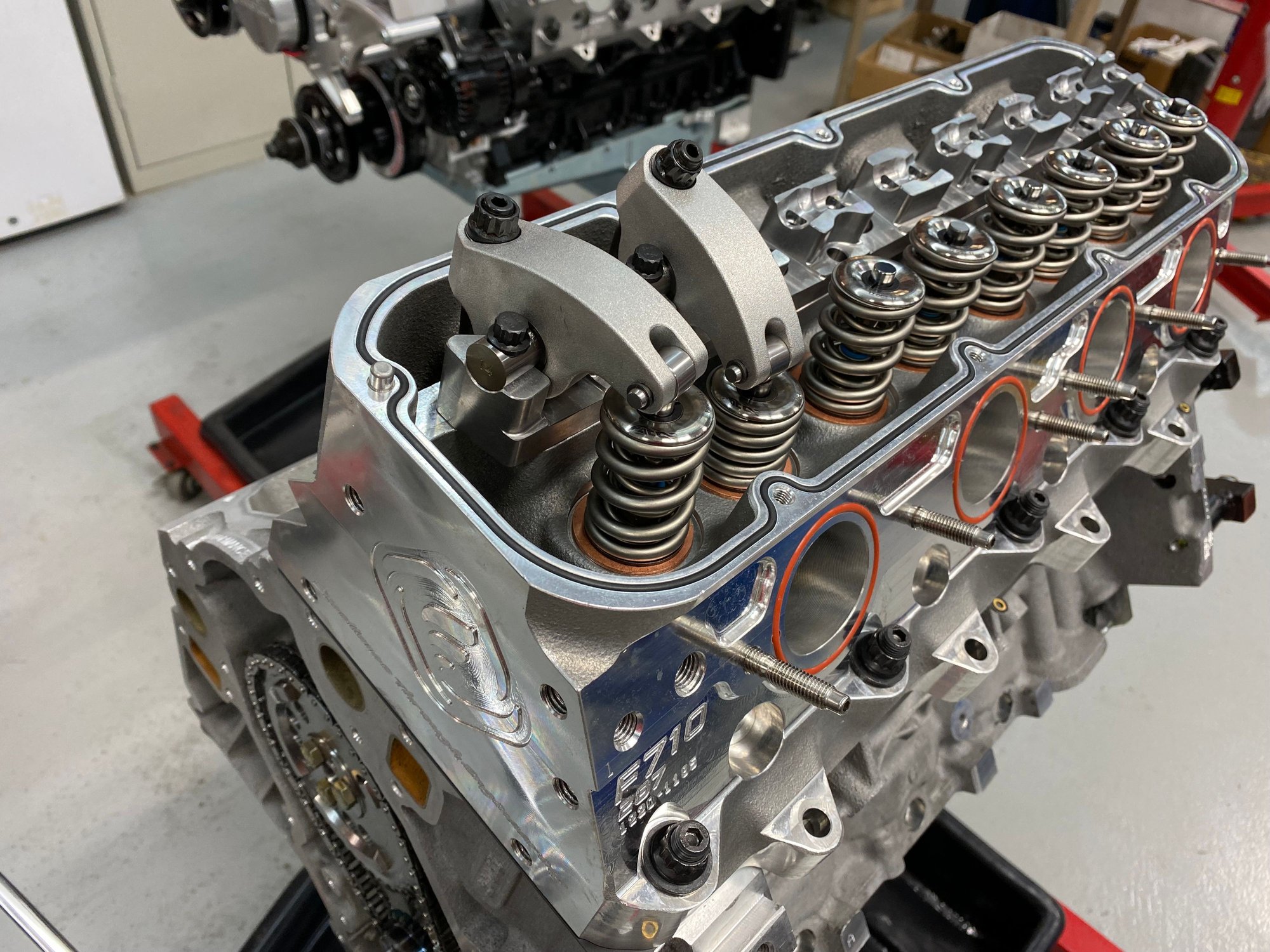

Hoping to be on the dyno in a couple of weeks.
*Darton sleeved Gen IV 6.0L - 4.140" bore
*Callies rotating assembly - 4" stroke
*Wiseco custom piston (+5cc), 13.1:1
*Cam Motion solid roller (smallish 267/277 113lsa .748/.731) - fast bracket race
*Morel pro series lifters
*Frankenstein F710's
*Jesel rocker shafts
*CID 4.5 intake
*Sullens 1050 E85 Dominator
* 2" stepped to 2 1/8" header

They will do all of the lift, I can tell you my cam has a ton more lift, Same head and rocker setup

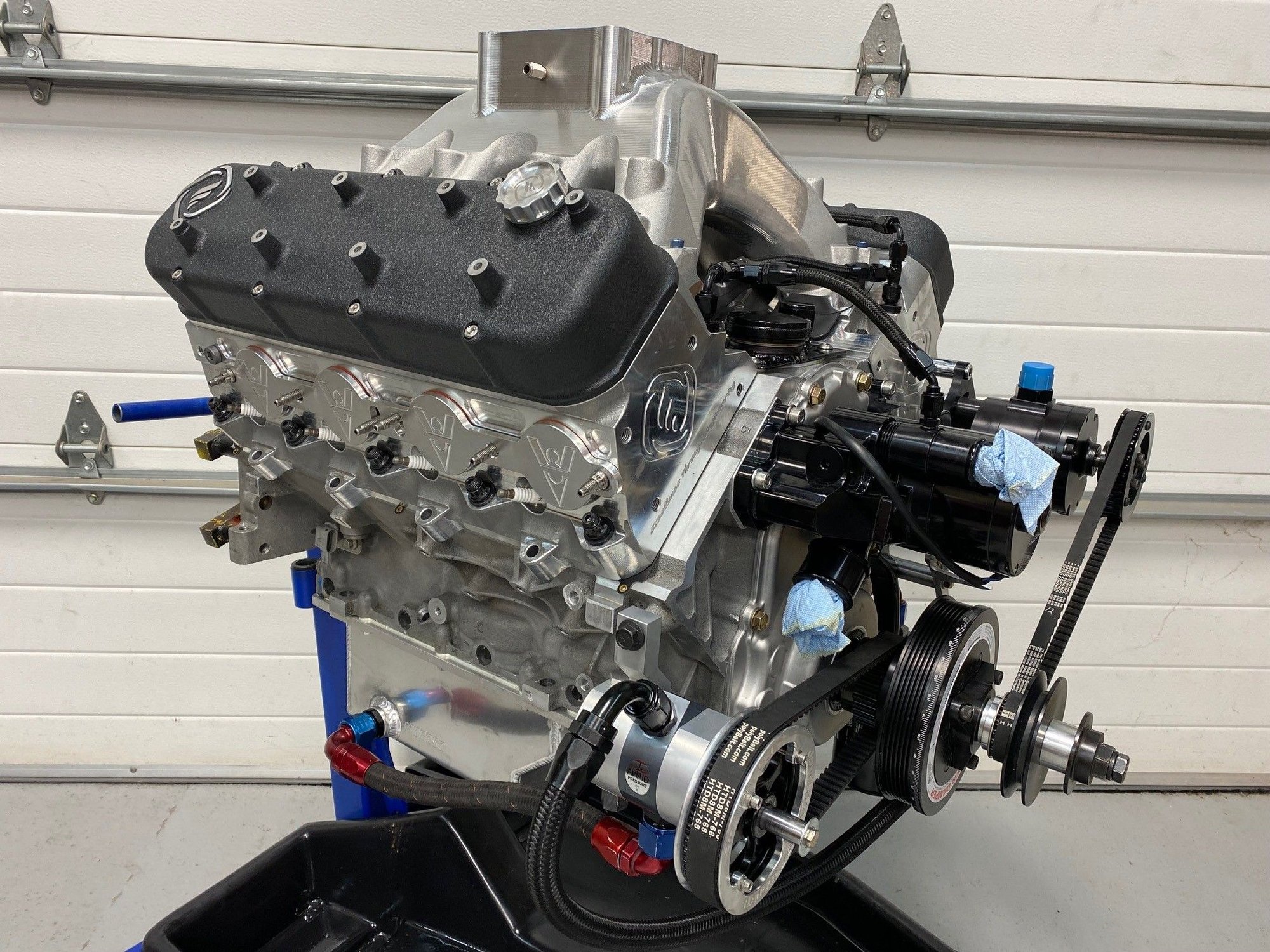

No, no spray, fast bracket race engine. Cam is not a MAX effort cam. I would be curious to see how these 10 degree heads do on big spray, they may need some chamber love.

The rockers will handle plenty more lift.
The PTV on this combo was .190" intake and .210" exhaust. Non-issue.

These were bought as hydraulic roller heads completely assembled. I set them up for a solid roller valvetrain using the the hydraulic roller length valves which limited installed height. I am using PAC 1238X springs installed at 1.800" The heads would handle a much larger spring diameter opposed to 1.300"'s and a bigger installed height with a longer valve.
These heads had titanium valves, so I wasn't going to change them up since it is not a MAX effort deal.
The PAC 1238X's are a good choice for this combo and should handle 7800-8000 RPM which will be on the higher side of where this engine will run.
