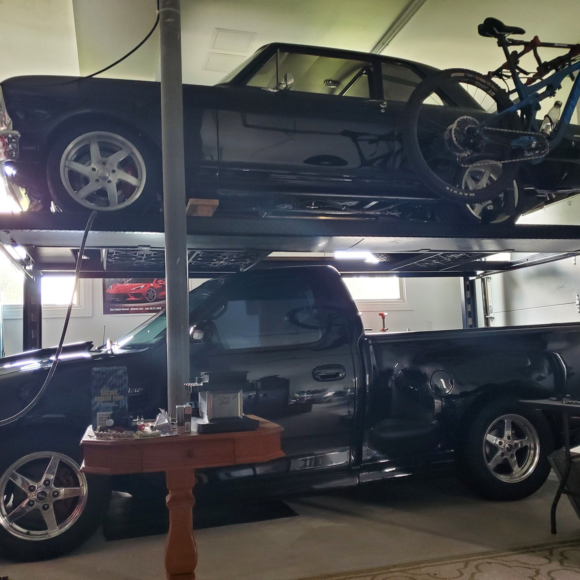

Oh man that is a slippery slope. Next thing you know, this happens. And your not sure which vehicle the Summit delivery is for!
Old Jul 15, 2021 | 08:41 PM
  #75
440_Stroker's Avatar
Joined: Jul 2020
Posts: 387
Likes: 173
Is there water in the bottle on your bike?
