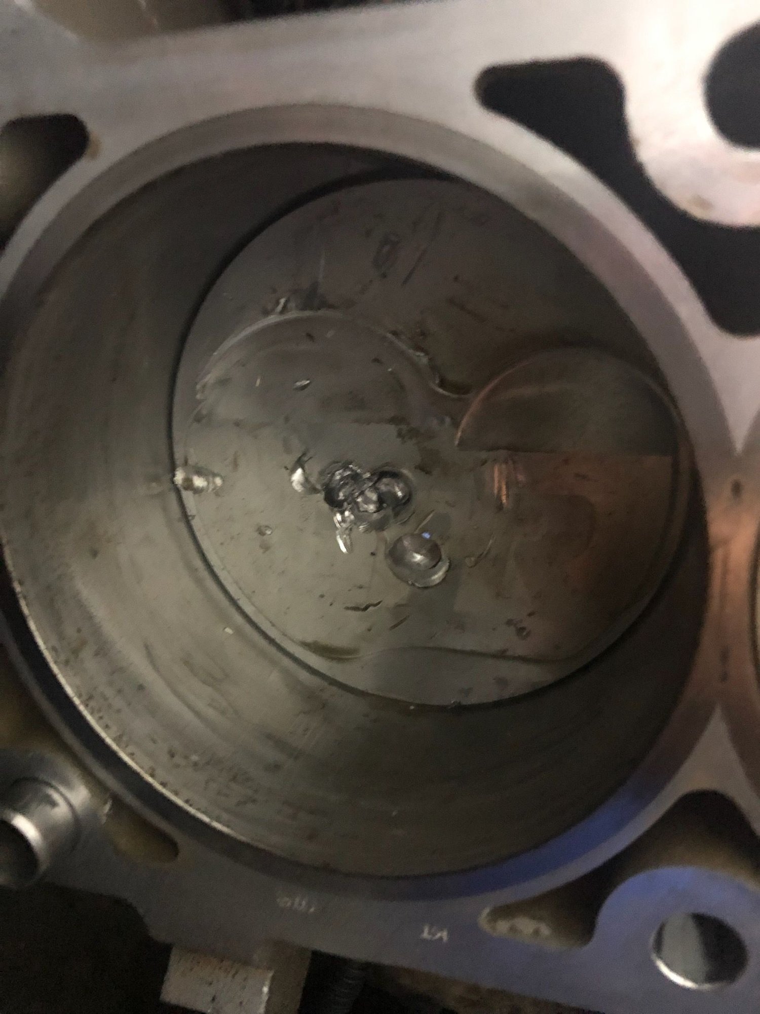

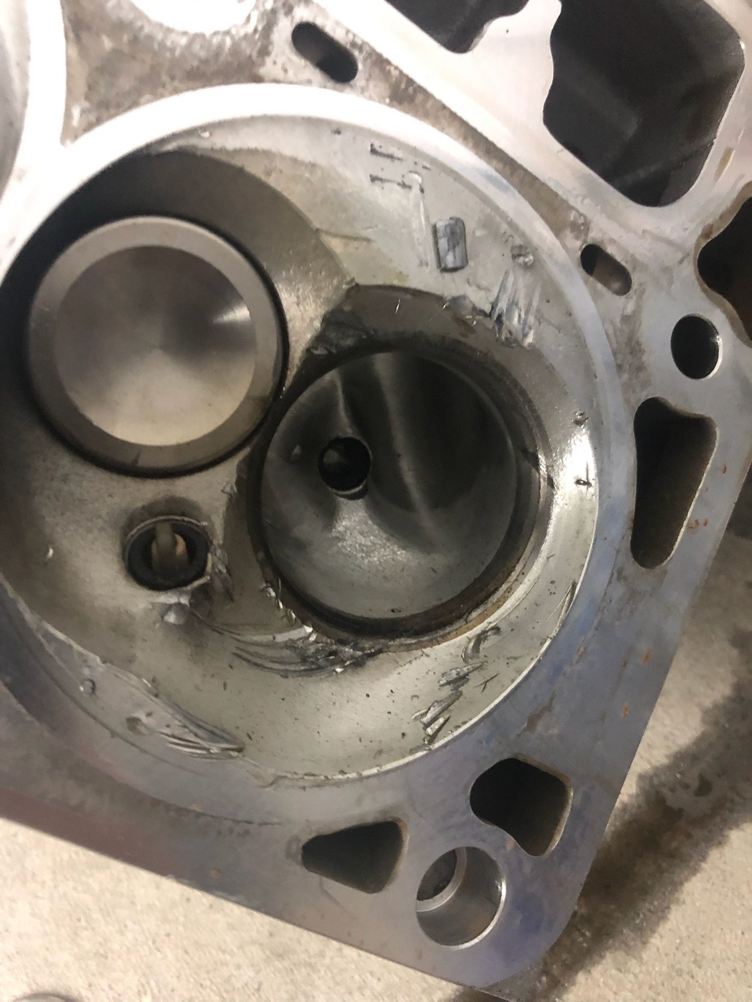

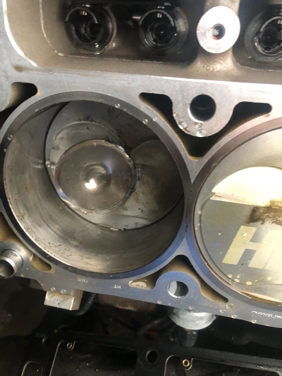

Truck just didn't sound right to me and that voice in my head told me to pull the valve cover for a look. I found this mess, just two 1/4 mile passes and it's all got to come apart again......grrrrr!!!

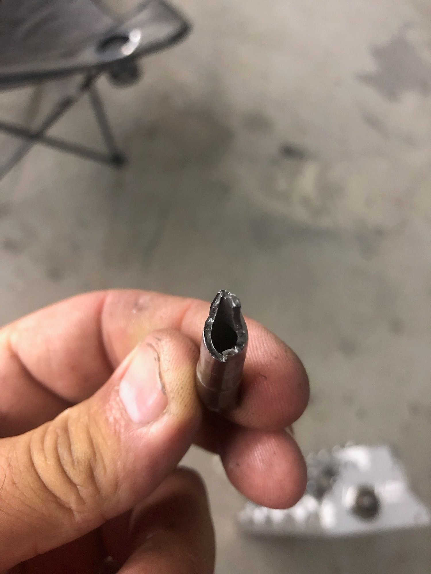

Ferrea hollow stem intake valve broke.

Oh snap…no pun intended sir. Spring break? Retainer?

No sir the valve just snapped. Only made 2 passes and never broke 7k.

I’ve been talking with Tony for 2 years about getting my heads back to him for intake valve upgrades, as I run the exact valves you are. I think this might persuade me to do just that. This sucks man! Cylinder wall ok?

I have to replace a sleeve and obviously a piston, repair the heads/replace all the valves.

Just curious, how much spring pressure were you running? A lot of the serious big boy solid roller set-ups I see just run solid valves and spring accordingly for the weight. Every set-up is different though, I probably would have built my combo same as yours. Hope it goes back together soon.

The hollow stem Ferrera intakes are a 98 gram hollow stem performance valve. No backstory really, as they are an upgrade to a solid stem intake because of weight. A big valve like this is heavy and hollow stems are common with a valve this size. I’ve ran the slop out of mine without issue. I’m likely going to go Ti intakes, which is an upgrade yet again, but very expensive, as they are bigger and heads have to e re-worked. First valve like this ive seen break a stem personally.
edit…meant to say first Ferrera valve like this (hollow stem) I’ve seen break a stem.
