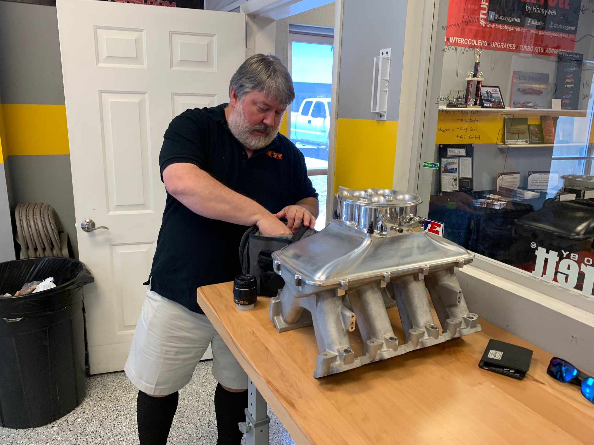

From: Chicago, IL
Check out what Danny Nicely was running in his C5 (4.8's in the 1/8th)
Cast MOZEZ tunnel ram modified by URE and 8500 Accufab.
jealous of the room to fit that. Fbodyproblems

We tested a 6500 for ***** and giggles...no way it was going to fit on a Vette but we wanted to see how much we were choking it off with a 102 tb

Mercy! Don't that be purty....
