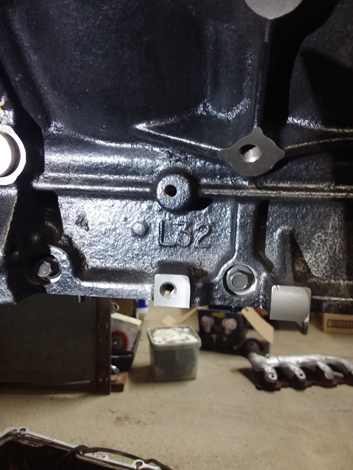

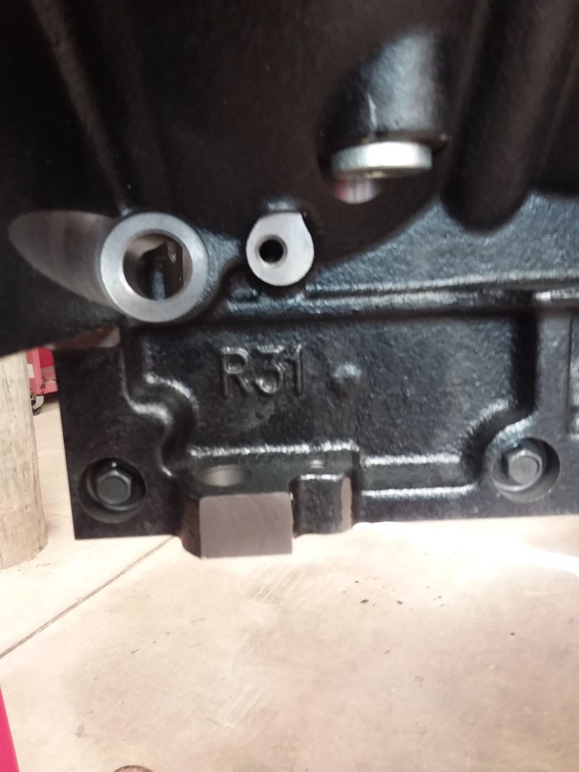

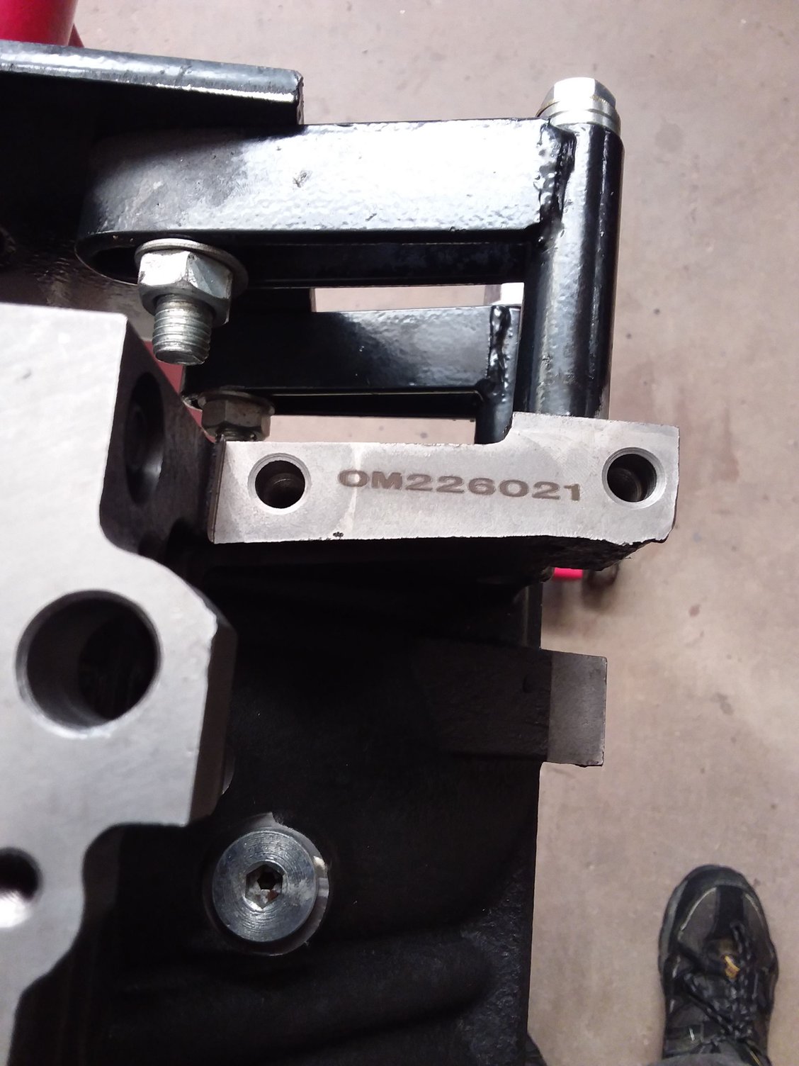

Not sure on the laser engraved numbers.
R31 ?
No engine number on this pad.

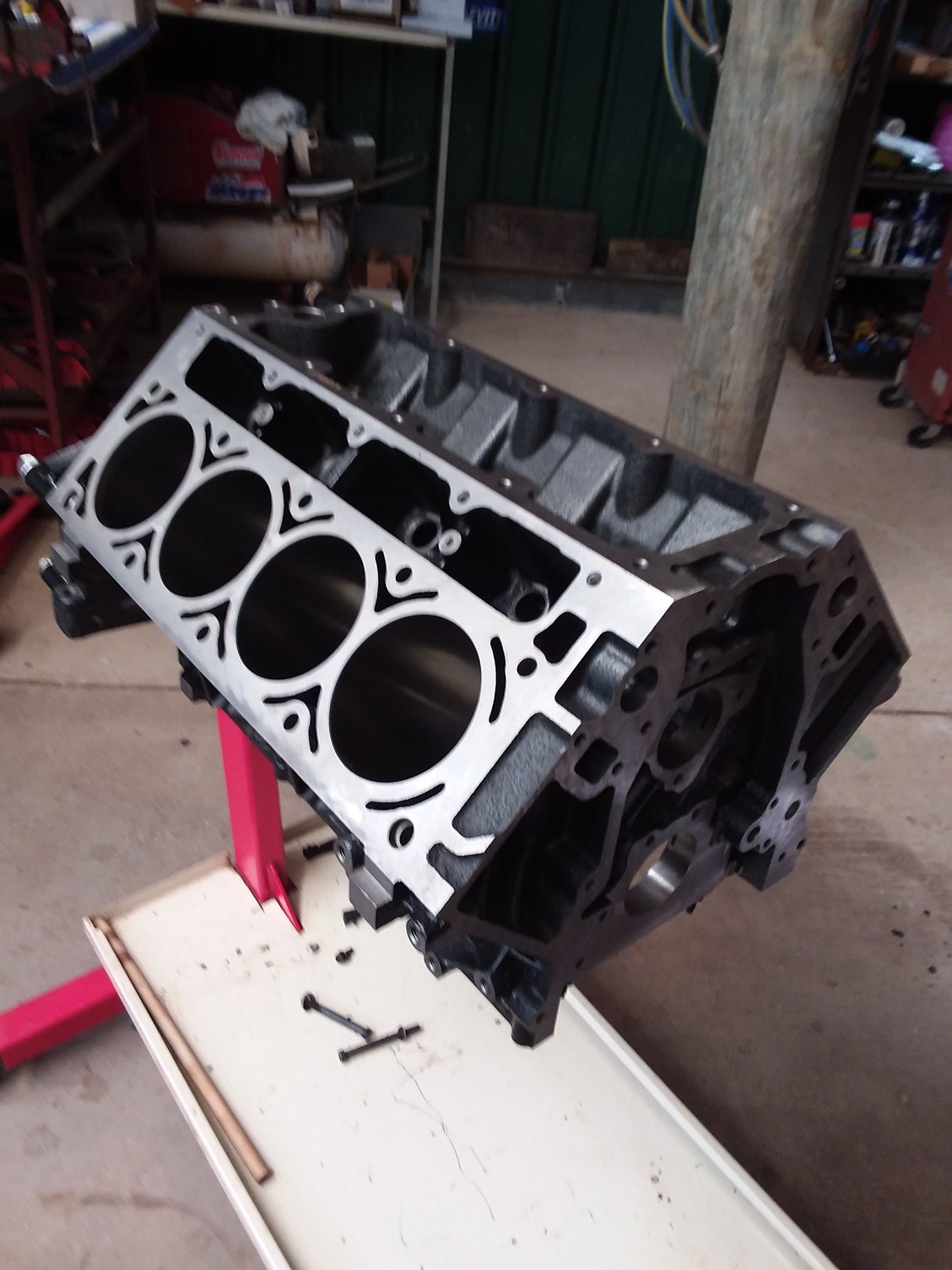

No 6.0 in the front right cyl?
This is the add from the seller here in Australia. Block has a 4.00 bore.

Look at the back cylinders
wow 2500 . what’s that in US currency?
AUD Australian dollars.
Ichecked the back of the block no numbers.
No numbers on pad

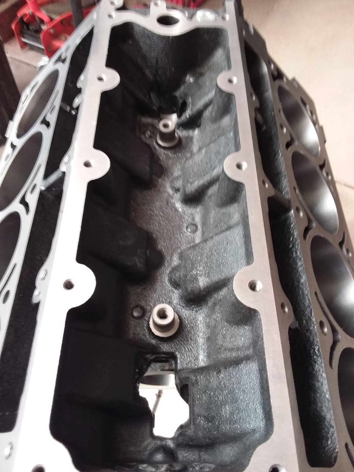

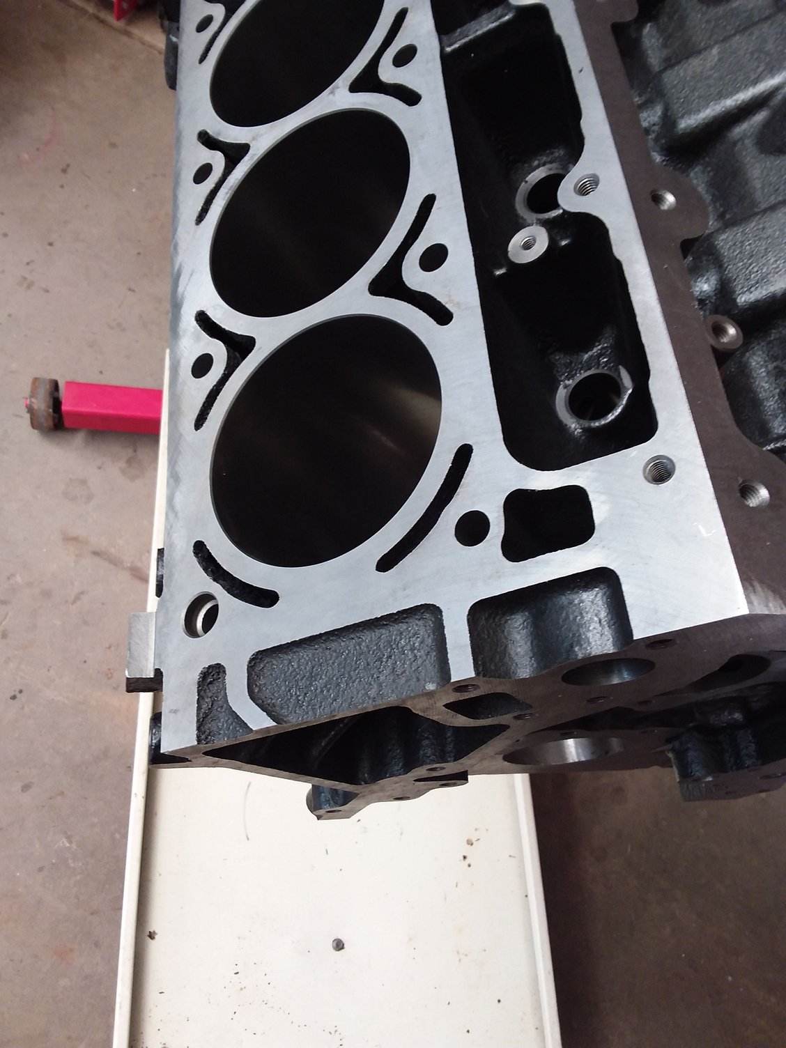

That is NOT a Gen IV block, as it has provisions for valley knock sensors. ALL Gen IV blocks have the DOD risers in the valley instead of the knock sensor mounts.
This is a Gen III block. Measure the bore to figure out which one.
what he said...
Thanks for the reply. Bore is 4.0
LQ4/9 truck block. Very common here, but I imagine not in Oz...
y not? Vans,1500 to 2500 trucks etc...
Not sure many of those were exported to or built in Oz.
