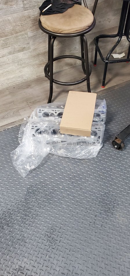

Picked these up from TEA last night. Dropped back off to Paris to cc them and see how much needs milled off. Engine should be on a stand this week for assembly according to the machine shop, so we will get one head there when the time comes to check PTV.
Still waiting on the gears to get back from Liberty still. They quoted 2 months, so hoping they are sticking true to that, but we are roughly at the 2 month mark now. So hoping he calls me in the next week saying they're back.

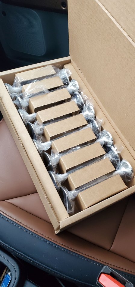

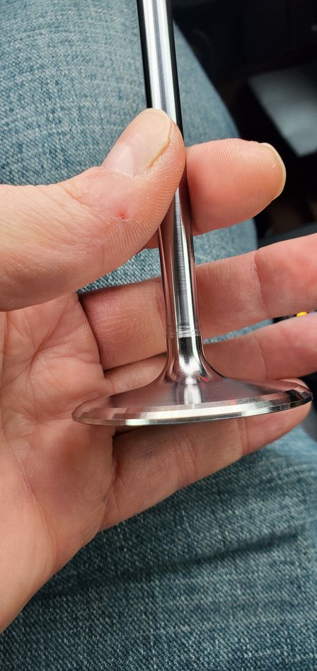

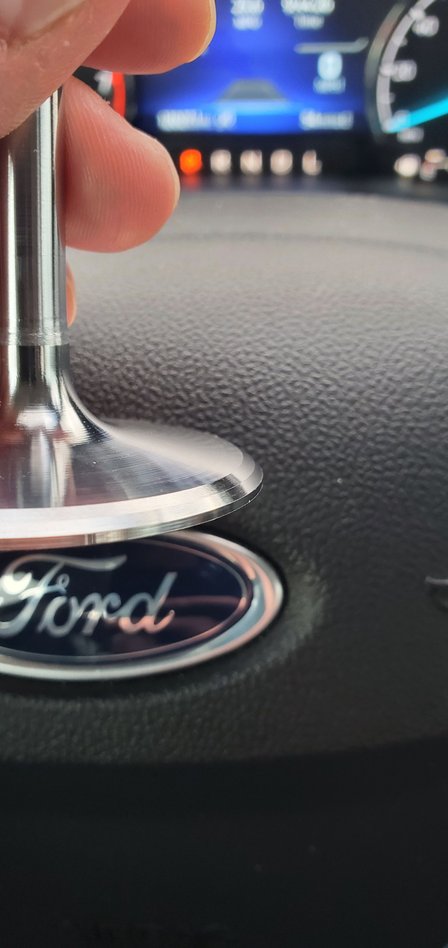

They are the 220s I had on the original motor. We sent them to TEA and had them do a 245 valve job on them with turned down LS3 valves (2.1/1.6) with the 50deg nitrous job.

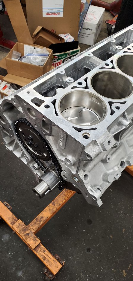

Stopped by the machine shop today and snapped some pics.. We're now at the point that I'm holding them up as they need a head to check ptv. So plan is for Paris to open the chambers on the 220s, and mill them to get the chamber volume we need for the compression, then take one to the shop to fit up.

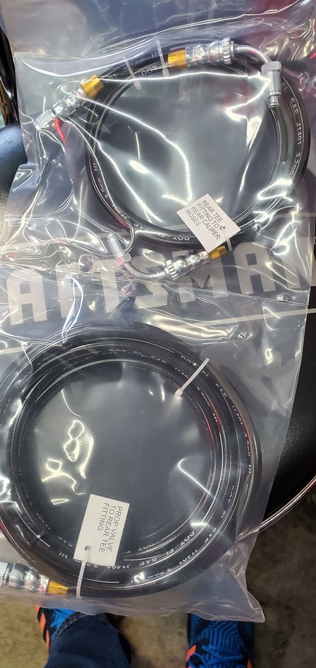

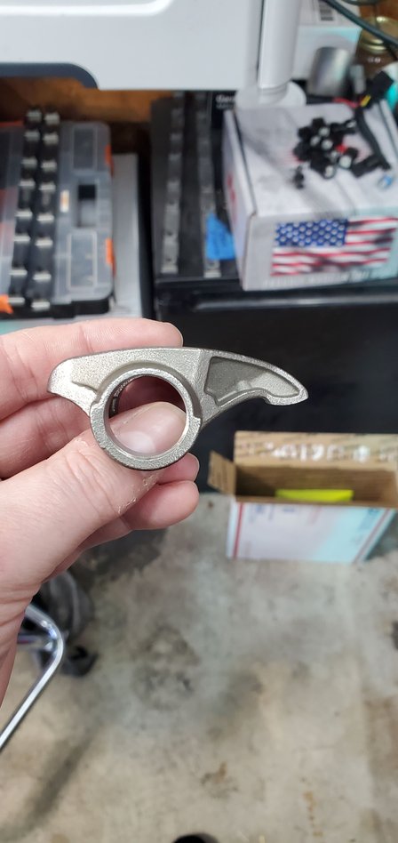

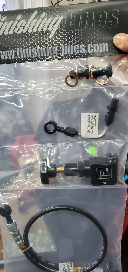

Got some goodies in the mail yesterday. I had removed the EBCM and ABS pump from the car months ago, so I finally got around to ordering the abs delete kit from Finishing Lines. I could have simply flared the existing lines and such, but this is an extremely well put together kit with the prop valve and install is simple with it.
Ordered Tooleys new stock rocker replacements as well. Sold the original rockers with the CHE kit installed and PRW pedestals for 350 shipped yesterday. So that works haha
