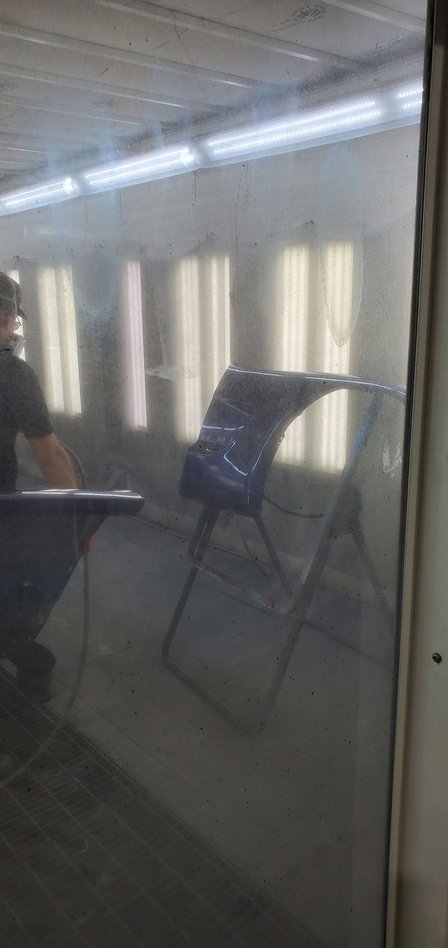

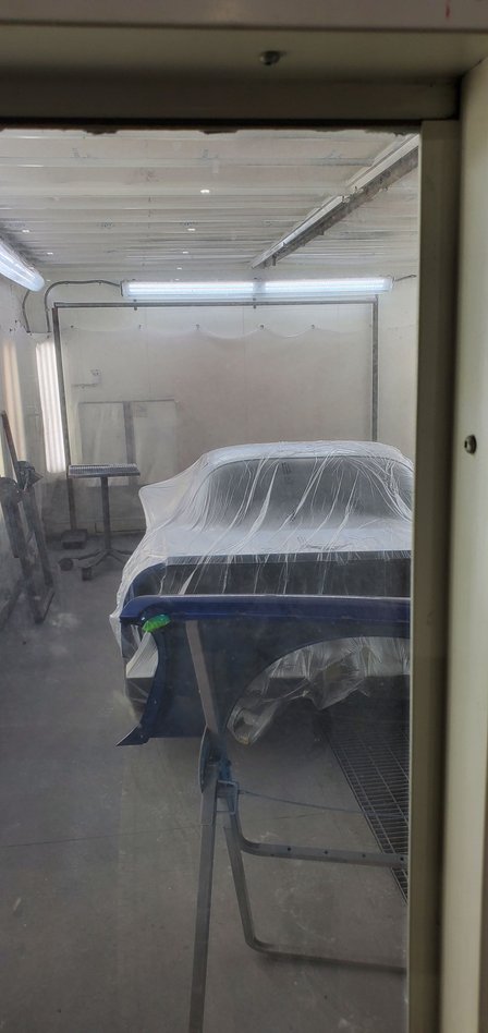

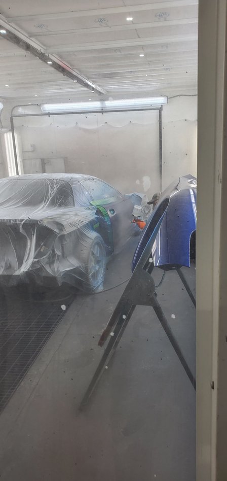

Old Nov 4, 2024 | 10:21 AM
  #151
02EBC5Z06's Avatar
Joined: Sep 2017
Posts: 758
Likes: 437
From: Massillon, OH
Getting some fresh paint laid down. Hoping to have it back real soon. Still needs a new windshield installed and then should be done at the shop.
