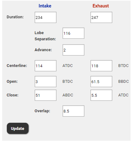

Using IVC at advertised duration it works out to a DCR of 8.55. Using IVC at .050" + 15* DCR is 9.7.
These low shock cam lobes have really long seat to seat duration numbers, but at .050 it is only a 234 intake lobe. At the seat it is 292* duration.

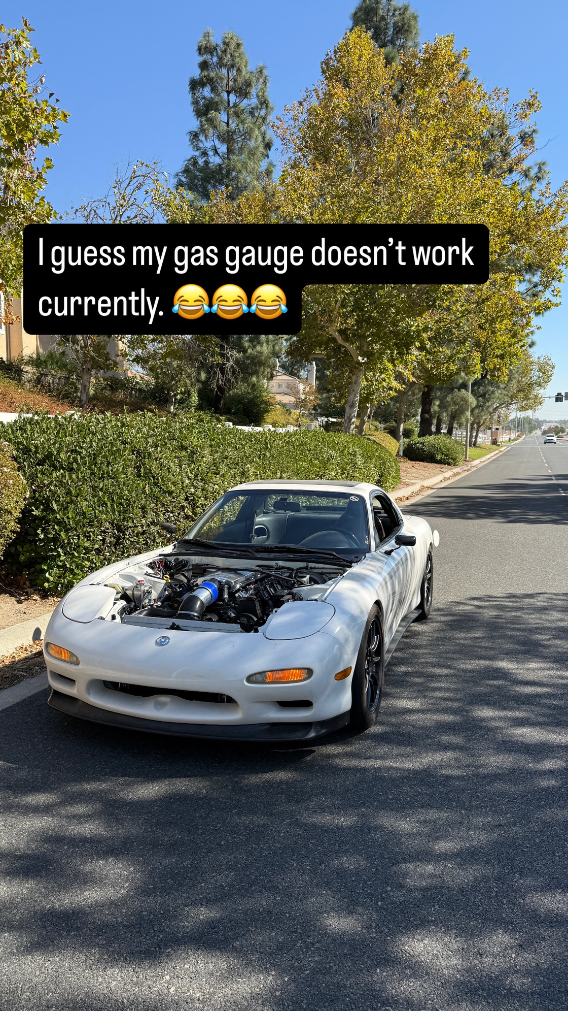

After I thought I had fixed my cam/crank sensor problems - I learned it would lose RPM sync every single time at 6800 so I had to keep testing it, and finally got it fixed after just starting fresh with new everything. I took it out to 7600 rpm on the run after that and boy it sounds good and is pulling hard still. I hope for it to put up a respectable number, but I'm most excited that I can floor it in 2nd at 2000 rpm and it will stay stuck all the way through the midrange and keep hauling *** past 7000 rpm. I can't wait to see the shape of the power curve.
I have break-in miles to go still on the clutch, trans and the rear gears so I can't beat on it for real yet.
I thought I had ran it out of gas, but really was the engine losing RPM signal a half mile from my parent's house haha.
