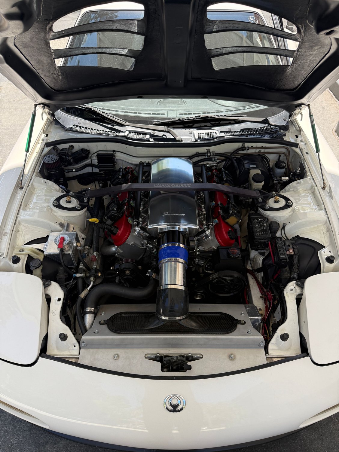

This thing is a beast! I made it out to Streets of Willow on Friday and the car kicked ***. It is ridiculously fast, and honestly very easy to drive. I'm very happy with the setup. I could not be happier with the engine. It is tractable and has torque everywhere, and it just keeps pulling harder.

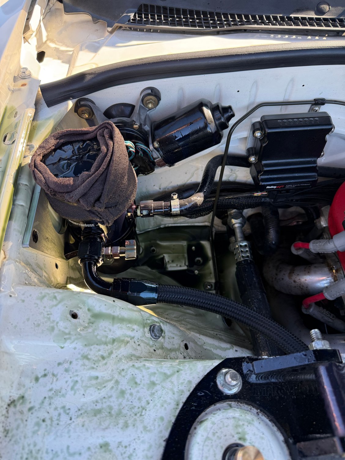

Only minor issue is dealing with oil control problems. Really wish I could fit a dry sump in this thing. I keep pushing oil out the catch can the faster I drive it. I have more parts coming for another revision of my crank vent and catch can. I should have stopped sooner as I knew it was puking, but I was having too much fun lol. It finally pumped it into the intake and started majorly smoking out the exhaust.
Here is the latest engine bay after swapping to BTR valve covers (the baffles still aren't enough).
There were multiple photographers out there and they all shared their pics for free. So awesome.
The aftermath of my last session. A little rust prevention lol. The rag never stood a chance.

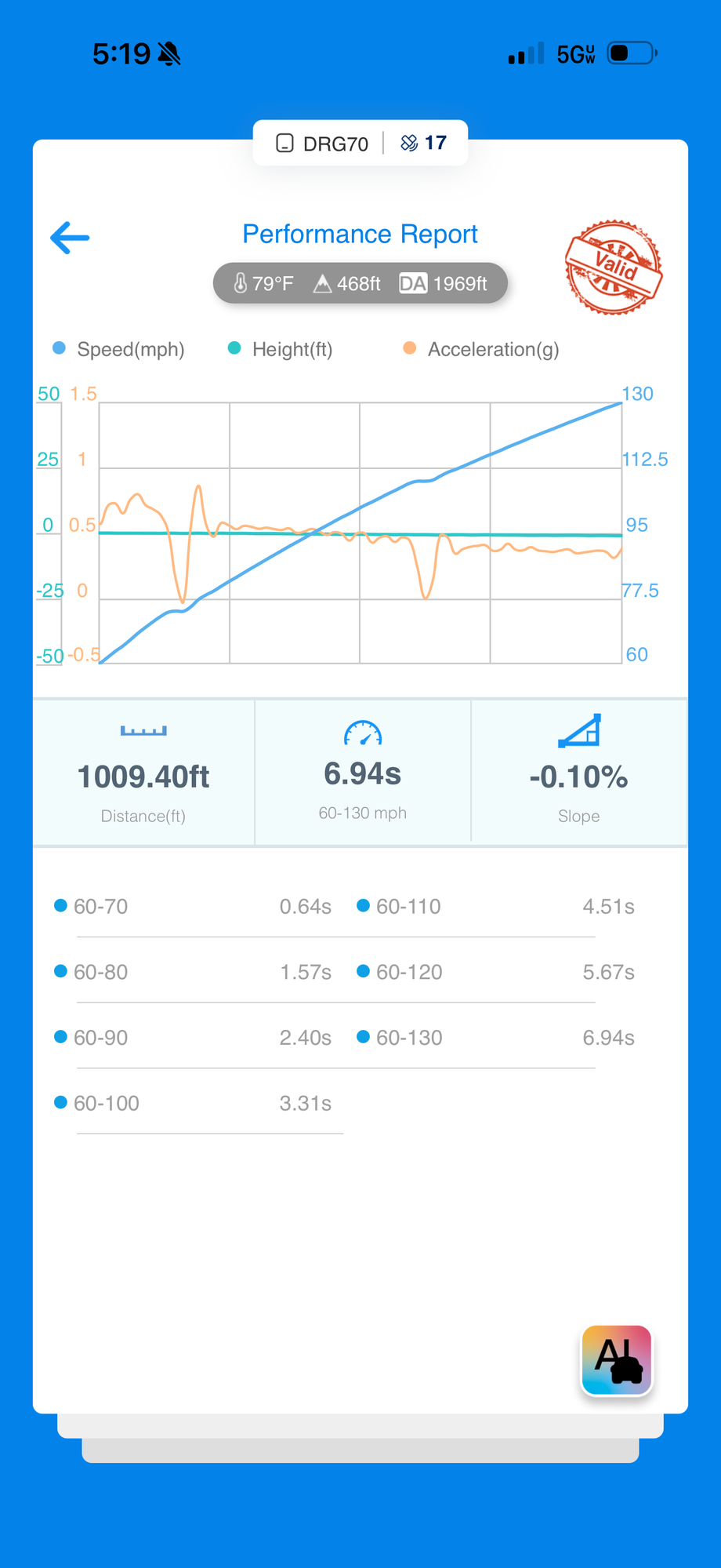

Well that was a successful outing! Not a new passion by any means, but it was for sure a fun time. I am way more looking forward to the next track day haha.
We started the day hitting some high 150's, and then I took a datalog and dug into the tune. My tuner left me a little soft on timing, especially with the E70 I had in it. I threw 4 more degrees at it and picked up a chunk of mph. My best two runs were 161.5 and 163.28.
Weather was about 80 degrees, 2350 feet of DA, and a ~6-8mph headwind estimated. The airstrip is at 424' of physical elevation.
60-130 was a little bit of a letdown for me to be honest. I ran a 7.1 when I first put the car together on a bumpy road with a turn in it, going uphill at 1200 feet of physical elevation while starting in 3rd gear. My best runs were a 6.97 and a 6.94, and my dad ran a 7.00 backing mine up. I really thought the car had more like a 6.5 in it with this much power.
Flip side to that argument, you can see in the video I basically spun all of 2nd gear even with the Nittos, so maybe 3rd gear start would've actually produced a better time - cut out one shift, and for sure no spin. If I were serious about the 1/2 mile stuff I'd have to bite the bullet and get a Mickey on the car. The ET Street R's seem a lot stickier from what I saw out there.
The run on video was my 163 mph run and I feel like I truly got everything out of the car that I could have that day including hitting 5th just right. Even though I wanted a little better number, I got close to my 165 expectation, and I felt I left nothing on the table which made me feel good.
A couple comparisons, a brand new ZO6 with CAI and an exhaust ran 153 mph.
A 605whp c6z with Mickeys and skinnies up front and some weight reduction also ran a 163mph run as his best pass.
I've been having a nagging feeling that the engine has lost some performance from when I first put it together. The last few runs of the day ran slower by ~3-4mph too for no apparent reason, so that isn't helping lol. We had to do a quick and dirty plug wire repair when the conductor pulled out of the wire, so maybe the repair started failing. I'll do a leakdown when I change the plug wires out, but I'll probably just keep thrashing it until it gives me a more obvious reason to be concerned. For now it is giving me everything I need to have a blast, and is standing up to some pure torture.
