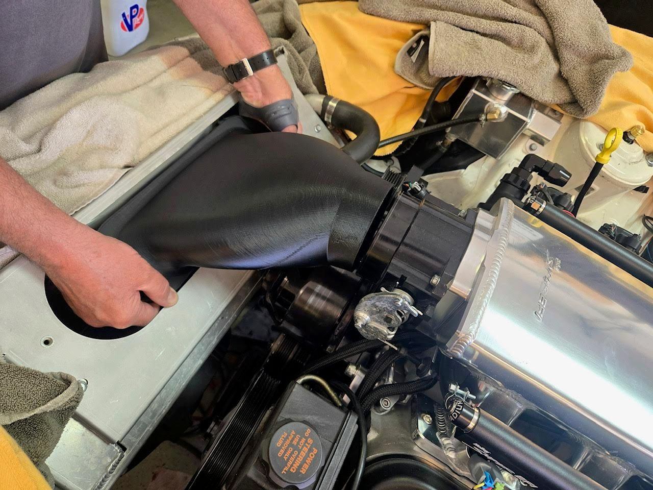

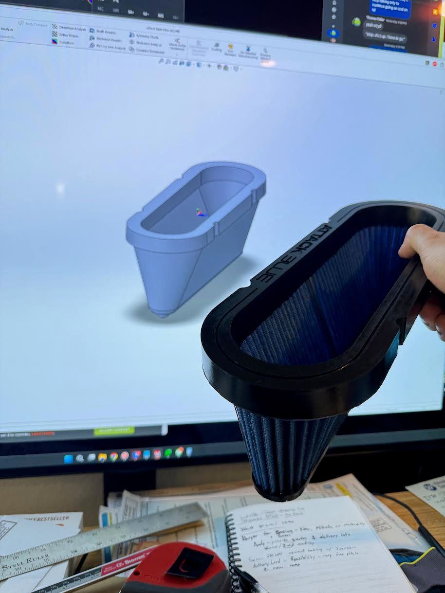

The intake tract I got something planned with my buddy when I finalize on intake manifold choice. Love/hate with the sheet metal intake. It makes SO MUCH DAMN NOISE it is the loudest thing on the car. You can hear it over the exhaust. It amplifies noise like a speaker box. I've used my strut brace to dampen it some, but it is still makes a very unappealing noise.
I'm considering the BTR Trinity if the Holley intake performs like I want. The Trinity should just barely fit, but I will lose my strut tower brace. Other option is an MSD, but I honestly don't want the added torque, the fitment is really tough in this engine bay, I'd have to redo my throttle cable, I don't think my TB and water pump can co-exist, and the cost of a ported and modded MSD is more than I want to spend lol. A few things against it.

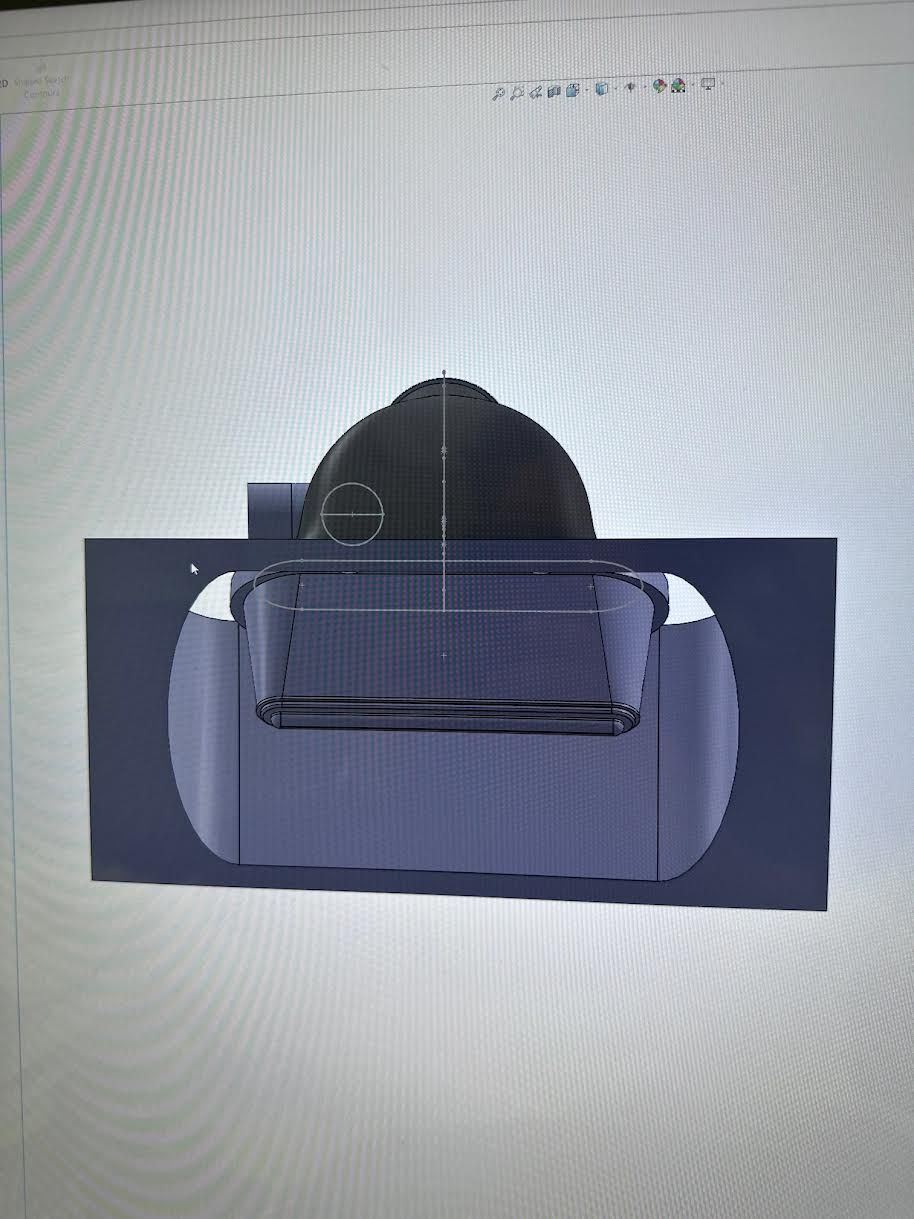

A better intake duct like this has been in the plans for many years with my friend from engineering school. He works with composites so when we finalize this it'll either get a mold made, or overlay in carbon. If I swap intakes we'll need to tweak the design a bit so it is on the backburner until then.

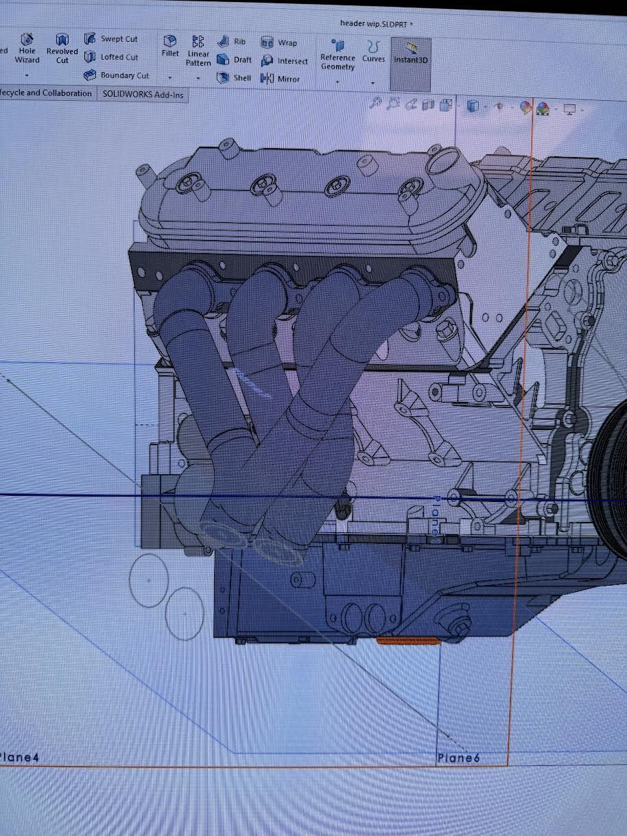

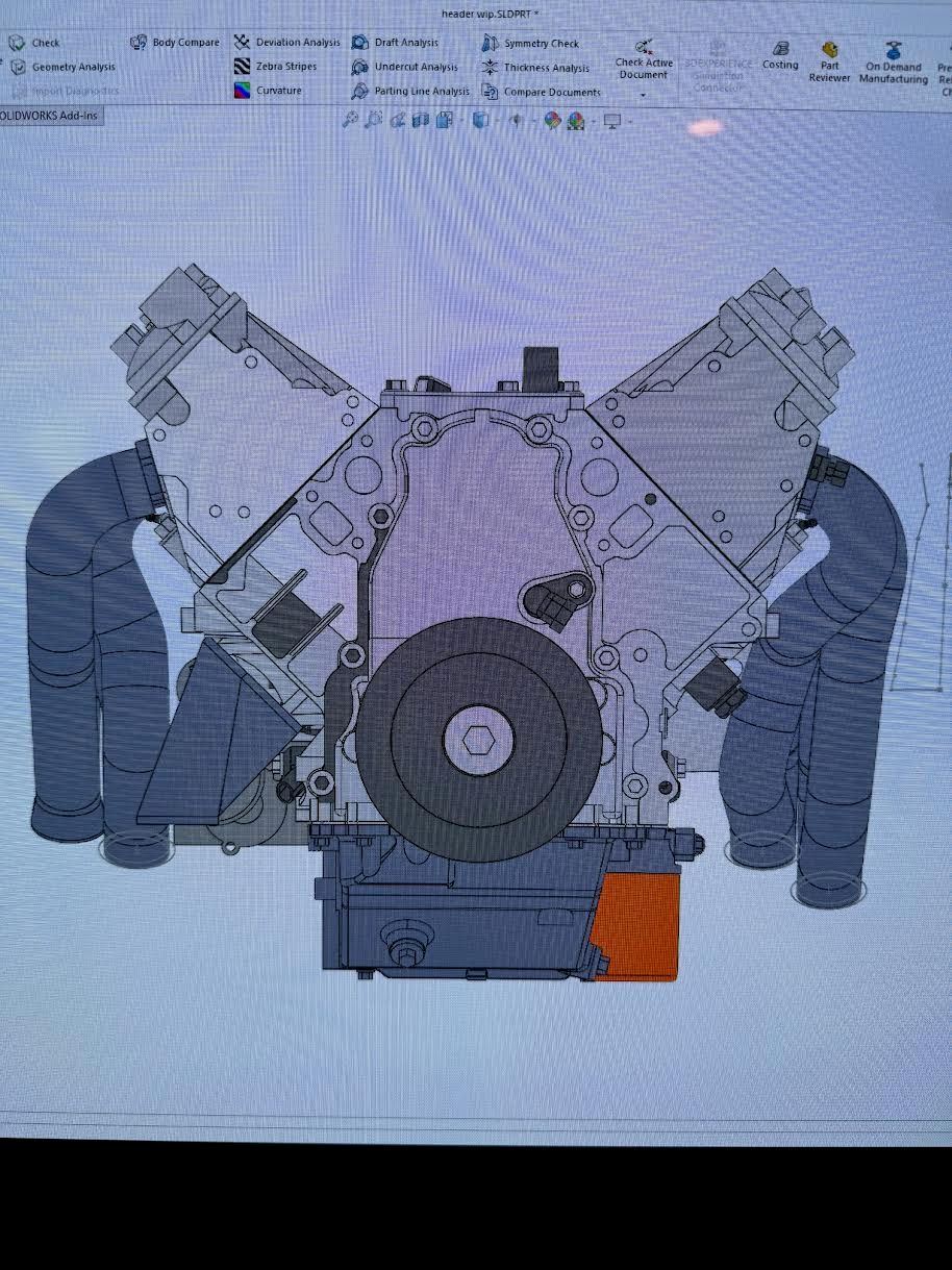

I also spent some time teaching myself how to design headers in Solidworks haha. I have the "best" available headers for the FD swap with these 1 7/8" headers with a merge collector spike. They're ok. Nothing special, nothing bad. These are 2" primary tri-y with somewhat equalish length primaries. I took some very rough measurements in the car just to give myself some major keep-out zones. I've always been told that 2" primaries would not fit and I'm just not believing it to be true haha. I will be getting a 3d printer at some point, and printing some header primaries to test fit sounds like a fun project. I stopped messing around with this when it started getting serious enough that I truly needed to know how I was doing with clearance. My plan would be to use craftcloud to 3d print the merges in stainless, and weld in the simple tubes and bends in between.

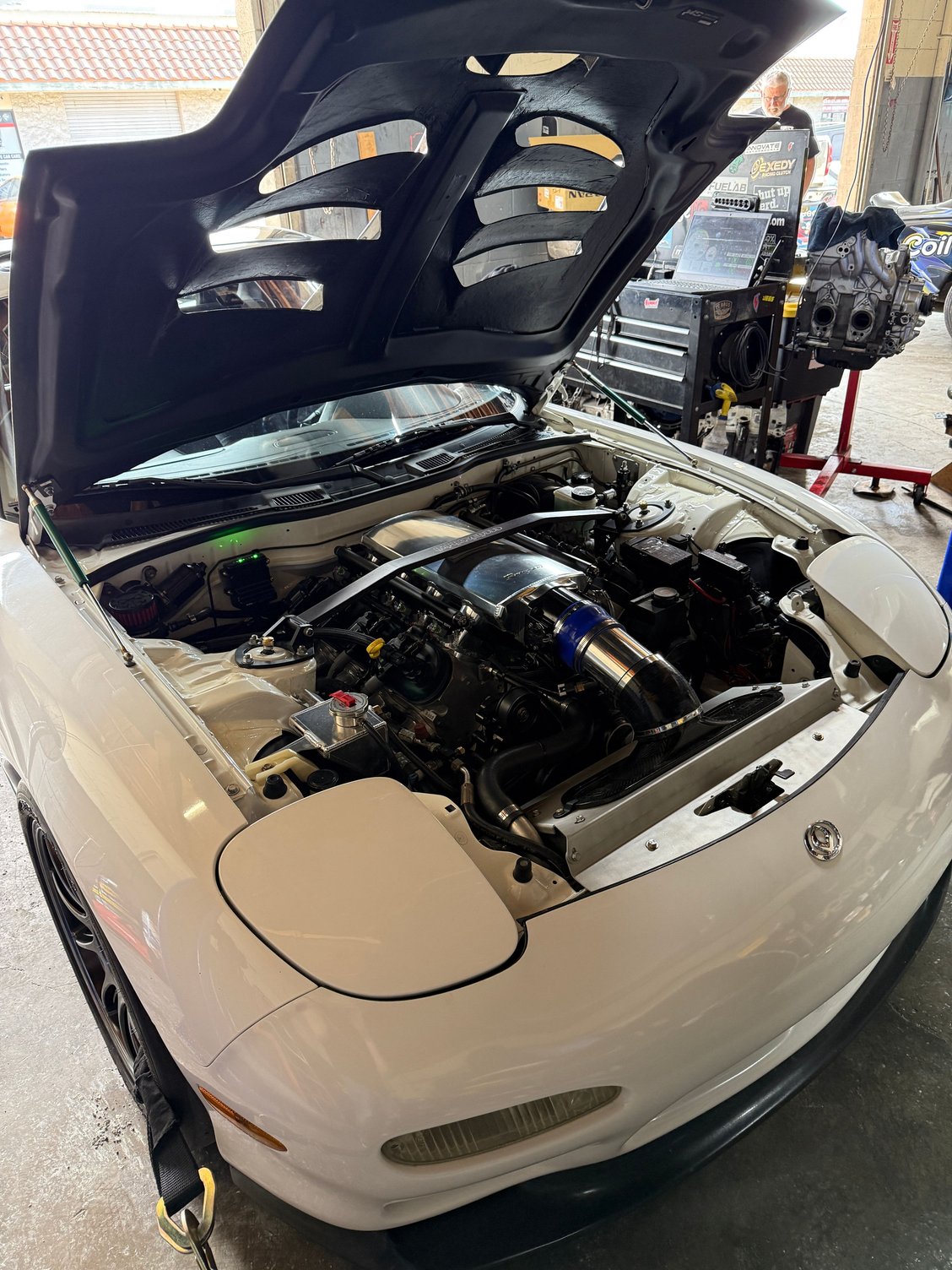

I finally gave in and got an aftermarket hood for my car. I don't prefer it vs stock, but I do need the hood vents, and my car is in relatively nice shape I don't want to hack up the factory hood webbing (and still might not fit the intake I want to run). I saw a twin turbo build very recently using my same hood (VIS scoot style hood) that fit the BTR Trinity, but only with the downward angled flange. I was very surprised I did not know it would fit. BTR said they could build me either versions still. I keep trying to look around on 2nd hand market and it is very slim out there.
If all this intake, hood etc becomes my long term solution I'm going to paint it white. It becomes a lot more subtle when paint matched.
This gains at least an inch of hood clearance.

I had to cut a fair amount of hood webbing to get the LSXR to clear in my Miata. No way an MSD would clear.
I totally understand not wanting to butcher an FD hood …. NA Miatas are not that special.

The one I am working on also has a aftermarket hood and it still doesn't clear. The only thing with the downward angle manifold is it would no allow you to run that radiator/intake setup. Or atleast, not easily.

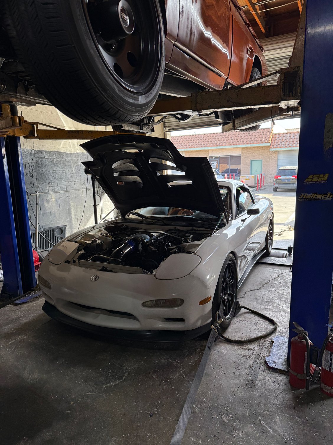

My buddy owns a rotary shop and a dyno. I'm working on setting a date with him to get some numbers and see what this torque curve looks like.
Rolling into it I've spun all through 2nd gear on 275 wide slicks. A shame the low pro intake killed all the torque.

I had a fun day at the dyno yesterday! And then I got popped for a very bad speeding ticket on my first drive home with the car in ~3 years. Oh the highs and lows lol. A few seconds in third gear was all it took. Welcome home
I'll post up a dyno results thread but just wanted to close the loop here. I'm ecstatic with the car. The power figure it put up is shocking. First pull was over 600whp SAE on 91 octane. The shop owner's rotary FD did 655whp on a local dynojet, and 650whp on his dynocom. Even if it is not real (the car is very fast...) I'm thrilled with the shape of the curve. I have over a decade of experience with this platform and LS swaps, and the journey I have been on to get a proper sports car power curve in this mazda has been trying. Intake manifolds are very tough to fit, which led me to running a stock LS3 intake on my last combo (rod modded, larger TB all that jazz), but you simply cannot fight against the long intake runners.
It peaked power at ~7000 rpm and holds flat to 7500 and will pull to 7800 without even beginning to show signs of running out of breath. With a 234 intake lobe and a super smooth idle. The thing is a rocket ship. I bought a dragy so I'll be able to verify performance figures when I'm not worried about losing my license lol. With only what I've seen from C6Z results, I was hoping to achieve a 6.5 second 60-130. With low 600's wheel if it isn't pushing toward a 5.9 I'll tear up the dyno sheets I will have two shifts in a 60-130 so that may be sub optimal. I think it'll be obvious real quick though if its making the power or not.
